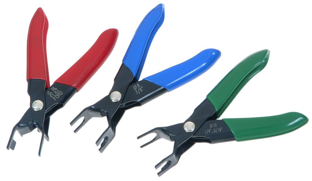

At some stage I'll need to "GO IN" and get the tank out of the way so will have to disconnect the fuel pipe.
Rather than struggle  and snap the red spigot off, I thought I'd shell out and get the proper tool
I think this is the right thing but do I need the 8mm blue or the 10mm green version
Cheers

Go here for example http://www.amazon.com/Supercrazy-Fuel-Disconnect-Plier-SF0077/dp/B00IY986JQ
I have the Breva 1100, but I think the Quick Disconnect is common across the MG range
Whether they'll work - I'm not sure yet, but they're not a lot of money and if they stop you struggling then you're likely improve the odds of not busting the red spigot off is my assessment!

Tools aren't needed.  Just make sure the system is depressurized and the collar is free moving.  (it doesn't move much). Pull the collar back while pushing the female fuel line connector forward, wiggle a bit and pull the female connector back and off.  This does not reqire strength.  It does require a bit of finesse.

I realise that Hugh - but thanks
Its just that my observation is that a lot of guys have tried to do it by hand and succeeded in snapping the darn thing off.
If these pliers make it easier then that's all for the good IMO
I think I'll have to get the set of 3 anyway so the original size question becomes irrelevant I suppose

The green one is the one for the Breva, very easy to use.  cost about 8 of the queens pounds from memory
Thanks Wits - exactly what I wanted to know  :thumb:

Had to buy the set of 3 for ...... wait for it ..... £4.20 including postage  :shocked:
Lets hope they're not made of cheese when they get here - but hopefully I wont be using them too much to worry  :wink:
