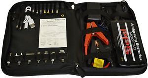

I have the Antigravity PPS and I bring it every trip, even in the car. It has a lot of connections for charging accessories. It also has a built in flashlight (good light) and the light can blink and strobe. I've used it to charge my computer, phone, gps, camera. I used it to start my daughters Ford Escape when her battery died... started right up first crank. I plug it into the Stelvio's under seat 12v socket while riding.
