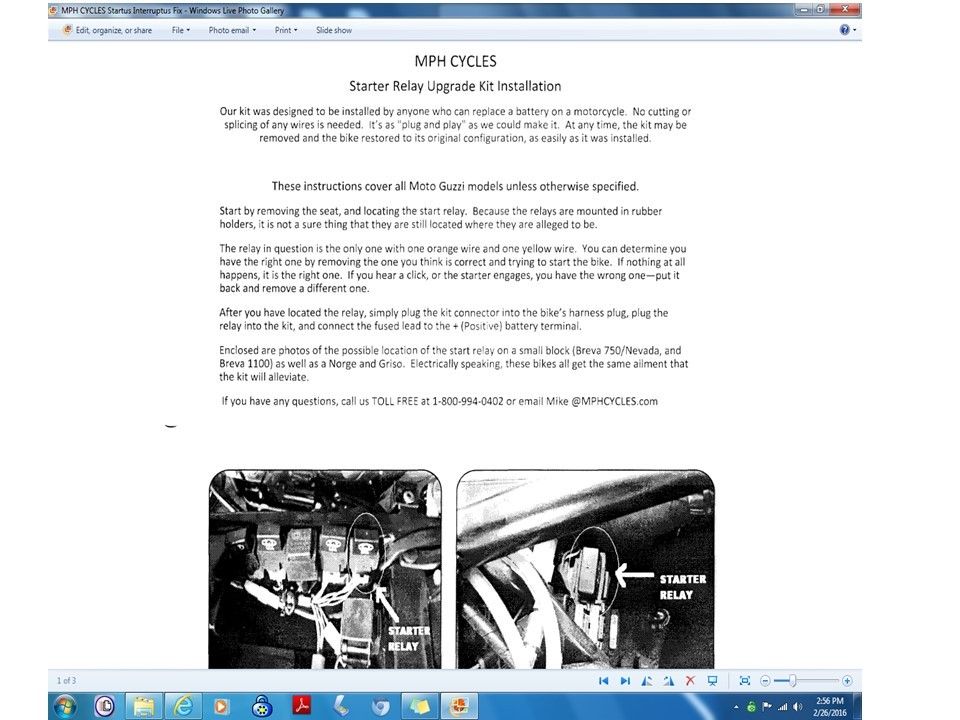

The '07 Breva, is that just a naked Norge, my Norge is an '07 and 92,000 k, see "wire wheel Norge " post. Please tell of the startus interruptus mod, I'm interested.
Offline Kev m
  • Posts: 31144
Re: 2007 Breva 1100
« Reply #7 on: February 26, 2016, 01:20:50 PM »
Guzzi doesn't seem to like to learn lessons well.
I'm told that for decades they've run the power for the starter relay through the ignition switch. Such a set-up works fine for a while (especially when all the components are new) but will eventually lead to intermittent failure of the starter relay (located under the seat on the CARC) to fully close. When this occurs it won't power the starter solenoid and the motor won't crank.
The Starter Interruptus fix installs a direct fused power supply from the battery to the hot terminal of the starter relay.
It's pretty simple. I wrote up a thread years ago when it first happened to my B11. AFAIK it never happened again all these years later.
Offline ITSec
  • Posts: 3040
  • Location: Southwestern US
Re: 2007 Breva 1100
« Reply #8 on: February 26, 2016, 01:34:24 PM »
As Kevin mentioned, this is a chronic issue with both large and small block bikes. Search the board a bit, and you'll find several threads with descriptions of how to wire in a relay and fused connection to improve power to the starter, as well as links to a kit available that just plugs in if you don't want to wire it yourself.

What is appropriate size fuse for the starter relay ?
Re: 2007 Breva 1100
« Reply #11 on: February 26, 2016, 02:09:48 PM »
I found a scanned copy of Todd's installation instructions.  Hope it's legible on your computer, since it's been converted into a JPEG by blowing up and copying a screen capture, pasting to Powerpoint, and saving as JPEG file.
Either doing Kev's home rolled fix or the MPH kit, it's a no-brainer.  My 1200 2v Sport had started the 'interruptus' thing.  With the kit, not a second thought about whether the starter will crank.
Not quite correct, Kevin.  The starter relay works fine, but the current that is sent to the solenoid (through the starter motor relay contacts) is limited by the tortuous path from the battery through the keyswitch and back down to the starter relay.  The mod bypasses this long route with a direct path from the battery to the starter relay contacts.
Offline Kev m
  • Posts: 31144
Re: 2007 Breva 1100
« Reply #14 on: February 26, 2016, 08:12:11 PM »
Ahhhh yes, so the clicking under the seat without the solenoid engaging is the starter relay closing but the power passed by the starter relay is insufficient to pull the solenoid in and throw the big switch to power the starter. Yes?
Offline Kiwi Dave
  • Posts: 1421
    • Guzzi Gander Ltd
Re: 2007 Breva 1100
« Reply #15 on: February 27, 2016, 12:26:43 AM »
Yep!
