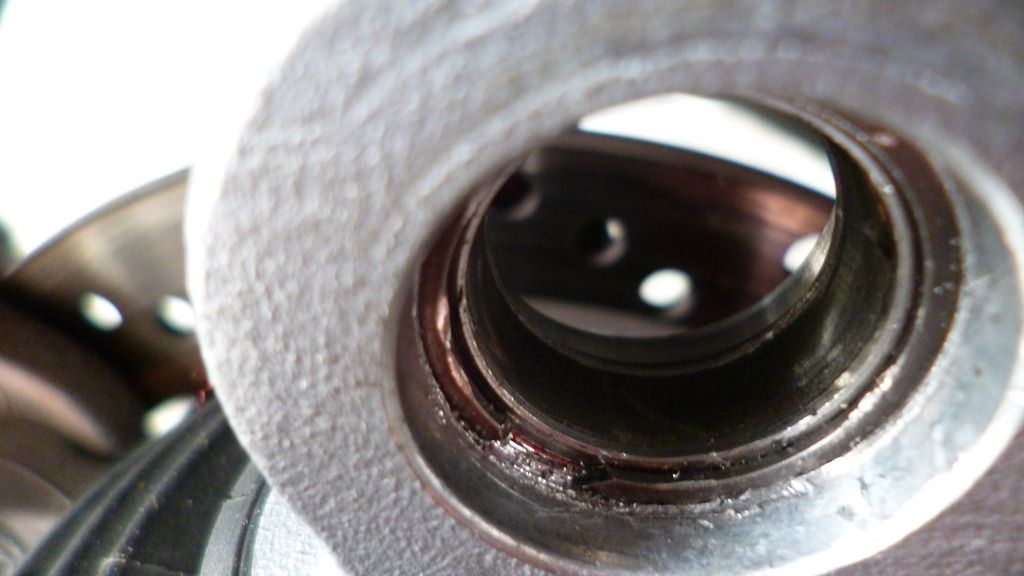

Here's a photograph I took with my mobile.
you can see the ends of the snap ring at the bottom at about 7 o'clock.  It spins around when I try to pry something under the end to lift it out of the grove.  Tough to get two very thin instruments in to hold one end while I work on the other.  Diameter is around 26mm.

It's out!  I managed to pry the snap rings out using a bit of brute force.  The remainder of the bearing was relatively easy to draw out with a couple of appropriately sized sockets and some threaded rod.
Can anyone tell me why I shouldn't use normal internal circlips in their place?  Obviously, they will intrude into the internal space a little more than the snap rings, but I believe as long as I don't intrude any more than 16mm (the diameter of shoulder on the tophats that mount on both sides of the self-aligning bearing), then everything will be sweet.

I use mechanic's picks. One to keep the bugger stationary and another to finagle under the other edge. The little curvy twisty one usually works for me.
I used pick tools as well.  The trick is to approach as you describe.  When you lift the snap ring, you need a third hand to slip another pick tool under it, so it don't go back in.  Since I didn't have a third hand, I managed to to transfer both pick tools to one hand, and use the other hand to perform the operation that the third hand was required.
