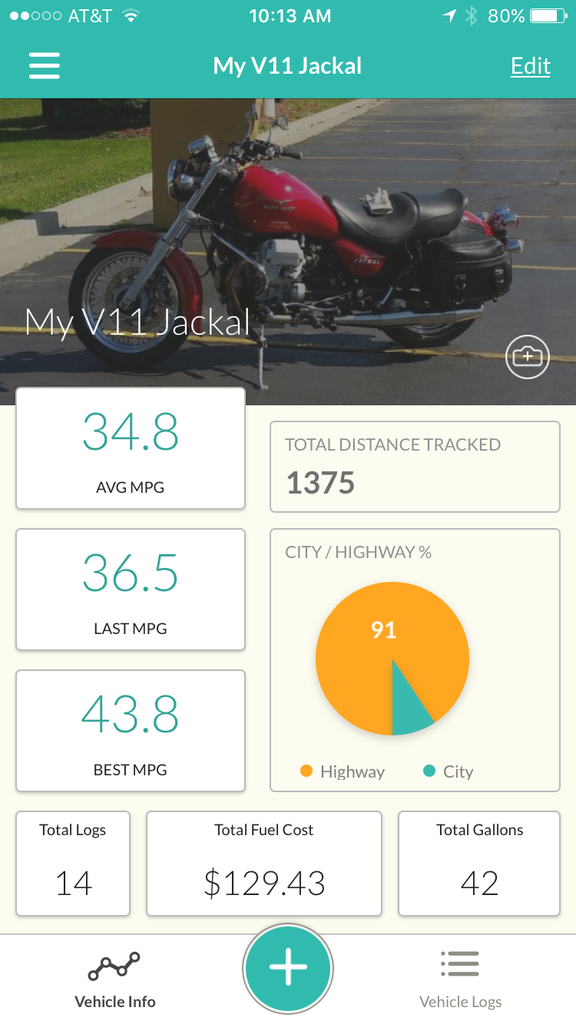

« Reply #9 on: March 10, 2016, 09:22:02 AM »
slight veer...but relevant. This app is called Fuelly. You can track as many vehicles as you like. I've always remained vaguely aware of mileage etc but with this being so simple, just input the stats on your phone while you're filling up, it makes it stunningly apparent what's impacting consumption.
This is a screen shot of my phone this morning. Cool app, and would serve to research this type of issue on your bike. Not sure if it was free or not, but if it cost anything it wasn't more than a buck or two or I wouldn't own it (Guzzi content)
