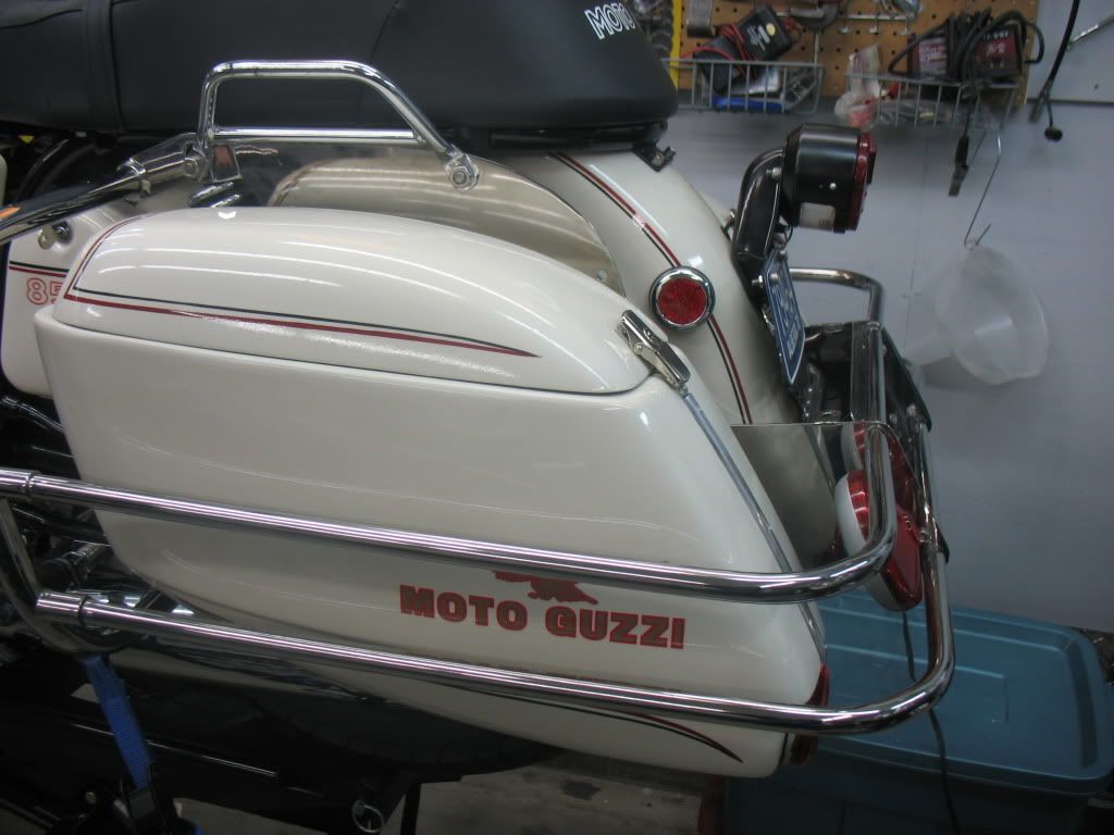

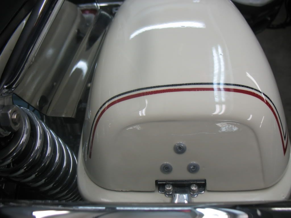

I drilled out the rivets on my Wixoms and then polished the aluminum trim strips. Mark which strip is L and R and front and back, I didn't and ended up riveting them back on incorrectly, slightly different fit, hardly noticeable but one day I will pull them off and mount them correctly.
The surface finish is pebbled, I sanded the gel coat smooth before I painted mine.
I found weather strip at ab automotive auto body supply shop and riveted on new weather-stripping.
The lights are available from automotive supply shops, standard truck / trailer lights
I also drilled out the hinge and lock rivets, painted the insides of the lids and cases with black truck bed liner paint, painted the outsides then re secured everything with aluminum rivets.
Cheers
Jim
I stripped the locks and had the re-chromed

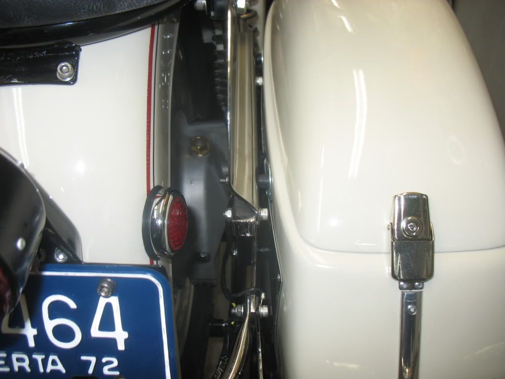

« Reply #8 on: March 24, 2016, 01:06:40 PM »
Just to close the loop on this (pardon the pun), here is a picture of the hinges (correction: latches) on the bags now:
Cheers,
Shaun

« Reply #10 on: March 24, 2016, 02:54:58 PM »
Took a picture of the stainless latches from McMaster Carr...
