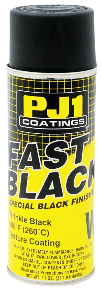

Probably going against common wisdom but in my experience I do not try to remove all paint but scuff the paint surface to promote adhesion.  old paint that does not remove easily is a great pre-coat.
For engines I have had great success using one of the major brand wrinkle finish paints.  The theory is that the high temp wrinkle finish increases the surface area and promotes cooling.  I find it to be a *very* durable finish.  On some engines I have had great cosmetic effect by sanding the fin edges to expose aluminum creating contrast to the painted color.

I have seen the high temp wrinkle coatings in red, blue, green and black which could open up some interesting possibilities for custom looks.
