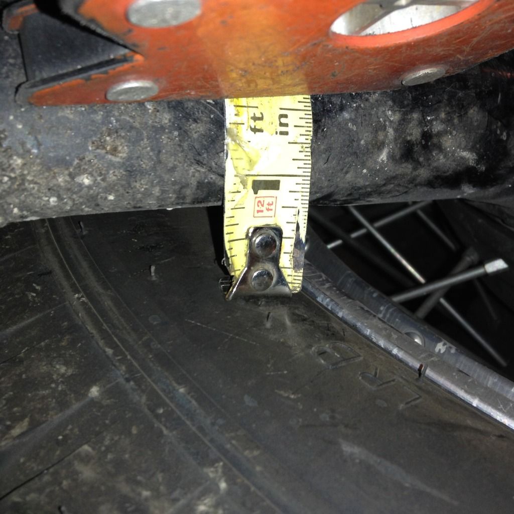

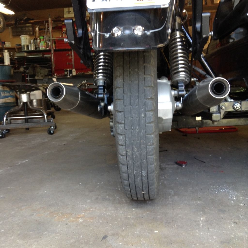

« Reply #13 on: April 01, 2016, 08:22:43 PM »
This is a 400/425-17 car tire mounted on a stock Bassa wheel. 3/4" clearance so next time I'll try a 450-17 or maybe a 550
« Last Edit: April 02, 2016, 08:09:13 AM by John A »
Neat, yes there is plenty of room for a larger (wider) tire back there...  I did go with the Shinko but let us know how the wear is on the tire that you installed.
I wonder about squirm if the tread is too tall in the pattern.
The design does make sense too.
