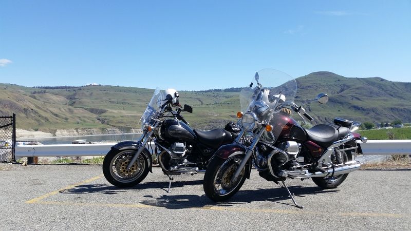

Obligatory bike pic. My 97 EV and Pete's 03 Cali EV. Wells Dam picnic area, US 97, Lake Chelan, WA
