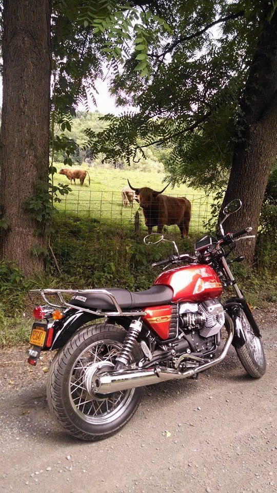

5,500 miles in, the smiles never really stop. I adore this bike, and have never put on so many miles so quickly. I'm curious about a few things, which have more than likely been discussed at length here, but it's always good to keep things updated as we learn more and more about our lovely Guzzi.
The single biggest question I have centers around the bike's attitude among startup and the first few minutes of riding. Mine (2012 Classic with 5,500 miles now) acts, to put it simply, like a carbureted motorcycle.
First, with starting. Sometimes it takes embarrassingly long. Other fuel-injected bikes might start within a half-second of pressing the button. Sometimes mine does too, but other times I've got to press it and crank it for quite a while while passerby give me a puzzled look. Why is his shiny fuel-injected Guzzi taking so long to wake up? It seems like she starts quicker when it's really cold outside (never in my life has a vehicle preferred the cold), but it's variable.
The 2012's still had the enricher, and it's a guessing game as to wether or not she wants it upon startup. The gentleman I bought it from advises that it should always be used, but sometimes (I think usually when it's hot outside, above maybe 62 or 63F) it has a harder time starting with the enricher on. Sometimes, it starts cutting in and out while idling with the enricher on until I turn it off completely, only a few seconds later.
Finally, I'm pretty sure I've read a lot of you guys saying the bike really prefers to be warmed up for a few minutes. Absolutely yes here. Mine won't tolerate a quick start-and-go. If I try, she'll buck and get all herky-jerky, as if I was cracking the throttle back and fourth. And if I pull in the clutch, it might stall. I have to pull aside, let it warm up for a few minutes, then she's a happy camper.
Is this the same behavior everyone is experiencing? I am wanting to do a valve adjustment to see if that'll help, and I might throw in a new set of plugs. The owner's manual lists BR9ES, as I understand a cooler-running plug, as an alternate to the standard BR8ES... has anyone tried this, just out of curiosity?
Thanks for any advice... just seems like my girl is a little cold-blooded, but once she's warmed up, she's nothing but love.

Very nice V7!  Yes. My 2013 V7 stone prefers a minute to warm up.  Don't know why, though I've read posts here from many guzzi faithful speculating about it.  I think it was Pete Roper that recommended letting the bike warm up for about 10 or so minutes.  Something about a heat sensor on the throttle bodies needing to be set.  Anyway, I did that and now my bike only needs a minute to warm up while I put on jacket and gear.  It's never stalled or lurched after a one minute warmup or after a hot start.

Nice V7, have the same one (don't see too many in red). I usually set the fast idle regardless of outside temp, start it up, let it run a minute tops and go. After riding a 1/2 mile or so, turn off the fast idle and never have/had and issues in all these years.

Outstanding! Apparently you and I have two of only 24 of these Ibis Red 2012's in the US. Yours is lovely, and I really want that rear rack.. May very well be my next addition.

Cool. Never knew there were so few in Ibis. Where'd you get that stat from? The rear rack is awesome, I use it often. Only thing I added has been Dart / Marlin flyscreen (pics of my bike are featured on their site - http://www.dartflyscreens.co.uk/products/moto-guzzi-v7-marlin).
All in all V7 has been problem free, a blast to own and I will likely never part with it (especially since I have an RT for longer trips and riding two up w/ the wife)..

Phil at Cleveland Moto informed me of the rarity of the Ibis. He and someone else from either his dealer or another dealer recall that in 2012, Guzzi shipped 1 box, or 48 total V7 Classics to the US, half of which were Ibis w/ gold emblems and the other half were black w/ gold emblems. Just like you, I plan on holding onto mine forever.
