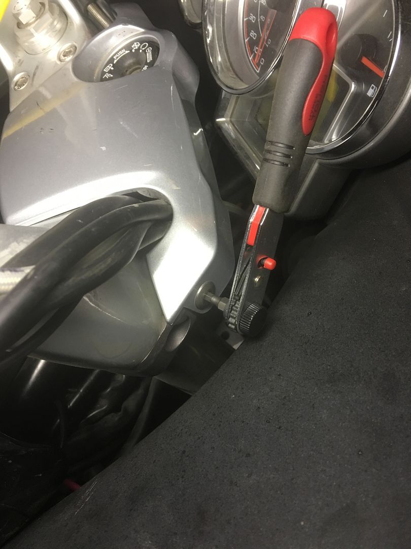

i am always amazed at how the Guzzi is assembled in layers and I always seem to be working on the bottom layer so I have to take off five or six layers of stuff to get to what I have to work on.  Guido was a sadist.  to be able to get to the heated grip connectors I had to raise the tank. to raise the tank I had to remove the instrument cluster deck.  To do that I had to take out the side fairing fasteners.  Then to get the old cables out and route the new ones in I had to take out the steering head cluster.
The steering head cluster was the only real tricky part. To do that without completely removing the fairing I had to dig up a mini 1/4" drive ratchet I have so I could get the retainer screws out.  That made the job a lot easier.

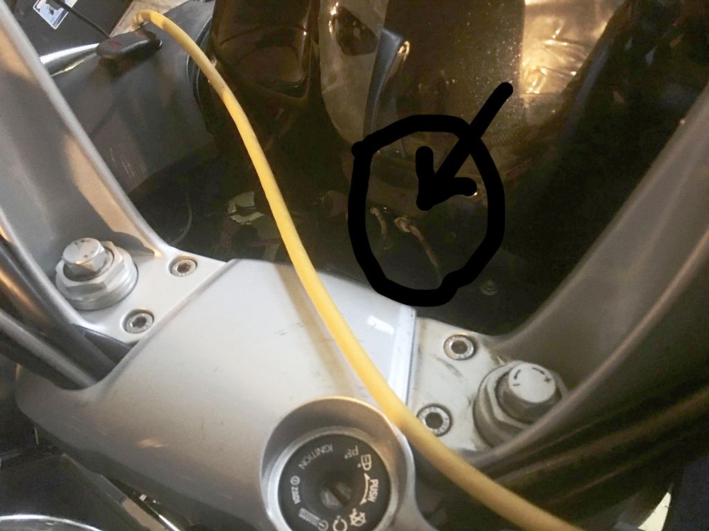

The connectors are buried dead center under the tank. I don't know if you will be able to see them in these pictures.
