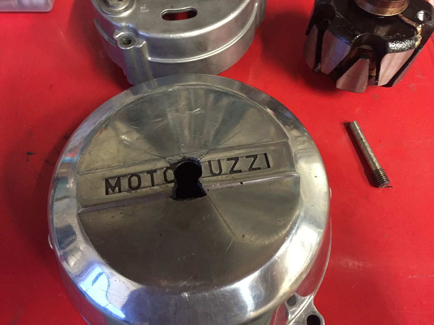

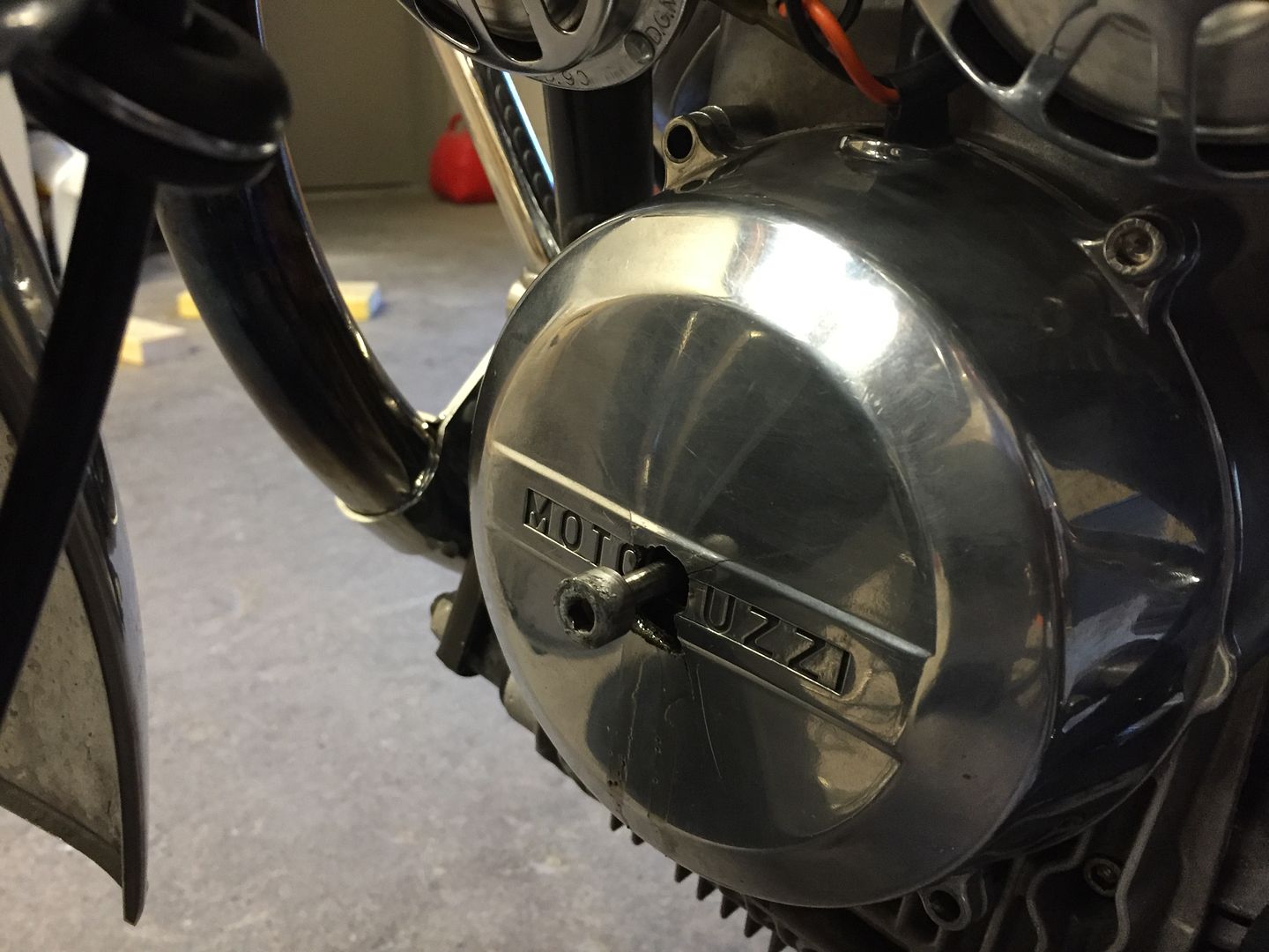

Riding my V7 Sport last night at the end of the evening and close to home I suddenly felt a brief decelaration and a high pitch squeal, it felt like a brake grabbing but it was very short lived and then the generator light came on. I was only a couple blocks from home. When I got in the shop I looked around the bike and noticed what I though was a stone stuck to the alternator cover, turned out to be the end of a bolt coming through the cover.
I had set the timing on the weekend and rotating the alternator with an alan key socket I snapped the rotor bolt. I made a new rotor bolt from a stainless steel bolt, the First Mistake, then I did not use locktite, Second Mistake.
While riding the bike the rotor bolt worked loose, then along with the weight of the rotor the bolt cut through the cover until it jammed at which time is snapped the bolt, leaving a few mm of bolt in the crank. The rotor no longer tight to the crank worked free of the grasp of the oil seal and hot oil saturated the stator and rotor negating the charging system,
I should have waited for a proper steel rotor bolt and torqued it with locktiite. Stainless is too brittle and a lack of locktite proved fatal.
Sucks!

Well it's somewhat comforting to know it's not a unique mistake, the V7 Sport sure makes a great drill press!
Basically a flat headed fastener cutting through a couple mm of aluminum in seconds is pretty impressive!

Hope you didn't damage the taper on the crank nose.
If the taper is undamaged assemble with a thoroughly dry taper (cleaned with  alcohol or brake cleaner).
Use only the proper grade steel bolt (and NO Loctite) tightened to 14 foot pounds and you will have no problems.
Meanwhile rotate your engine using the rear wheel with the transmission in the highest gear. It saves a lot of aggrevation.

Look in McMaster Carr catalog for " tap extractors" for the screw broken off in the crank...
Don't ask, it's a long story...
Can't use just any bolt, go stock, no loctite
Whoops sorry, wrong story...I snapped a tap when I tried to clean the threads on the crank...tap extractor got it out for me

Up to last year, MG Cycle used to carry a replacement rotor bolt, Bosch original supposedly. I'm not seeing it on their site anymore, so maybe no longer available. The one they sold was "gold" in color, the original Moto Guzzi one is black. Long story short, the new gold one broke while adjusting the valves when turning the engine over with the Allen wrench; I was lucky to get it out by removing the rotor then I was able to grab the broken bolt with pliers. I've also started using the turn-the-wheel-while-in-gear method to turn the engine over now.
Try to find an original bolt if you can, even if used. I think they are class 10.9 in the harness scale (don't quote me), but should be at least 8.8. I personally wouldn't use Loctite in that spot and I would also not use an SS bolt if you can't find the original and have to make one out of something out there.

Part Number 12 31 8 002 348 (BMW) is a direct interchange for the Moto Guzzi bolt.
Originals were finished in black oxide. Current one on Max BMW site shows a gold irridite finish. Same 10.9 tensile strength.

I have a single plate Ram clutch, not timing marks, I was verifying the TDC D and S marks and then marking the static and advance lines on the RAM.
Bike was hot after along ride, I should have let it cool down before rotating the crank. When cold and with plugs out the crank turns pretty easy.
Harper's have come to my rescue again with the replacement parts I need and the advice I can trust as to removing the end of the broken rotor bolt. :thumb:
Stuff happens,
So long as I can get the remains of the bolt out of the crank without drama it's another lesson learned.

yes, the rotor spun free of the crankshaft as the rotor bolt worked itself loose, when the head of the rotor bolt broke free of the rotor cover ( looked like a chick breaking out an egg!) the bolt caught in the rough edges of the cover, this stopped the bolt from turning and the bolt then snapped, a small section is still in the crank, This all happened in seconds.
The rotor looks fine as does the stator and crank.
I just need to carefully work the snapped off end of the rotor bolt out of the crankshaft.

I want to jb weld the bolt in the position you took the pic and install it on the trike.
