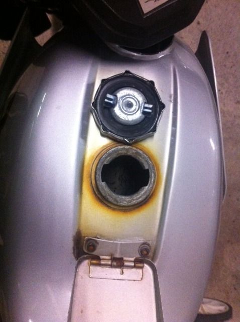

This is the cap on my V50II. If they are the same hopefully this will give you some idea as to how they work.
Good luck

On my III there's no attachment between the hinged cover and the cap which does simply unscrew ccw. Afraid yours being rusted in place portends bad things inside the tank.
What I would try is: remove tank, drain it of all fuel if possible, blow dry w compressed air, while supported upside down get a gracious quantity of 50:50 Acetone:ATF into the tank and let it sit a day or two to hopefully help free up the seized cap. It'll likely ruin any paint it comes into contact with.

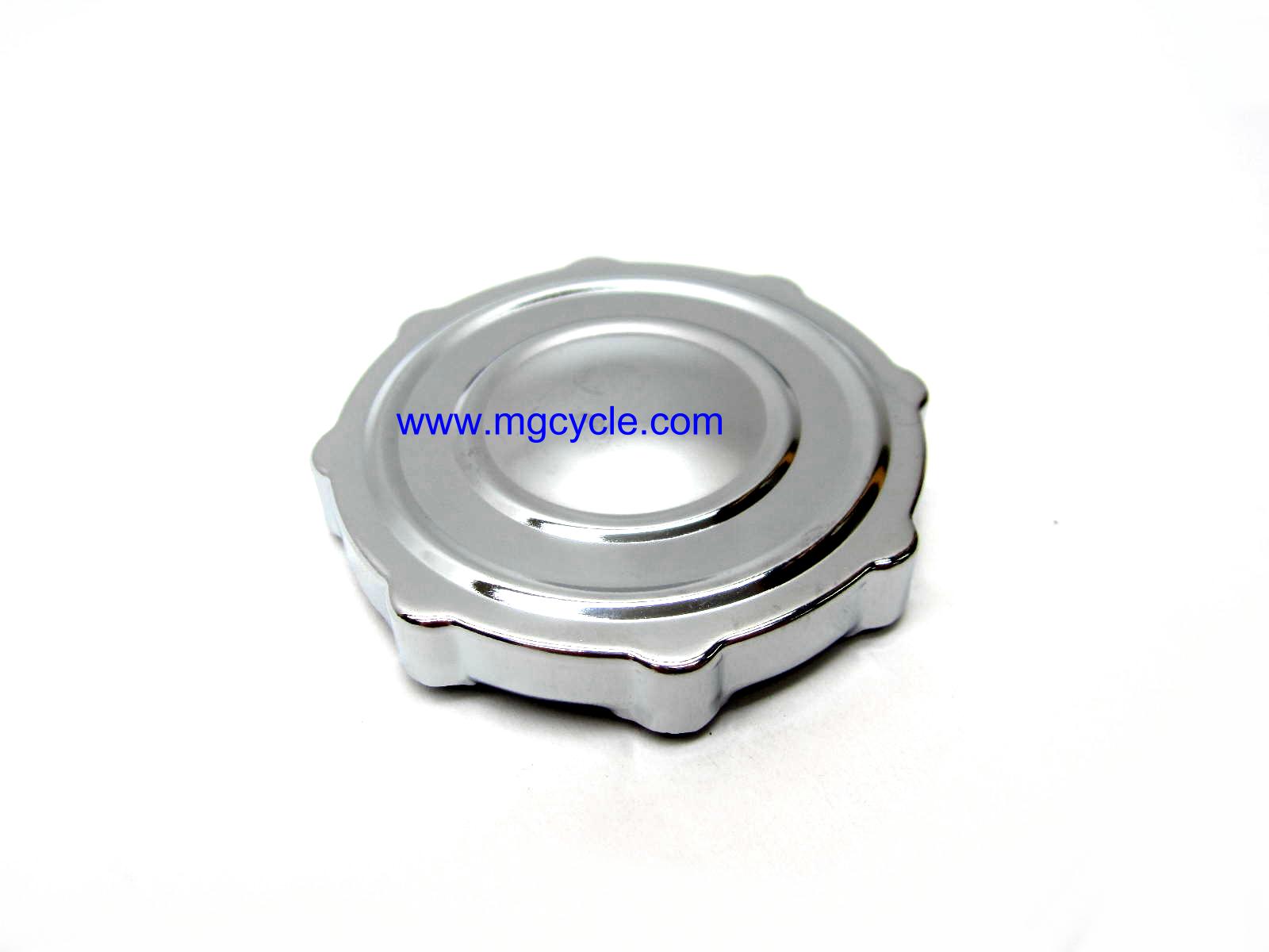

Under the flap should be this cap:
Turn it 1/4 turn counter-clockwise and lift up. Maybe use something to pry up a bit.
If that doesn't do it, I'd probably use (low pressure) compressed air in through the petcock (in "ON" position) to try and pop it off. Or remove the petcock first, especially if there's still gas in it. Cover the cap with a rag or something to catch it, of course.
It's as Charlie says, pretty hard to see how that could stick on minimal metal to metal contact, mostly neoprene or some other elastomer in contact with the top of spout,
Perhaps wrap it in rag and turn with a pipe wrench, remember anti-clockwise.

Thanks for all the advice. That is a picture of the cap. I am able to turn it slightly, but not remove it. I will try some of your recommendations.

O.K. the cap is off. Charlie's method worked. Turned it 1/4 turn, slipped a screwdriver under the cap and popped it off. Smells like varnish in there, and there is some rust.
