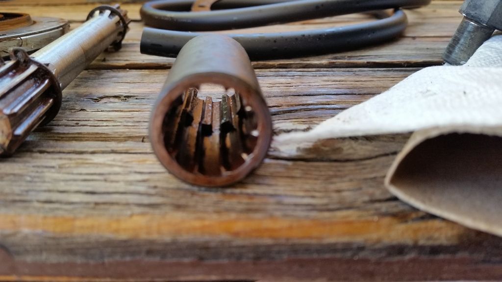

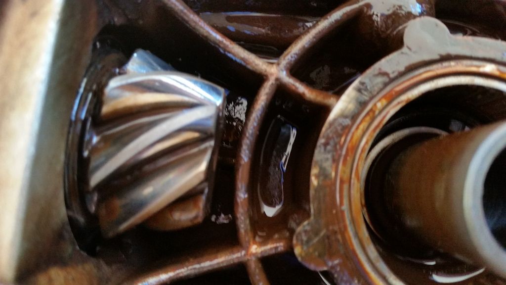

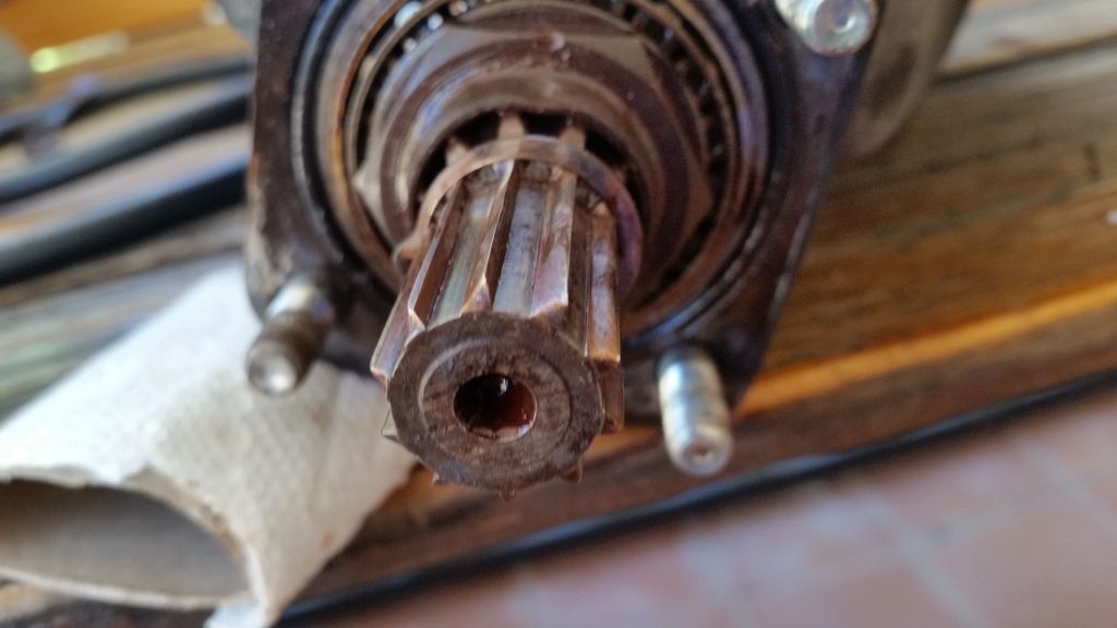

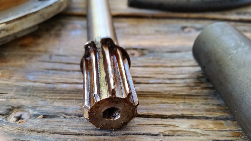

So, got ready tackle the seals.  But, noticed this...
and this
and of course the coupling
So, now I suspect something is causing this, which might have caused enough heat to screw up the seals.  But, what?
One laset data point.  The inner bearing race is loose in teh housing, ie, it will rotate just a tad, at room temp.  Does that mean enough heat to do something to the case itself?
I guess I am a bit 'lucky' cause I can get the replacement ring/pinon for the 7/33 rear end.  But, I don't want to replacee all the guts and then have it happen again.

Those gears look good but that pinion spline is toast. That's a bummer, you'll be needing all that stuff replaced. :sad: The bearing issue can be addressed along with it.
The wear on the splines is from lack of lubrication and possibly mis-alignment of the box on the swingarm. It's pretty common for these to wear like this unfortunately.

Splines not being greased enough or with a grease not up to the job is mostly to blame for the spline wear, IMO.
If you mean the outer race of the needle bearing was loose in the housing, that's not as uncommon as you might think on that type of housing. I've found it necessary to apply Loctite 609 to several I've had open for seals.

Spline wear, especially on high mileage bikes, is common. It's a good idea to keep the splines greased but obviously grease will get flung off and splines will wear.
One trick commonly used when things get this bad is to weld a new coupling to the pinion and then use a new driveshaft. This will prolong the life of the pinion but does mean that when the time does come to swap the gears out it is more difficult. Bevelbox castings and pinion carriers are ten a penny though so prolonging the life of the gears in this way and then building another box from scratch for when it finally fails is probably the best way forward.

In all seriousness you've done well, the drive shaft and splined joiner are a service item IMO.
The splines on the pinion can be welded up and recut, I've had that done once, I've also replaced the ring and pinion gear once in 200,000 miles. In all probability it will go back together with the same shims.
And that's with me pulling the bevel box off every second oil change to grease the splines.
Bearing spinning in the housing, loctite make several grades of bearing lock for just that issue, plus you could stake the bearing in a couple of places as well.

I've had sleeve welded many times, I like to get last mile and spline worn out before gear faces bugs me
Never remade the spline but there are people who can do this
Latest set of gears would break the weld, not instantly but 10-20K miles, weld again, gear faces sill good, cost a sleeve and shaft every year
Along with resetting UJ in bearing, always the clue, UJ spinning in bearing
Finally got assembly to serious engineer, forgotten more than I will ever know , there are marks on pinion now but I told him I want last 40K miles, he smiled and understood,  I gave him new bearing and machined UJ yoke, he made a pointer that fitted into UJ yoke and set swinging arm in mill
I was certain it was all perfect as every time I've fitted newly welded sleeve there is no resistance turning bolted up bits but still spline wears or weld cracks.
So he machined face for pinion flange square to pointer, both north south and east west
Then welded sleeve on worn pinion gear again, this time in jig to keep square, this was very tricky to do.
Whether the square weld or the aligned UJ/pinion was the major I'll never know but combined it's done it, 20K odd
Took apart recently, grease still intact, no rust, UJ not spinning
My "other" bike in UK did opposite last year, only around 140,000 miles on this one but was feeling vibey so took apart
second UJ in it's life was spinning in bearing but crosses good, turned it around (emery cloth to size)
Shaft, sleeve, pinion gear, cush gears (male and female) all completely Donald, all OE original owned since new
Made this souvenir for my bro , I like it, everything worn together, last miles from all, 140K reasonable I think
Pic is French hillclimb, may or may not have been where the missing pinion tooth went !

Fixed now, pinion aligned to UJ, swiningarm in mill
But why some do and some don't from new is what we have to call a Luigi moment
I've "fixed" spinning UJ's 100's of times without really solving problem, symptom and cause, this time I've fixed the cause, by asking someone cleverer than me.
Grease missing or UJ spinning are the symptoms not the causes, as is spline wear.
Pinion bearing loose or worn will do same thing, cause all to wear.
For most people it only happens once or twice in their lives so not an issue but I've done it too many times, had to find out, I owe the man a drink
Happy to share knowledge
Re: rear drive problem
« Reply #24 on: June 19, 2016, 07:39:21 AM »
I am going to be pulling the swingarm in the next week or so.  Will probably just replace the Ujoint bearing while in there (no reason not to).  It was replaced 30k miles ago when I had it apart last.  Will be interesting to see if it is wonky too.
« Reply #25 on: July 02, 2016, 05:16:11 PM »
Recent update.
Pulled the swingarm.  All looked nice and greasy in there with dripping rear drive oil.  The ujoint and support bearing looked nice and clean with no sign of ujoint spinning in bearing.  I will change the bearing...just because I am in there.  The current one has over 30k miles on it (maybe even 40k miles).
Ujoint.  I know this is the original and it has never been apart.  Is it recommended to disassemble and grease it?  It still feels nice and smooth with no notchiness (?).  I've done car ujoints before but they also have zerk fittings on them to grease them.
  • Posts: 29660
« Reply #26 on: July 02, 2016, 06:29:58 PM »
Pete, I like your idea and will consider that instead of buying new gears.  But, how do you weld it and not screw up the pinion bearing?  It doesn't heat up fast enough to overheat the bearing?
Do many spot welds, giving time for each to cool. It helps to have a dial indicator to keep everything (fairly) straight as you're doing it. Spot, rotate and indicate, tap as necessary for it to run true, repeat. You can keep it within a few thousandths, which is plenty close enough.
« Reply #27 on: July 02, 2016, 07:16:44 PM »
Charlie, I don't usually see "All looked nice. . .." and "dripping rear drive oil" in the same sentence.  Can you be more specific about this part?
« Reply #28 on: July 02, 2016, 09:27:49 PM »
RK, just trying to say that the swingarm section was wet with rear drive fluid, not dry.  It is a good thing that there is oil getting up in there cause then I know the bearings are getting some lube.
Thanks Chuck.  Would using a cross pin help at all?  Maybe a tapered pin that is spot welded to keep it in place?
May be a moot point.  Looks like I will be able to get a rear drive from another bike.
« Reply #29 on: July 02, 2016, 09:55:10 PM »
Gear oil in the swingarm behind the carrier bearing could indicate negative swingarm angles -- short shocks or undersprung.  The carrier bearing is sealed -- doesn't need lube and bathed in gear oil it could wash out its grease.  Negative arm angles can drain the lube from the punkin and add it to the gearbox
Gear oil in the swingarm ahead of the carrier bearing could indicate a bad rear seal or bad output shaft bearing.  If gear oil washes the u-joints they will dry out.
So be sure nothing bad is happening . . . . .
