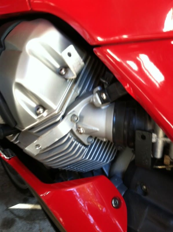

Will these bolt up or do they require some degree of fabrication?

Fabrication.
It isn't that hard, but it take some time to figure it out. I just went to Home Depot and purchased some aluminum stock and used a vice to bend and shape.

Thanks, BC.  Have you found them to be effective?

« Reply #3 on: June 25, 2016, 12:17:23 PM »
You can get the bracket you need from your friendly dealer along with the scoops and screws. That will have you 90% dine and attached in two of the three mounting points!
The guy I helped that with in his 2 valve Norge said it worked great

« Reply #4 on: June 25, 2016, 12:49:04 PM »
It helps but doesn't solve the problem. I probably should put the lowers back on for the summer months and see if that helps the problem.  I hadn't thought that the 8valve brackets would work but would have taken that route had I known, but this took me a couple of hours along with a bench grinder and some black paint.

It helps but doesn't solve the problem.vv I probably should put the lowers back on for the summer months and see if that helps the problem.  I hadn't thought that the 8valve brackets would work but would have taken that route had I known, but this took me a couple of hours along with a bench grinder and some black paint.
Thanks for the word.  I might try these.  Also gonna try Beetle's 2v map for the bike as well since I've heard others say that also helps a small bit as per heat.
I also have the map, but give the scoops a try as they are not very expensive. Don't know about the brackets but the aluminum cost me $8 bucks? If the MG brackets are $35 bucks and I still had to modify them, then I'd pass, but that's me.

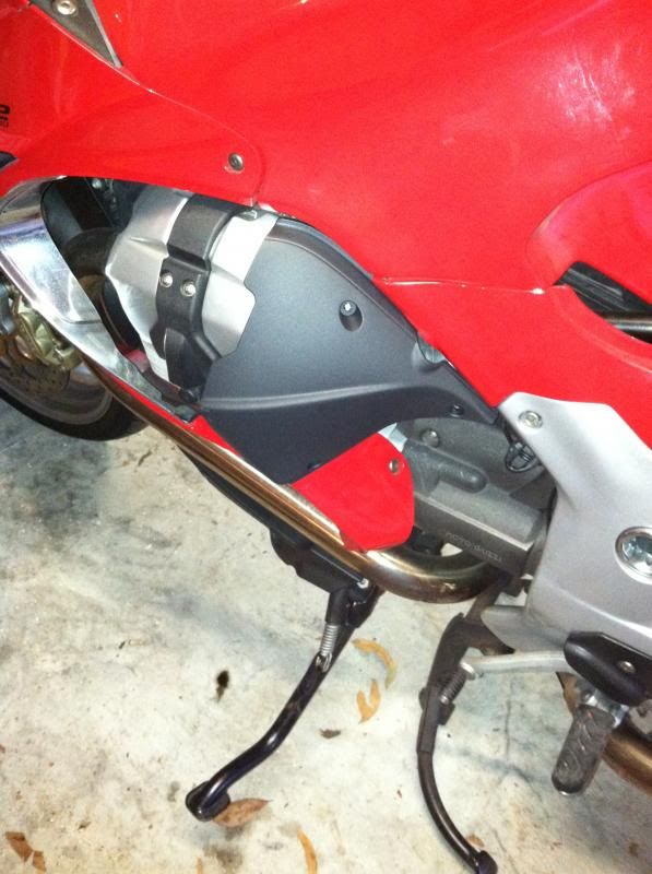

Like you mention, someone else told me I need to put the lowers back on the bike.  Right now I have both lowers off and only the skirt under the headlight fairing.  I like that look but I suppose the lowers redirect the heat a good bit.  Will have to try.  Or just shed all the fairings and get me a Breva headlight  :boozing: :grin:
