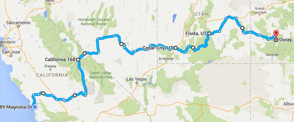

I am probably too far south for you Peter but I'm heading out tomorrow and will have the cables and computer with GuzziDiag on my Stelvio.  I'm using John's map as well so I can at least report back my results.
My route.  I should be in Big Pine, Ca tomorrow night then Cedar City Ut on Thursday and in Colorado on Friday.
