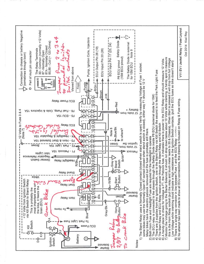

Re: Help needed in Thunder Bay Canada URGENT
« Reply #10 on: July 13, 2016, 02:48:17 PM »
It could be your stand relay, 3rd from rear, swap it with relay 1 if it's a 5 pin otherwise pull relay 3 and poke a wire from 30 to 87A. (87A is the middle one of the 3 small pins, 30 is furtherest away. Even if you have the stand switch disconnected the 87A relay contacts can play up.
If you have the switch disconnected the relay is doing nothing anyway, you might as well jumper it out.
 ---- 30
 ---- 87
|  |  | 87A is the middle one at the bottom, jumper 30 to 87A
Hold up, you said no dash lights, that has to be the ignition switch I think, if it's just one of the contacts causing a problem you could jamb a wire in fuse 2 and jamb the other end in the common of fuse 3 & 4, this would effectively put both switch contacts in parallel.
This sketch might help
A couple of possible fixes
Good Luck
« Last Edit: July 13, 2016, 04:54:00 PM by Kiwi_Roy »
