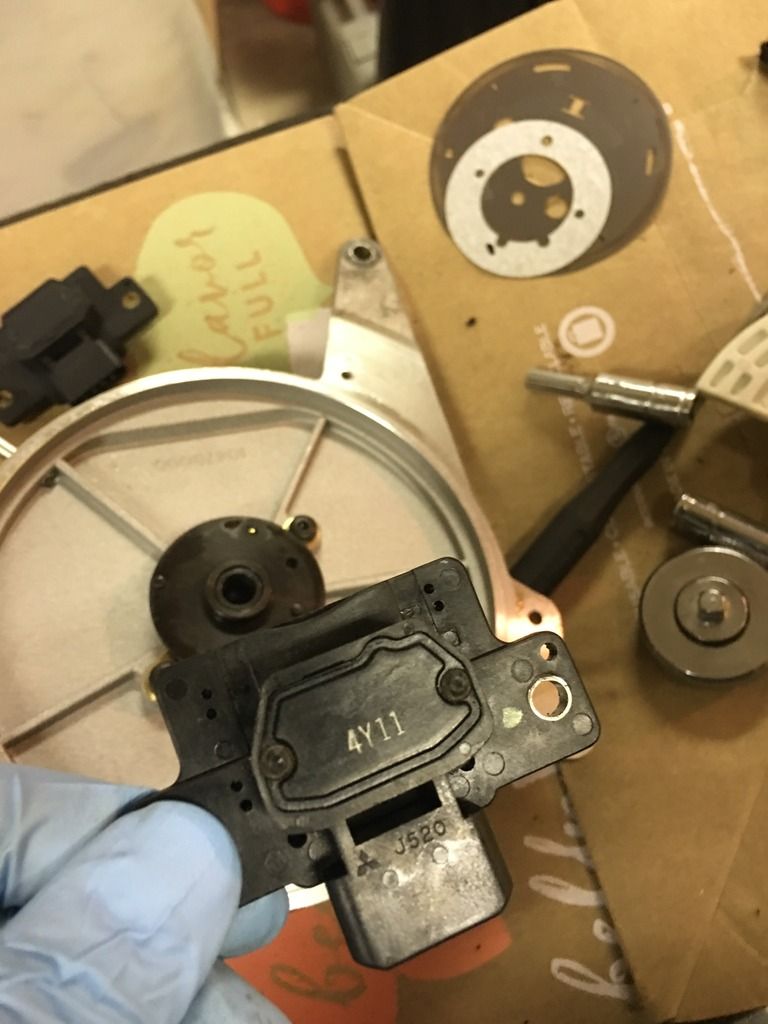

This is the optical sensor from a GM OptiSpark used on the LT-1 engine in the 90s. In the upper right the larger disk is the one with the little holes. It's really thin steel (less than .025in) that has probably been laser cut. With an optical sensor you want as thin of a disc as you can get.
Can you post pictures of the phonic disk you have?
If you put it in the distributor what will you do with the distributor parts?
I still don't understand why you can't use an electronic ignition as the source for cam position. There are some open source electronic systems you could hack and get whatever data you need.
If I understand correctly you are looking to put the later FI from a V11 on the early big blocks? I assume they have the phonic wheel on the cam?

The efi big blocks have the phonic wheel on the cam.
If I put it in the distributor you can have the old parts.  I'll be keeping the body, advance weights base plate, primary shaft, points plate and cap.
I'm not using the electronic ignition because they are 'encoders', which means they have logic associated with the sensing (look at a pic of the C5 pickup -- it sits on a circuit board with LEDs and other stuff soldered on) to do things like choose which pot to spark. The 15M ecu acts as the encoder for fuel injection and makes all the choices.  I have no idea what kind of signal an ignition encoder would send to the ecu.
The wheels have different tooth counts than the oem phonic wheel, and the oem wheel has a gap that I don't see with the ignition units.  I believe the tooth count and the degree sweep of the gap where teeth are missing is significant.
If I can make this work the cost will be the sensor and having a wheel made v $500 or so for a made-up version that will need wheel modifications and may or may not communicate with the ecu.
I've packed the actual phonic wheel, but here's the drawing:
It's been astutely pointed out to me that the flaw in the drawing is that an optical reader reads the opposite of what a magnetic sensor reads, that is, where the magnetic sensor reads the teeth, the optical sensor reads the gaps.  So the mistake is the missing 'teeth' need to be a missing 'gap'.
Also, the actual scale of the wheel will depend on the actual size of the sensor.

But, carbon fiber is a possibility.
PS don't forget that the 'hub' portion of the wheel is as important as the teeth, especially when fitting a thin disk to a shaft.
« Last Edit: August 16, 2016, 08:32:30 AM by charlie b »

No offence intended, but that drawing is either not drawn to scale, or it's dimensioned incorrectly. That said, you wouldn't need a CNC to make that, just a knee mill, a dividing head, and some patience.  :smiley:
Offline Matt Story
  • Posts: 725
  • Flint, MI
Re: Challenge to you CNC guys
« Reply #27 on: August 16, 2016, 09:41:50 AM »
None taken.  No attempt was made to make the pdf to scale. It was not intended to feed the cnc, only to be human readable.  The native CAD formats provided are however to scale.  At this point the wheel will most likely need to be scaled down from the indicated dimensions so the current models are likely moot.
Waterjet is more precise than the part needs and steel is the way to go.  A hub can be easily tack welded or silver soldered to it.

I've never looked at a Guzzi system on an oscilloscope, but AFIK they are all variable reluctance type pickups.  The following is purely theoretical, results not guaranteed, your motorcycle may vary, etc.
A coil of wire is wound on an iron core, and a small permanent magnet is placed on one end of the core with the other end close to the "phonic wheel" or whatever is used.  (The permanent magnet is why some of them have a tendency to catch steel "swarf" necessitating the occasional cleanup.  Cheap and simple, no external power required.)  As a tooth on the wheel approaches the pickup, the magnetic flux density changes due to the proximity of the metal tooth to the pickup core, thus inducing a voltage in the pickup coil.  The voltage will  rise as the tooth approaches and suddenly switch polarity and decay away as the tooth departs.  Output voltage will change as RPM rises, voltage is proportional to d-phi/d-t, the time rate of change of magnetic flux density, for those of you following at home on your Jr. Wizard physics set.  Voltage could be fractions of a volt at low RPM to a few/several volts approaching red line.  The tooth flying by the pickup faster makes more voltage.  Presumably the ECU input is set up to deal with this.  Questions which determine whether it will work or not in your application include output pulse width and frequency.  If the wheel (and thus the tooth) is too small, output signal will be small and fast so the ECU detection circuit might not see it.  Similarly if the frequency gets too high the detection circuit might be overwhelmed and can't figure out the individual pulses.  The reason for one missing tooth is to make one piece of the waveform look "different" so the ECU can use that to figure out where TDC is.
For example on the Digiplex system (at least as implemented on a '96 Sport 1100) there are four lumps sticking out from the edge of the flywheel.  One lump is actually two close together, to make that one look different.  This system will fire the plug every time TDC comes around, since it has no way to know which one is compression.  Theoretically, having a spark blown out the exhaust wont hurt anything, other than inconveniencing a few more electrons.  The more complex ECU system uses the cam phase with more teeth so it can divide one rotation into smaller chunks, to more closely figure out when to do what.  (Squirt the injector, fire the plug, whatever.)
Hope this helps.
Howard
PS
I found a pretty good write up on the Megasquirt site, it starts off with a generic description of pickup operation.
http://www.megamanual.com/ms2/pickups.htm

So scaling down the wheel to fit inside the distributor may not work because it will change the size of the teeth and thus the signals to the ECU? I was wondering about that.
