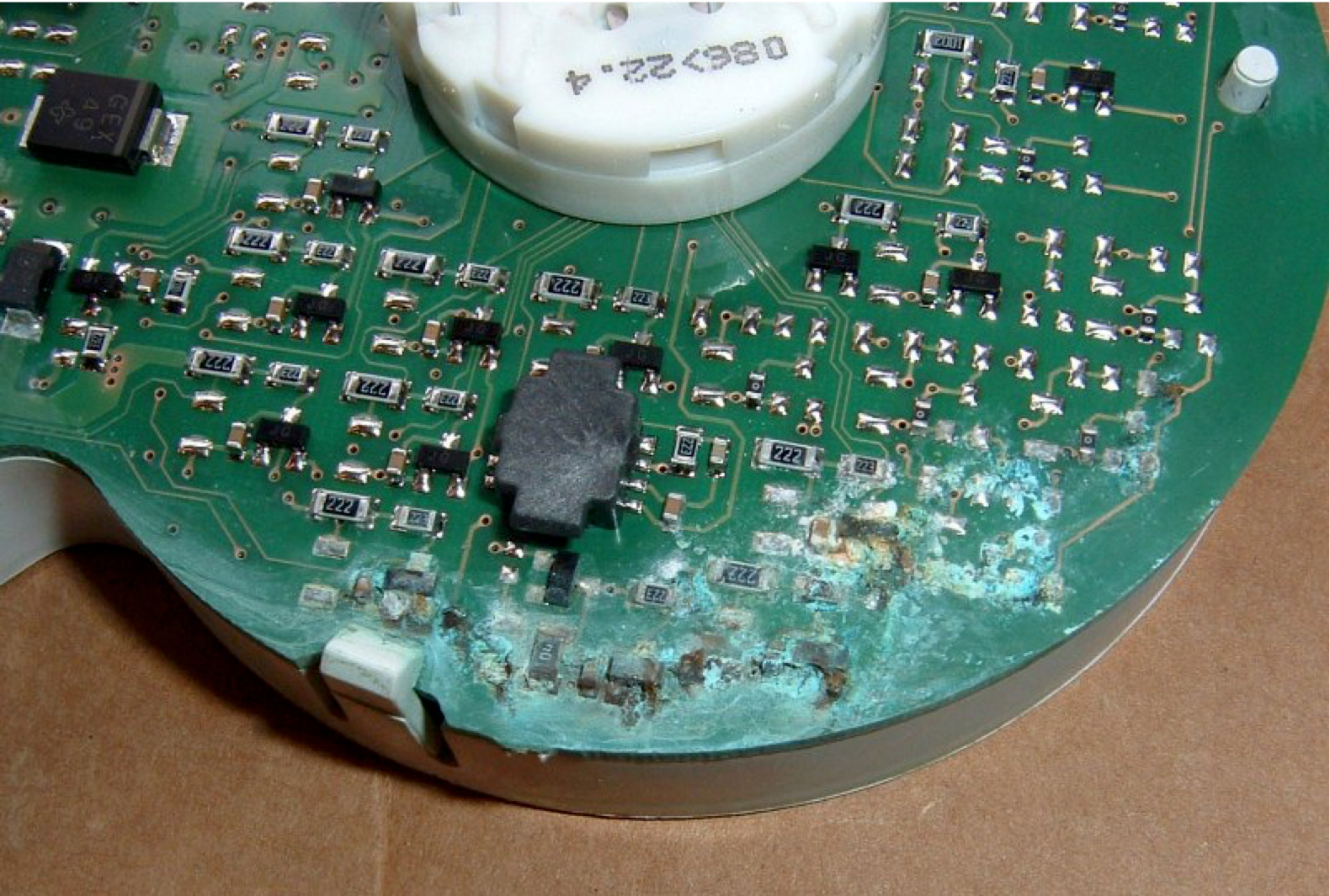

Yes, your hazard warning button is connected to pin 14 of the dash (see the wiring diagram here http://www.thisoldtractor.com/guzzi007/schematics/2005_Breva_1100.gif).
I have done a lot of research on the moisture problems in the Griso's dash, which is a close cousin of the Breva's, sharing many components. Based on what I found out, I strongly suspect you have a chronic and progressive problem caused by moisture. Prospects look grim. The cost of a new dash is now above $800. (Search for part number 05760031 at af1racing.com.) I do, however, have advice short of buying a new one.
1. Since the problem is progressive and depends for its progress on electrical currents flowing through contaminated water droplets, I would immediately stop riding the bike and also disconnect the battery. Some current goes to the dash when the key is in the off position, presumably including to the hazard warning light circuit.
2. Then I recommend you remove the dash housing from the bike and disassemble it far enough to expose the printed circuit board, on one side (the bottom). You may well see the problem caused by the water, as on this dead Breva dash, where the hazard warning lights had switched themselves on and off even when the switch had been disconnected, before the final failure:
or the damage may be harder to see.
3. Then take your dash to an appropriate local cell phone or computer repair shop, as discussed in my recent post, here: http://wildguzzi.com/forum/index.php?topic=84988.0.
4. A more expensive source of help is here: https://www.carmo.nl/, Carmo in the Netherlands, recommended by a user here: http://www.guzziriders.org/breva-1100-clocks-lcd-display_topic4376.html.
To understand what is likely going on, and how it could be fixed, I recommend you read my three posts on the Griso dash, which start here: http://wildguzzi.com/forum/index.php?topic=84968.msg1340261#msg1340158. (There are internal links to the second and third parts.)
As for the fix, it may not be too late to save your dash by a bit of micro-surgery, followed up by moisture proofing, either the application of a conformal coating (by the phone repair shop; a bottle costs $10) or possibly by isolating the board from moisture. Again, see my earlier series of posts. On the other hand, it may just be too late if the corrosion looks like the picture I posted above. See your cell phone shop to get an opinion.
Good luck.
Moto
P.S. There is a description of disassembling the dead Breva dash pictured above, here: http://www.guzzitech.com/forums/attachments/clocks1-doc.969. Don't go any further than exposing the back of the PCB before you take yours to the cell phone repair shop.
« Last Edit: August 25, 2016, 08:02:26 AM by Moto »

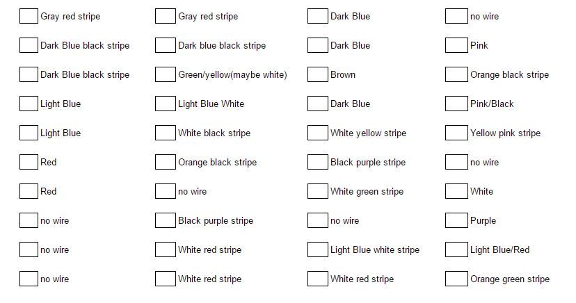

Does anyone have an image of the wires going into the main dashboard connector? The guy that is fixing my dash needs to know the wiring colors in order to bench test the dash and I'm not able to get a good enough image to show all the wires of him. Has anyone had it apart?
Also, I may have found a viable US alternative (local for WA residents) to Carmi in this guy that is helping me. His prices are very fair although I may pay more than the rest of you since I'm the guinea pig for him.

Moto seems to have nailed the problem, I repair a lot of circuit boards and what he shows id moisture for sure.
The microprocessor inputs are so sensitive a tiny leakage current is enough to trigger the inputs.
You should be able to purchase a can of Conformal spray from a good electronic store.

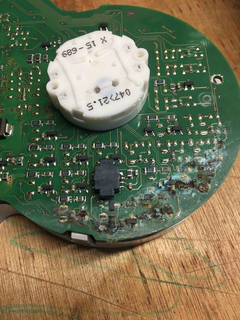

Here's the picture of my dash's damage. There is also apparently damage on the front of the circuitboard, which isn't surprising in the least.
Hah! Just as I predicted -- similar symptoms, similar moisture damage! Science!!
My earlier posting on the left, your dash on the right:
This is very helpful, thanks.
I'll post my revised breather design soon. The original one is here: http://wildguzzi.com/forum/index.php?topic=84968.msg1340261#msg1340261

I'ts interesting that the damage occurred in roughly the same spot, what's the reason for that?
It was the concentration in one corner that made me wonder if that part of the board gets totally immersed.
Does anyone else have pictures, Norge, Griso, etc.
I usually try scrubbing the board with a soft wire brush to get rid of that sort of crud, it doesn't always work but does often enough. Conformal coating will withstand total immersion, I have seen industrial instruments with the case full of water still working happily but I wouldn't recommend it
Is that the low spot when the bike is leaning on the side-stand?
"Loud Valves Save Lives"
2004 Triumph Bonneville T100
2006 Breva 1100 (red)
Nicholasville KY USA
Moto
Re: Breva 1100 flashers, potential failed dash?
« Reply #23 on: September 06, 2016, 03:56:58 PM »
Yes. I believe moisture condenses from the air inside the dash and then runs down the board, collecting toward the bottom.
Moto
« Reply #24 on: September 06, 2016, 03:59:59 PM »
Can you show your desiccating breather design Moto?
I just posted the new design as a continuation of my original series of three, here:
http://wildguzzi.com/forum/index.php?topic=84968.msg1354221#msg1354221
Regarding your question about whether a conformal coating will cure the problem completely, I don't know. Kiwi Roy just reported some promising observations. But the guy I spoke to at a phone repair shop seemed to think that having both kinds of protection (coating and desiccating breather) was better.
M.
EDIT: On reflection, I'd say conformal coating should cure the problem completely, IF it is applied correctly. But correct application seems to be difficult to achieve or prove.
« Last Edit: September 06, 2016, 07:45:04 PM by Moto »

.... and that's the dilemma - The conformal coating treats the symptoms and not the cause
I'm quite prepared to accept that it will protect the board if properly applied, however the source of the moisture (condensation or leaks) will continue
Decisions decisions  :wink:
1993 TW125 "POS" - Resting
Doppelgaenger
« Reply #26 on: September 07, 2016, 01:52:27 AM »
The condensation is the source of the problem, however the conformal coating does seem to be a permanent cure.
As guzzi flaws go I'd much rather deal with this design flaw than something like rollerising an 8v 1200 or the hydro issue  :evil:

Also, I'm going to just put this up here in case anyone ever needs it for reference. My repair guy asked me for this in order to bench test the dash and see if any components are actually damaged instead of just being corroded.
This is a map of the wiring harness wire colors as they plug into the dash, as seen looking at the pins on back of the dash. The black connector is the two left columns and the white connector is the two right ones.
Offline tris
  • Posts: 2898
  • Location: United Kingdom
« Reply #29 on: September 07, 2016, 03:00:48 AM »
If you've not seen this is this any help to your sparky?
www.guzzitek.org/gb/ma_us_uk/1100/Breva1100_Didacticiel(GB).pdf    Page 35
