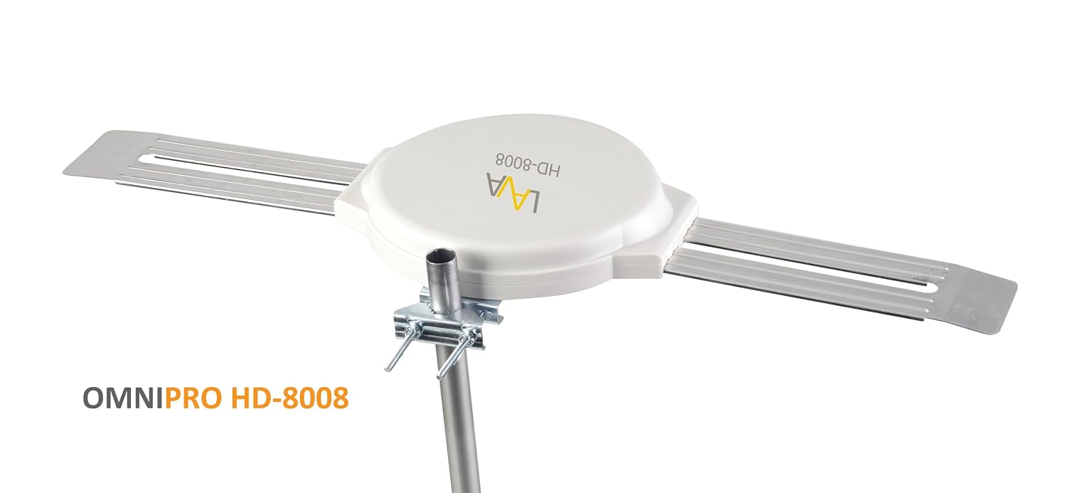

We decided to cut out Direct TV and go over the air. Sometime back I bought a little boosted indoor antenna for about $30. That allowed me to get 17 stations but only one of the three network stations on one TV and eight stations on the other TV with only one network station.
I recently bought a large passive outdoor antenna that is suppose to be good up to 80 miles. My furthest tower is about 40 miles. For the last couple of weeks I had it mounted close to the house wall on a T-post only four feet in the air. Our deck and elevated gazebo were in front of it. Reception was the same as I was getting with the indoor antenna.
Today I mounted it about 12 feet in the air with a totally clear path. Now my reception is only four channels on one TV and none on the other. I have double checked all connections and have tried rotating the antenna different  ways with no improvement or it gets even worse. Any ideas? Am I missing something obvious here? I expected much better reception after elevating it. I live in a flat area of Kansas so hills are not a problem.
GuzziJohn

What feed line are you using?
How carefully have you aimed the antenna? (find out the compass direction for the transmitting antennas and set your antenna that direction)
Is the antenna's designed band the same as the TV transmitters you're trying to receive? (VHF vs. UHF)
How are you feeding two TVs from one antenna? (splitter or amplifier with splitter?  Indoor amplifier or mast mounted amplifier?)

Thanks for the replys. I measured it and it is at 18'. Previously it was at 4ft. with much better reception. House roof is composite shingles. Have rotated it a few degrees at a time, stopped and check reception, little difference. I will look at the setup again tomorrow. I was running out if daylight plus had a thunderstorm approaching so I might have missed something from being in a hurry toward the end. TVs are both digital Samsungs.

What you say, makes it sound to me like you simply have a failed cable or connector. I would look at that closely first.
If not, then it is possible that you raise the antenna and hit a null. Notice my antenna in the photo on that mast, can be raised and lower to avoid those. But at the height we mentioned, that shouldn't be an issue.
Another possibility is that you have a nearby strong TV or FM station, and by raising the antenna, you just overloaded the front end on the TV. But that typically only happens if you have a preamp on the antenna and those broadband preamps gets overloaded easily.

My guess is you moved the antenna into a null zone. We have a Yagi antenna (see photo OMG has, just like that one) mounted on the swamp cooler: We have a metal roof. The whole affair is in the middle of the roof. The antenna is on a mount off the side of the swamp cooler about 3 feet up, about 6 above the roof. We have a very low roof so the whole thing is not that high.
I have the antenna pointed towards South Mountain about 20+ miles away but North Mountain is in the way so the signals are probably reflected through a valley. We pick up about 80 stations, for the most part it looks better than the cable signal we had.
There are web sites that will help you in pointing the antenna (many are like the yagi in that they are highly directional - which means excellent gain, but if they are off they no work so well). Check them out if you have not done that yet. My two cents.

Some progress this morning. I replaced the new splitter that came from the antenna company and put the old splitter back on and now I have reception back to both TVs that is at about the same level as before raising the antenna. It may be that I need a booster here. Will keep playing with it. Thanks to all's help other.

By definition, a 2-way splitter reduces the signal a little more than 3 dB at each output, which means there is only about half the signal going to each TV that you had from the antenna.
Also, the feedline between the antenna and the TVs is not perfect and absorbs some of the signal.  That's why I asked what feedline you're using.  At UHF frequencies, typical RG-59 cable will attenuate more than 9 dB per 100 feet, which means you'll have only 1/8 of the signal you started with, if you have 100 feet of feedline.  Even with 50 feet, you'll lose about 2/3 of your signal.
The easiest way to prevent losing too much signal is to put a good amplifier at the antenna.  If you amplify it with a Motorola broadband drop amplifier, you'll gain 15 dB at the antenna, so you can lose 10 dB in the feedline and 3 at the splitter, and still not fall below what the antenna provides.  Amplifying at the antenna is necessary because if you amplify it at the house end, you'll be amplifying noise along with the signal, lowering your signal to noise ratio and probably not helping with the goal.
I'm using a couple Motorola 484095-001-00 amplifiers on two antennas I have 65 feet up on a tower, and they've worked flawlessly for years, though dozens of thunderstorms.  Unfortunately I see they've been discontinued, and I haven't found their replacement yet.  The were something around $60 new when I bought mine.
Edit:  It looks like there are other amplifiers like the Motorola cheaply available with a good warranty:

The basic spec for splitters for OTA is they *must* have a frequency range of about 100-700 MHz.  If your splitter is wider than that it is probably good.
A two way splitter will send a little less than half of the signal power to each output.  When you get more outputs it gets stranger.  Some 3-way splitters will send a little less than a third to each output, others will send a little less than half to one output and a little less than a fourth to the other two (think of a splitter hooked to a splitter).  More ports can get more complicated.
To go to more than two outputs a distribution amplifier (amplified splitter) is probably the best way to go, but is more expensive and requires power.
Be aware that amplifiers also increase noise levels, so you can't just keep daisy chaining amps and splitters to cover a large installation. Better to get one more expensive distribution amplifier with enough output ports to satisfy your needs.
Amplifiers should be located as close to the antenna as possible.

Up to 17 channels on both TVs. I had to use a 100' cable but needed about 65 feet of it so when I can pick up an end I will cut it down. One to the splitter lines are probably another 30' or so to the TVs. Using the old lines run by Direct TV in the house.

Consider putting an amp as close to the antenna as possible.  A weatherproof one at the pole powered by a coax power injector in the house, or an amp just inside the entry to the house.
