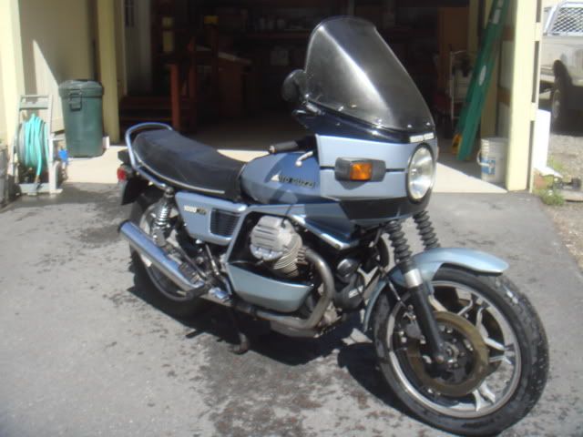

My daily rider till I got my Norge. 10 years of great service in Alaska.
hosting
Then why do you have a CX100 listed and not a SP?  BTW, I still have a`81 CX100  made into a SP somewhat.  :azn:
I sold it when I got the Norge. A buddy really wanted it. It was his first Guzzi, so it still lives in Anchorage.
