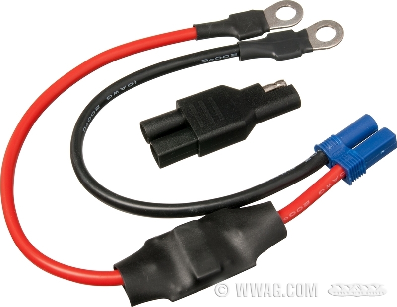

I just installed one these:
http://www.revzilla.com/motorcycle/antigravity-micro-start-battery-harness-kit
On both my Ducati Monster, who's battery is completely inaccessible, and my F800GT, who's battery is inconvenient to get to.
The blue connector plugs into most of the compact Lithium jump starter units.
DON'T use your regular tender lead.   You'll blow the fuse, or, if you have a big enough fuse, you'll met the wiries.
The black adapter pictured allows this to be used to connect a battery tender.

« Reply #14 on: November 22, 2016, 03:48:47 PM »
That's nice, especially the SAE adaptor. I'm lucky in that all my current bikes have relatively easily accessible batteries (and power outlets). Both big beemers have an additional positive battery stud just for jump-starting, since only the negative terminal is accessible.
