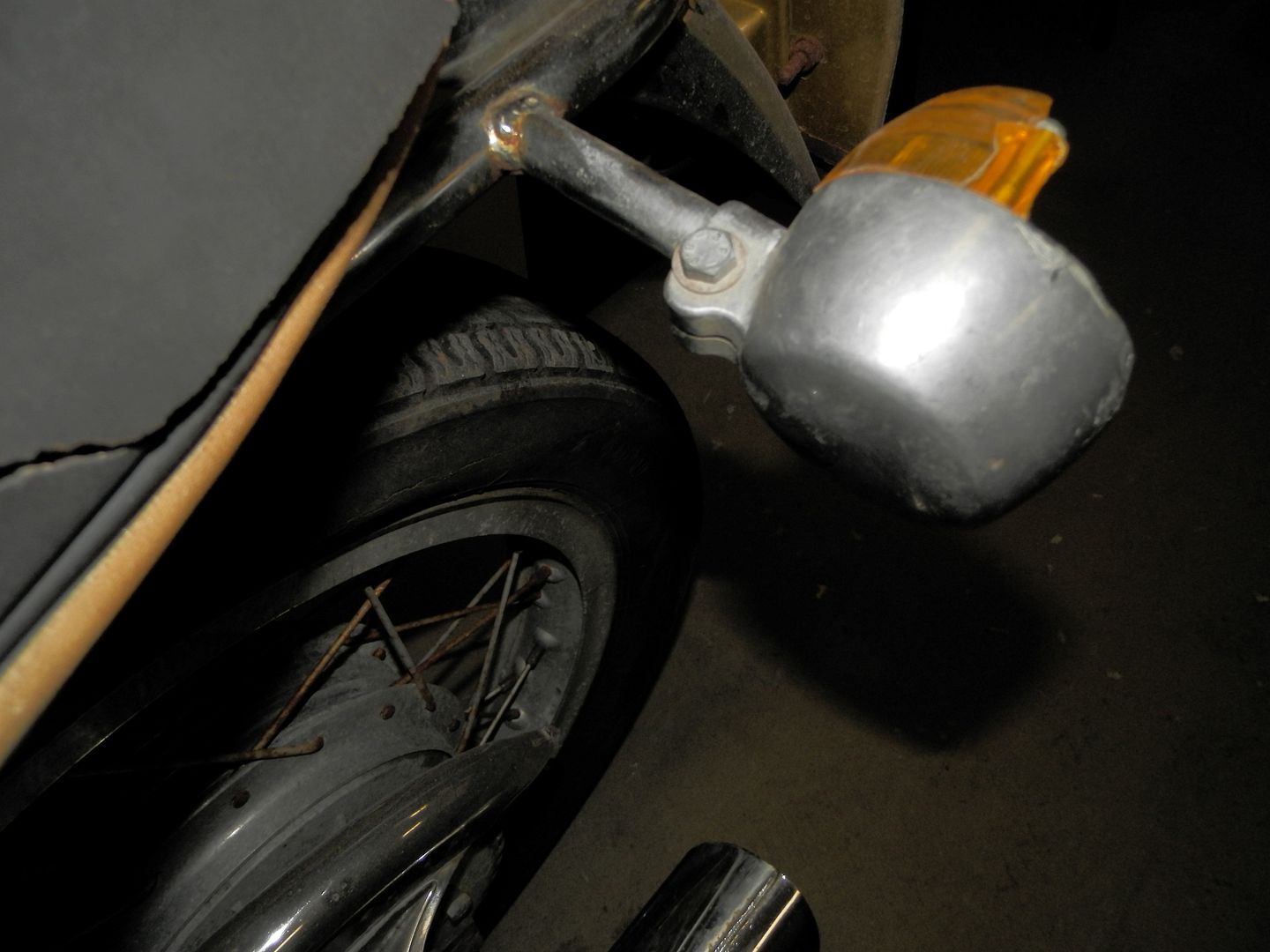

I picked up this 1974 Benelli 650S Tornado last week, mostly all there but a little rough around the edges.
From Ebay I have found a good pair of side covers, a decent used seat and instruments plus some misc parts. A couple suppliers in Germany have had most of the other things I need, cables, gaskets, rubber parts etc.... Motor is seized but the mufflers are in real nice shape. Last registered in 1979. The sat pan is crumbling just looking at it, spokes are rusted, usual stuff after sitting for so long.
Looking forward to tearing into it (after the 77 Le Mans gets done).
If anyone has a set of original signal lights for sale I would sure be interested.

Looks to be solid but lots of surface rust, I will fill it to the brim with Evaporust and let is do its magic for a month.
Hi Charlie, its a real dog, unloved and uncared for. I think we share a common sympathy for these poor old muts, the humane society for unloved Italian classics.
The good news is I got it for cheap, bad news is it needs a lot of work!
