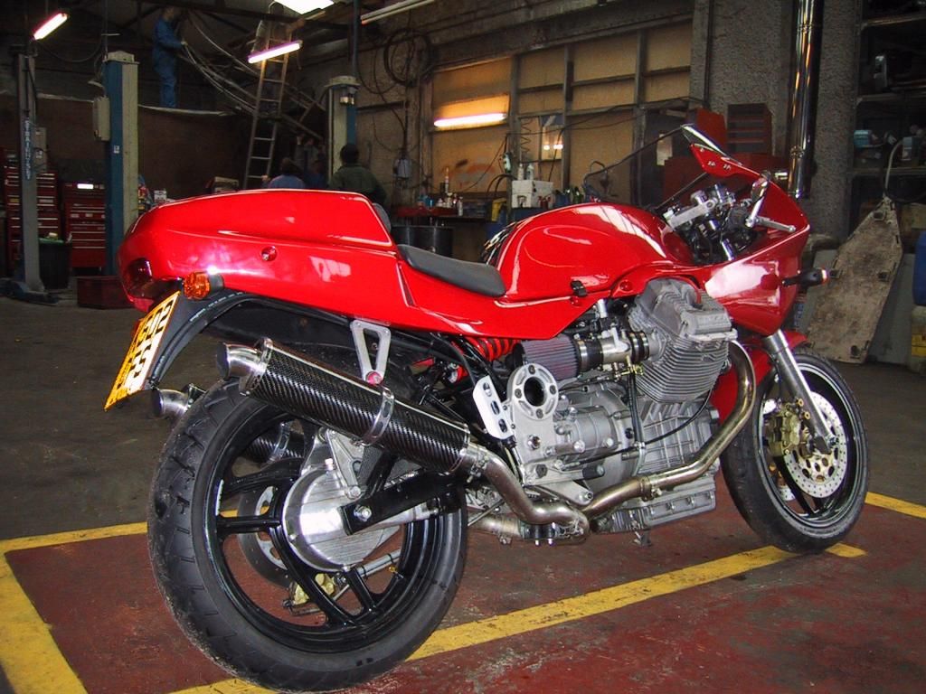

the 4v heads are the best looking guzzi heads made, the whole engine is a beauty:
Paul
Daytona 1225, Stelvio 1151

Yes is the sump that once was made by Moto Special. The word was that it cools so good, you don't need an oilcooler. Also cavitation is ruled out. I ran it a long time without cooler, no problem on track days because its at speed and max 20 minutes. On the road when in stop and go traffic the engine went way to hot.  So I ended up with a sandwich plate with thermostat. And a v11 cooler.
Since then engine is much lower temp. But in stand still traffic you will need a fan. Little place for that.

You're not alone in being confused as to which 8v bikes suffer from which ailments, John.  I've read all the horror stories about flaking cams and worried about mine (..although I've found no evidence of a problem when I've checked oil & clearances etc.  I suspect my oil pump's fine too ~ although I still have the Caruso pump & steel gear in a box waiting to go on it).
As to overheating:  My bike is fitted with the spacer on the sump, and this mates with a small oil-cooler.  An oil temperature gauge resides in the fairing (beneath the twistgrip ~ see pic) so I can see immediately how hot it's getting when on the move.  In truth, the bike runs a little cool most of the time; so much so that I often extend any run-out in order to let it reach operating temp. before I head home.  I can't remember ever seeing much over 85 deg on the gauge, even in busy traffic.
