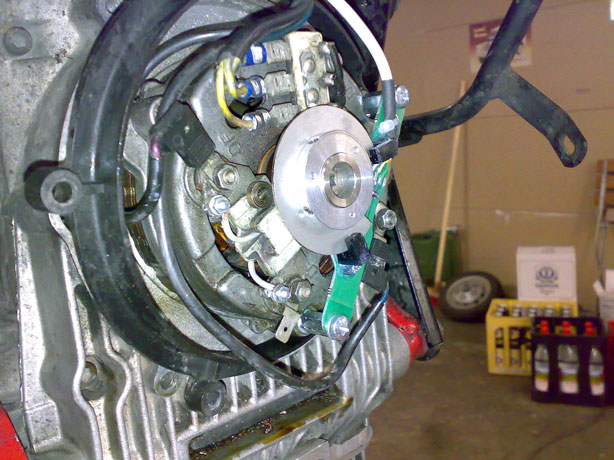

I'm not doubting you but I am confused, Going to the Silent Hektik site for Moto Guzzi, the picture I get is this
Now maybe I'm looking at the wrong thing and as the site is all in German, I don't know what it's trying to tell me. But that looks like a multiple trigger single pick up. As I said maybe the system uses magic beyond the limited scope of my intelligence. It looks beautifully made.
The Sachse system uses dual pickup single trigger, like this
I'm just baffled how the Hektik system knows which cylinder its to send the spark to, whereas the Sachse system each pickup is independent, so the left or right can only be the left or right
It could well do it though clever programming I guess
If you do know more I'd love to be educated

That top pics rotor bolt has seen better days.
