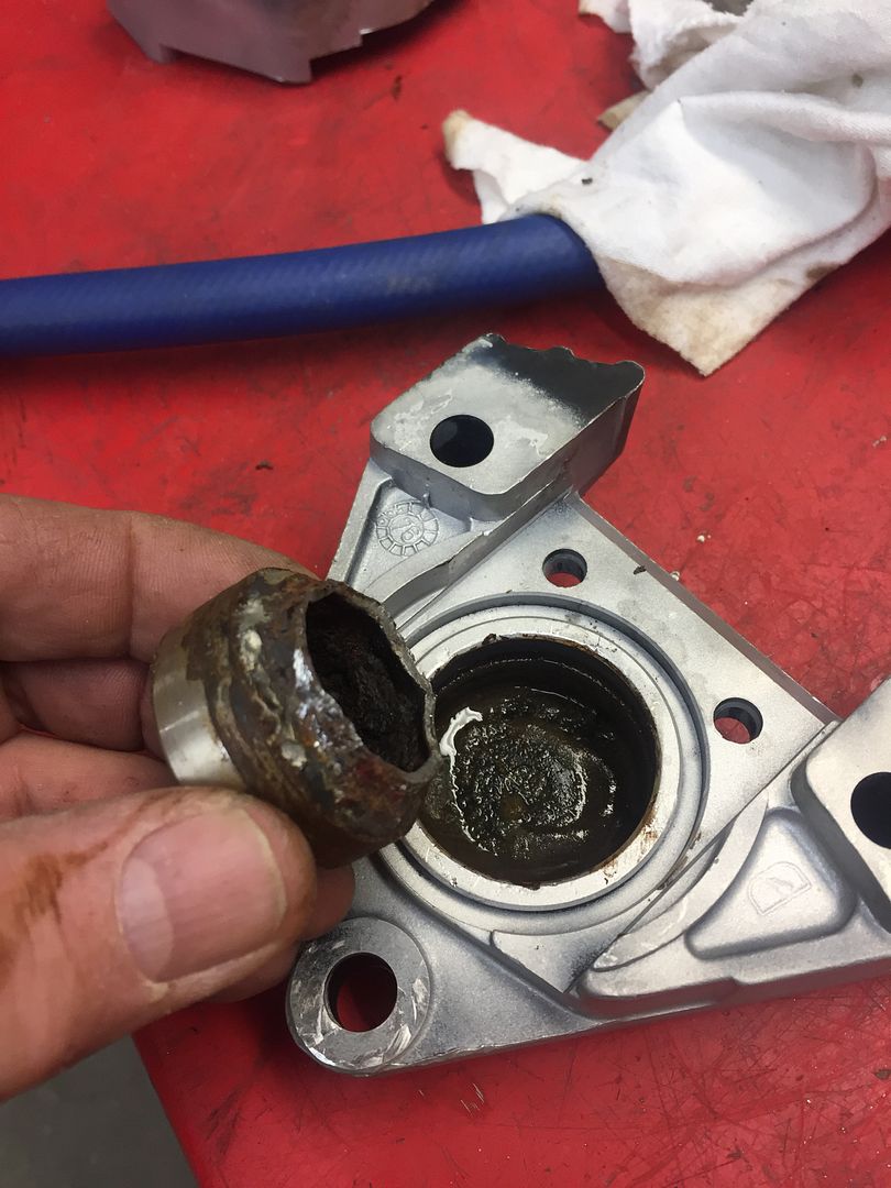

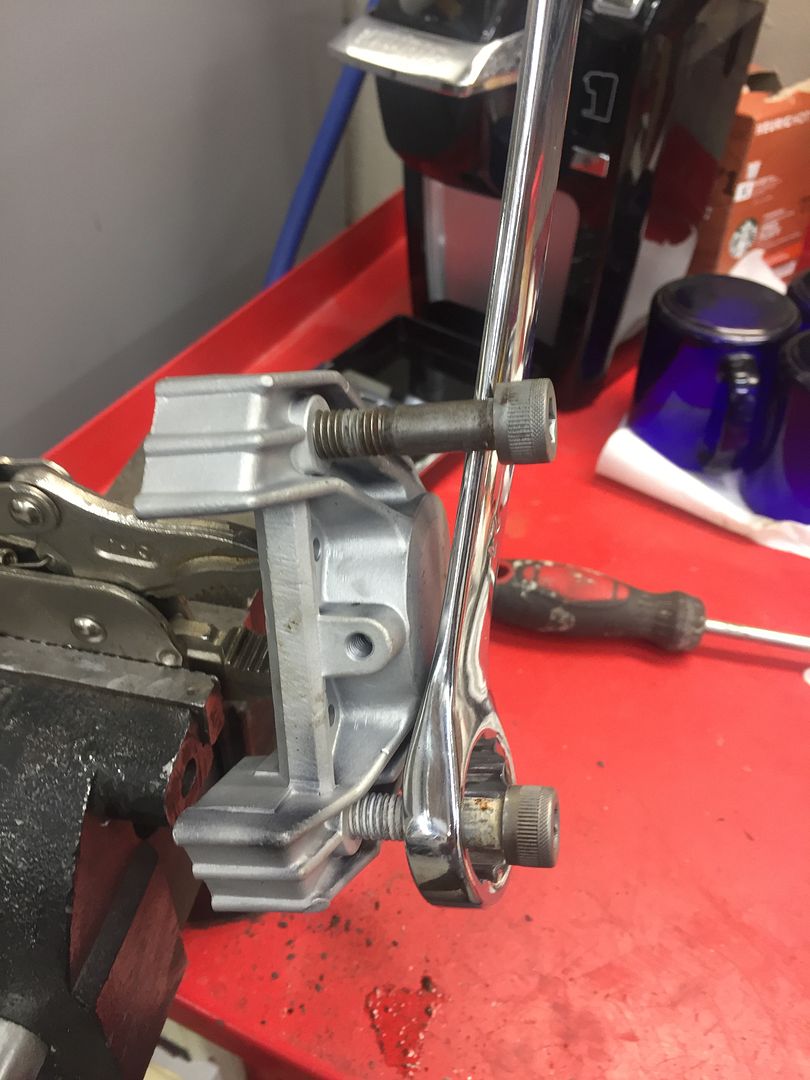

I am rebuilding a set of Brembo dual bleeder calipers for a project and found a used set with pistons that refuse to budge. Rather than welding a bolt to the piston and pulling it out I clamped the flange of the piston in a vice grip secured to a bench vice.
I spun the brake caliper joining bolts into the caliper and used a long wrench to grab the bolt heads and then rotate the piston back and forth until I could pull the caliper body from the piston.

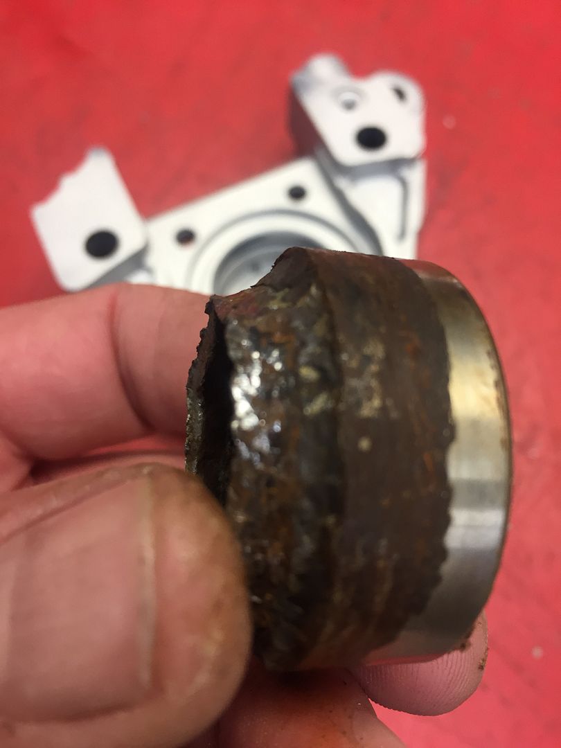

One seriously corroded piston
The opposite side body I just placed the bolts into the caliper pass through holes and used the same wrench technique
Removed the seal and vapour blasted the caliper body
To remove stuck bleeder place the caliper body in a vice, fit a 8mm wrench over the bleeder and take a brass hammer and tap down on the top of the bleeder while applying gentle pressure on the wrench to spin out the bleeder. If you tap long enough the bleeder will break free and spin out. The bleeder will be ruined but the caliper body will be saved.

WOW. Never seen one that bad before! Good job!

It's amazing the bore doesn't look worse.

That piston is pretty bad.

Good grief! That piston looks like it spent 20 years in a brining solution!
