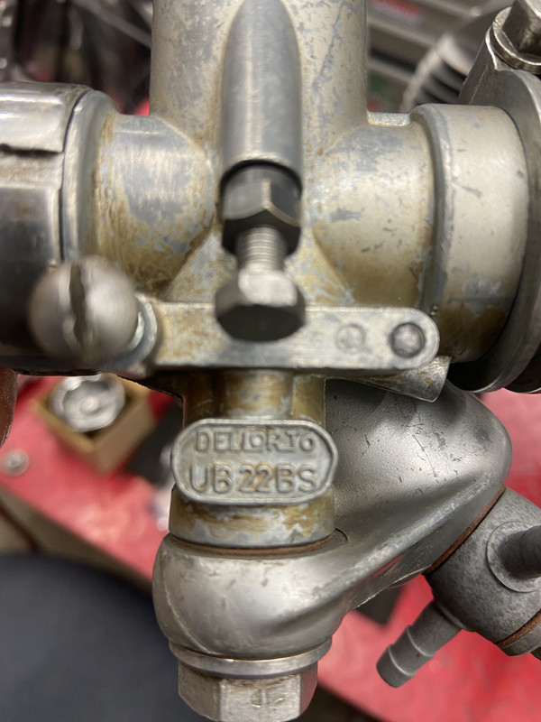

I got a very nice 22 mm Dellorto carb ( the 24 will go on my Aermacchi 250)

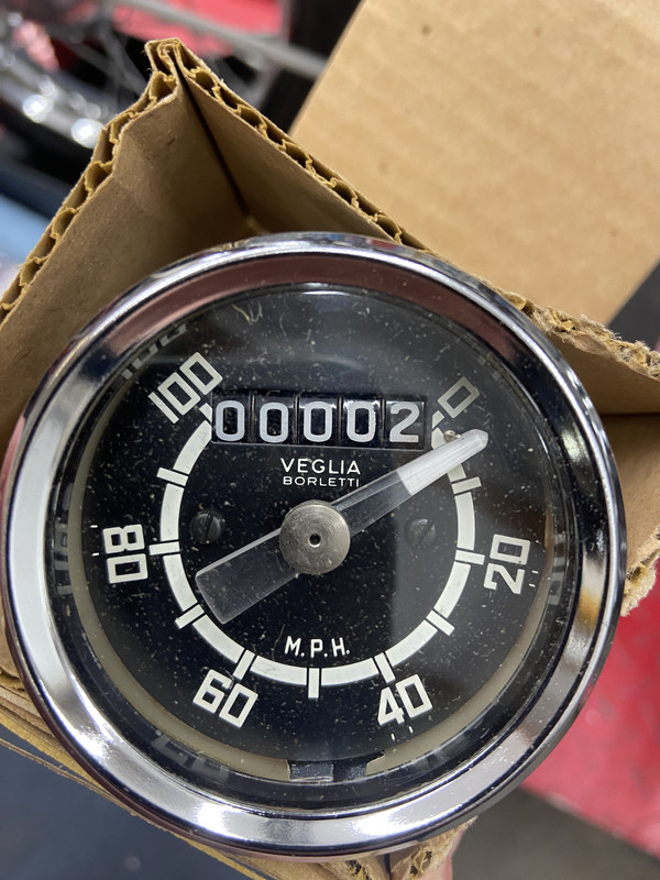

Installed the speedo today.

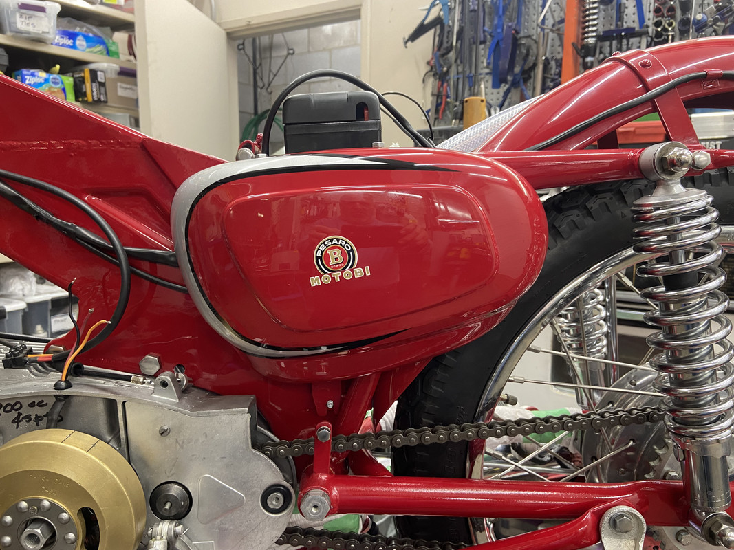

A bit more progress, I picked up all the parts from the painter on Tuesday except for the gas tank.
All is good except the side covers will need redoing, for some reason the painter applied the side cover decals off level (he had pictures of the museum bike in Pessaro)
 this ignores me to no end!!!!
Paint is pretty good, I wish I had insisted on the pin stripes being hand painted, they were going to be masked and sprayed but they ended up being tape stripes with clear over, not the end of the world but I am picky. I can live with it, 99% of the world would think nothing of it, it will probably bother me to no end.
