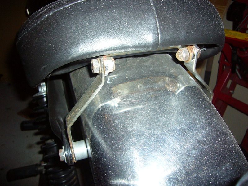

« Reply #6 on: November 21, 2016, 07:59:18 PM »
A few dollars flat stock and minutes with a drill and vice grips...
