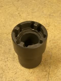

You must be talking about this one.  I purchased mine from Moto International back in 2001 or so.  They started out cheap and then the price was over $100.  MG Cycle shows them now for $35

Nah, the V11 bevelboxes are completely different to the earlier Tonti and early Spiney boxes. They have a weird two part split bearing with rollers and balls to take end thrust on the pinion and the pinion depth is controlled by shims under this bearing assembly between it and the box casting. The whole lot is secured in the box by a huge castellated ring nut that is done up hernia-inducingly tight, (Best bet is to stick some heat info the casting as you're trying to undo it or you'll bust your chuffer-valve getting it undone!) it's much larger and very different from the wheel spindle nuts.
Rolf, I can't post pics on the board at the moment but PM me yer email addy and as soon as I get the chance I'll dig the tool out and take a pic to send you. I have to go to Sydney to pick up a Griso tomorrow so it won't be until Friday at least.
Thanks John.
http://www.mgcycle.com/index.php?main_page=product_info&cPath=80&products_id=4515
I'll just buy the socket so some future seat sniffer can point out that it's still original.
Sorry I misread the post .....too early to read and comprehend.  This is for the front axle nut used years ago.  The "castle nut" reference make me think.... front axle nut!

...and not the same as the one for the one for the CARC swingarm?
Leafman's photo:
Vasco DG
Re: Seeking castle nut tool wrench)
« Reply #18 on: September 30, 2015, 04:06:22 PM »
Leafman's photo:
No.
Leafman's photo:
Thanks for the photo.  Jurgen
