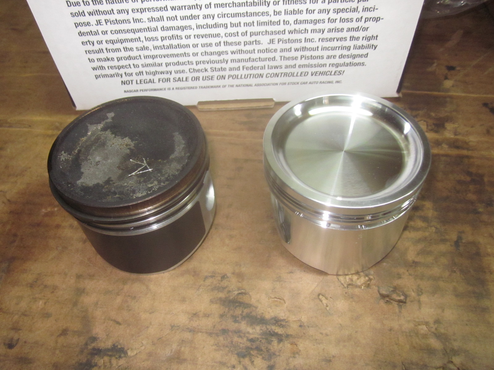

Meanwhile, I think the heron head Moto Morini 350 may have been the most powerful 350cc in the 70's, possibly even in the 80's (supposedly a bit over 40hp on the sport). I own a standard GT model, and there's definitely a big difference between it and a V35 Guzzi. Also got a Kanguro (enduro) model overbored to 400cc (but kept it at low compression), and I swear it seems to accelerate a lot better than my 750 Breva. Probably has a lot to do with the flywheel weight too... But if you go into theory, with two valves per cylinder, a Heron head has some advantages too (more squish, better burn, higher intake speeds...). My friend also raced with a 350 Morini, overbored to 500cc, with milled Yamaha R1 pistons inside, and that thing is just amazing for a 500cc two cylinder bike...
But of course, here's a stock morini piston:
And here is what a V7 uses:
I doubt a Guzzi is anywhere near as tuned as it could be, and there aren't many people who'd make decent performance parts for a heron setup.
« Last Edit: May 26, 2019, 01:17:38 PM by F-22 »

F-22,
Here's a picture of the V7 big bore (820cc)  piston from R.A.M. of Italy.  The valve cutouts here, and on the orig V7 are smoother and less abrupt than the Morini.  I think it's better, although I admire Morini's output and performance.
Joe
Joe
I just think a 750cc Guzzi with a Heron head could still easily do ~70hp, if a much smaller bike managed to make over 100hp/litre. Not sure what the big difference would be. I also heard the Morini engineers spent a lot of time on getting the ports just right. I don't think Guzzi ever really wanted to pull more performance out of those engines (except for the new V85TT, that one seems decent, although it has the new heads), and even the hemi head V7's aren't exactly high performance... They might have only went that way to make the engines more conventional, since noone uses heron design anymore.
