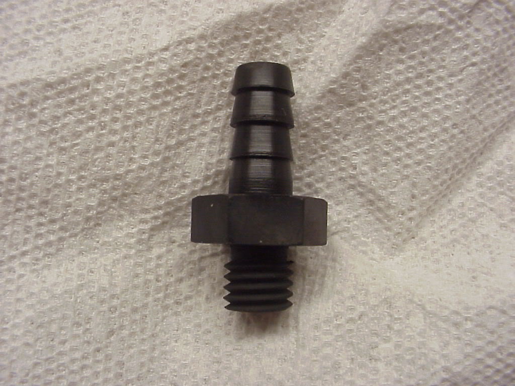

On earlier V50's I replace the crimped vent with a roll-yer-own breather fitting and run a vent hose up under the seat.  Simple to make if you have lathe access.
Patrick Hayes
Fremont CA

Oooh, Patrick! Having just blown through my crimped breather, I can see why you've made that fitting! I have no access to a lathe, but if I could buy one of those in plastic or whatever metal, I would do it. Correct me if I'm wrong: If I can take the drain bolt out of the final drive and the oil drains in a minute or so, my breather cap must be breathing. Right?
