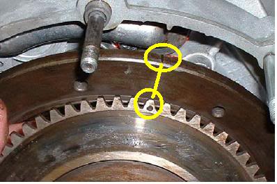

I have taken it apart and I’m doing it again. I did
notice that the dot on the spring plate was not in it’s correct position ?!? Let’s see what happens.
That particular dot is to line up the spring pockets.

« Reply #22 on: March 23, 2021, 06:01:30 PM »
If the dot is not in place, the springs will not be in the pockets. That may be binding it.

« Reply #23 on: March 23, 2021, 06:23:12 PM »
   The dot needs to be lined up for sure or it has no chance to work right. I happen to have a trans on the floor and the 2 pictures show it with the plunger flush and roughly 5/16" of exposed pushrod. Holding one finger on the pushrod and operating the clutch arm it moves back and forth with virtually no effort whatsoever. I'm sure that dot is your smoking gun. I assembled my clutch less than 2 months back for the first time in years and saw the dot and remembered it's significance but wasn't sure of the mark on the clutch so spent a while trying it in all positions till I was sure I had the right one and it was good.

« Reply #25 on: March 23, 2021, 06:35:11 PM »
I had seated the springs correctly even though I didn’t use the dot. What is the ball bearing ??? I’m gonna search in a minute, getting hungry. I did put a bb in the inner and the clutch budged just a bit.

« Reply #28 on: March 23, 2021, 07:11:22 PM »
The dot aligns with a faint line on the flywheel. If the that line has been removed by enthusiastic cleaning, there should still be an arrow (Loopframe flywheels) or a TDC (left cylinder) mark (Tontis) that it aligns with.

« Reply #29 on: March 23, 2021, 07:19:21 PM »
Now HUGE hint.  There are TWO sets of spring seats.  Once set is in the face of the flywheel.  The other set is in the back side of the pressure plate.  The two sets of seats have to aligned so that the springs will seat fully.  The only way to align the spring seats is to match the dot with the flywheel mark.  If you didn't do that, the springs don't seat properly, the pressure plate will not recess properly, and the clutch won't work. Try it again with proper alignment.
