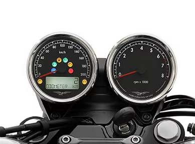

Thanks Dave. Another question: is there a gear position indicator on the 850 Special with the twin dials?
  • Posts: 4477
Re: Any changes from '23 to '24 V7s?
« Reply #3 on: June 02, 2024, 05:18:25 PM »
It appears there is a gear indicator.
« Last Edit: June 02, 2024, 05:22:06 PM by Dave Swanson »
Offline Buddy Shagmore
  • Posts: 74
« Reply #4 on: June 05, 2024, 05:16:18 PM »
Actually, there is no gear postion indictor on the Special. The dial above is showing the odometer. I went to the local dealer to check it out.
  • Posts: 31036
« Reply #5 on: June 05, 2024, 06:02:38 PM »
You know as you toggle through the menu the display changes.
On my V7III the gear indicator isn't visible in some of the displays but is there for others.
Also, I forget, but it won't show up in certain operating conditions, like clutch lever pulled in. I forget if it shows (other than neutral) if the engine is off.
« Last Edit: June 05, 2024, 06:03:24 PM by Kev m »
« Reply #6 on: June 05, 2024, 08:37:12 PM »
Dave is correct; all display modes except odometer on my '23 Special

That system has been left behind.  The new system does not depend on matching rpm with running gear to provide gear notice.   The new system will indicate gear, even when clutch is pulled.
New for 2024?
My 2023 V7-850 SE calculates the gear based upon speed vs RPM.
Hence a slight delay in indication and does not display when stopped or clutch disengaged.

« Reply #11 on: June 09, 2024, 06:17:38 PM »
I am curious about this too. If there is an actual gear position sensor on the 2024, I would be interested in what it would take to retrofit that to my 2022 which has the same issue as many other bikes where it calculates gear selection based on rpm & speed.
  • Posts: 31036
« Reply #12 on: June 09, 2024, 07:45:00 PM »
1. If there's an actual gear position sensor it would likely mean a change to the shift drum or cam at minimum, but it's also likely the case itself or a cover might have a difference to mount the sensor. Then there's the sensor and harness, as the harness would have like 5 additional wires.
2. I take issue with the term "issue". First, I've owned so many bikes without a gearshift indicator just having a bike with one that isn't instant or precise in all circumstances isn't any issue at all. And second, if you have one WTF does it take to just realize the times it doesn't read or read accurately and just adapt? I mean crap, oh it says in still in 4th but I pulled in the clutch and downshifted a few times, whatever will I do if I'm not sure if it's 1st or 2nd (I dunno, F'n try to shift down once more and I'll know for sure?)
Obviously I think it's folly to even give a crap.
« Last Edit: June 09, 2024, 07:47:15 PM by Kev m »

Really I doubt the change was made for the 2024 model as suggested, but if it is that's a nice improvement.
The issue is not the lack of gear indicator, the issue is having a gear indicator that at times doesn't actually display the selected gear. IMO it's a poor implementation to have one calculate the selected gear, rather than use a sensor to pick up from the source of truth - the physical gear selection at the shift drum. It would be less of a complaint from me if they had omitted the gear indicator and stuck with just the federally mandated neutral indicator light.
  • Posts: 31036
« Reply #15 on: June 10, 2024, 05:56:05 AM »
Isn't there a N light too?
I don't think I've ever seen a bike that had an indicator but no light?

Yes, there is an N. light.
I have a 22 and a 23 and have never noticed the issue. The flippen tach is supposed to be you're gear indicator! If it isn't above 3500 and below 7600 you need to shift.
L-196, L-197
  • Posts: 31036
« Reply #17 on: June 10, 2024, 07:57:22 AM »
So, and forgive my continued bluntness, then what's the problem with just ignoring the indicator and using the N light?
This reminds me of the complaints I'd hear a couple of decades ago when EFI bikes started popping up. People would bitch about the lack of "reserve" and/or lack of a fuel gauge. But nothing had actually changed from the decades of bikes before that used a petcock with a reserve setting.
Reset trip meter at each fuel up. Watch miles and wait for reserve light... refill and not mileage/usage. Eventually you get a feel for it.
OK, in that case there was ONE tiny difference, if the fuel reserve light failed you would then have to notice the light hasn't come on when past the usual mileage and investigate. On an EFI bike if you get the bucking bronco feeling it's too late. But again, easily avoided.

« Reply #27 on: June 10, 2024, 02:56:31 PM »
If they are a motorcycle sold in the USA and don't have a transmission that's considered to be automatic or semi-automatic, then other than some exceptions the neutral indicator is required per the NHTSA enforced Federal Motor Vehicle Safety Standards (FMVSS). Same reason fully manual bikes in the states have 1st gear at the "bottom" relative to the toe action, standardized requirements.
You're likely onto something with beginner and budget bikes having it, but then I find that though many mid-tier bikes lack it, top spec bikes nearly always have it. But hey, so do MotoGP bikes, and they're not staring at their screens too much while riding.
Sure, will let you know - though I remain doubtful that MG made those changes to the V7 for 2024. Perhaps bad Chad was referring to a different model than the one this thread is about.
  • Posts: 4336
« Reply #28 on: June 10, 2024, 06:04:50 PM »
Let me see................ .66 now, had motorbikes of all kinds since 9 years old, and snowmobiles before that.  My family was a dealer.
Did I manage without gear selectors, quick shifters, tpms, cruise, and a whole bunch of things?  Yep.
Sure, I get it.  Tech moves on.  So much so, we now get warning NOT to drinK battery acid.
Online Moparnut72
  • Posts: 2835
  • Location: Quincy California
« Reply #29 on: June 11, 2024, 08:11:20 AM »
I have a V100 which has a gear indicator. I find it to be useful on this bike because it is quite powerful and has such a wide power band that it is sometimes nice to know which gear I am in especially when I am about to make a quick pass.
