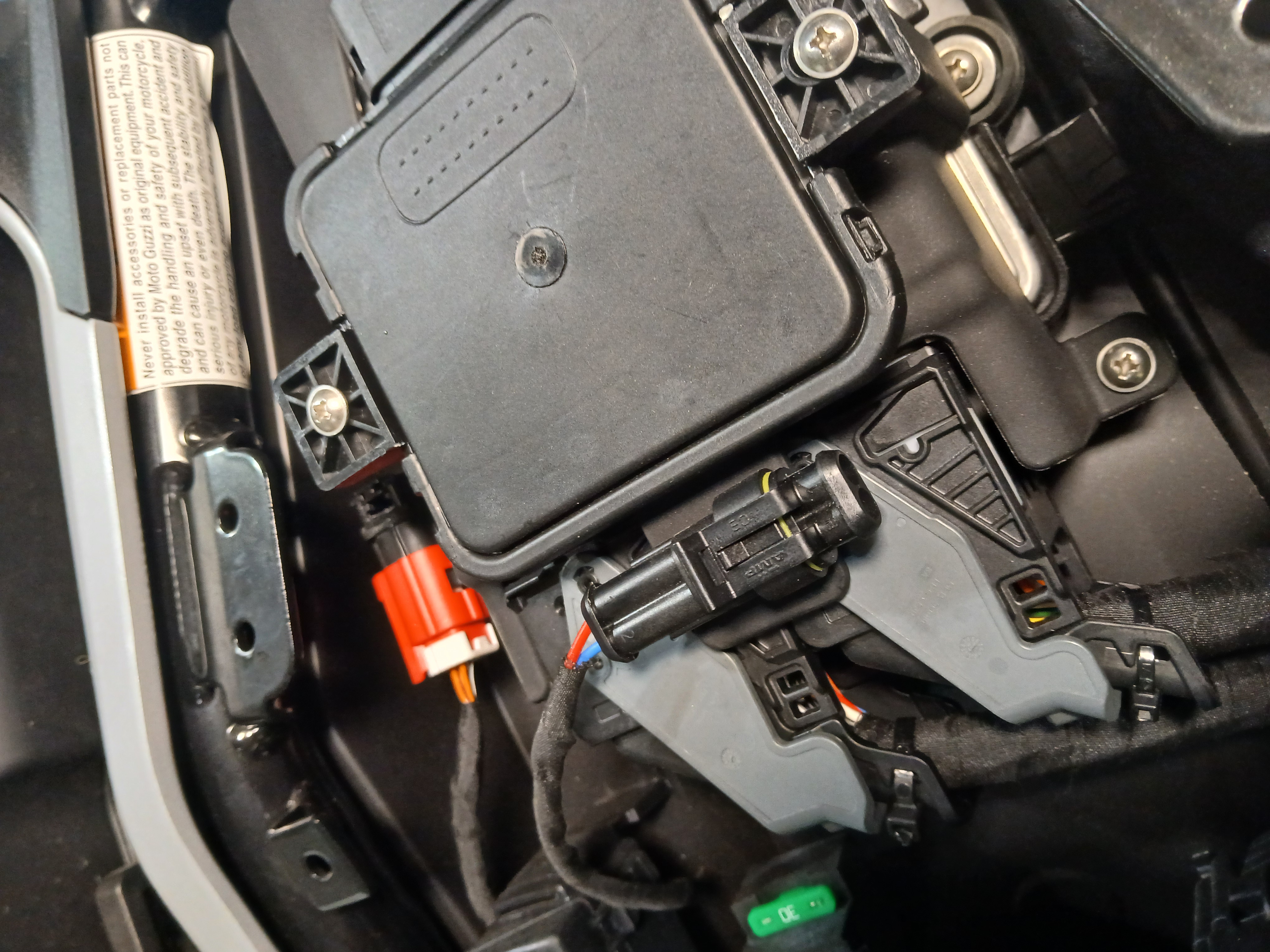

« Reply #5 on: September 11, 2026, 07:11:57 AM »
Here is a pic under the seat.

« Reply #6 on: September 11, 2026, 01:01:32 PM »
you have it, its that square box with big cable
likely just needs a quick setup at a dealer.  Somehow set to off from MG, or got set to OFF if the map was updated at PDI

« Reply #7 on: September 12, 2026, 08:22:48 AM »
I thought the sqaure box was the ECU, looks like the ECU on two other bikes I have owned. Is there any way to get the TPMS turned on without the dealer? Closest dealer is 340 miles away.

« Reply #8 on: September 12, 2026, 12:08:01 PM »
Here is the TPMS module on an E-5. Not sure about the E5+ but from Ed's picture it looks very different.
