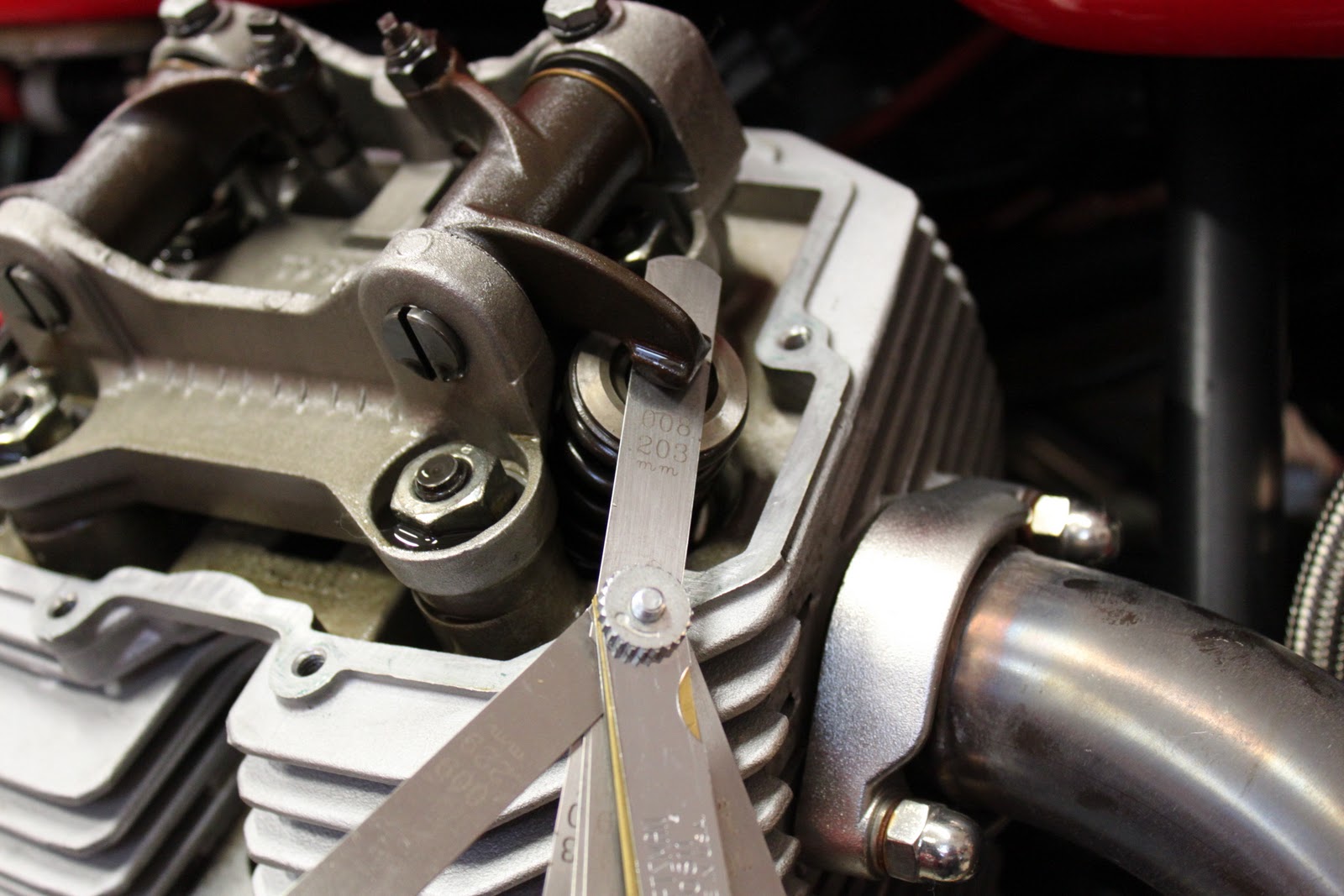

Well, every skilled tradesman knows that “There’s never enough time to do it right, but always time to do it over".  ;D I originally thought that I’d just do a quick check and see if the two cams were similar. No real need to do it right.. but I wasn’t getting repeatable results.
So I decided to do it right this morning. Made a piece that fits over the indicator shaft with a tiny cone on it that will fit down in the oil delivery hole in the pushrod to keep everything centered. While I was at it, the indicator itself was sticking from old lube/dust in the air, so I took it apart, cleaned it, and put a drop of MMO on the works.
Rumba mentioned downloading a degree wheel to print, so did that, too. It just happened to be the right diameter for the piece of bakelite that I’d turned for my quick and dirty degree wheel. I’d rather be lucky than good…  ;D
Now, let’s get started doing it right. I should remind you that *I've never done this before* but it’s typical machine shop work. I’m following Martin’s instructions as best I can. Thanks Martin!
Let’s walk through doing one cam lobe.
Removing the bolt lets the pin that holds the rocker arm slide out.
It is a very robust valve train, nothing like the dainty Lario.
We went over finding TDC yesterday, no need to restate that. Set the indicator at 0. It will now be on the base circle of the cam.
Rotate the engine until the indicator reads .050” This is when the valve starts to open. Read the degree wheel. Here, if you look carefully, you will see the indicator on 50 and the degree wheel at 9 degrees BTDC.
Continue turning in the direction of normal rotation until the indicator shows max deflection. This is total lift. Naturally, I forgot to take a picture, but it is .255 inch. Now, we want to find that angle, so back the flywheel up past .245, then normal rotation to .245 and read the degree wheel. Here, it reads 81.
Continue turning past .255 until it starts down and stop at .245 again. Read the degree wheel.
132. So 81 plus 132 divided by two is 106 degrees. Max lift is .255 inch @106 degrees ATDC. Gots it?  ;D
Now, all we have to do is keep turning in the direction of normal rotation until the indicator is at 050 again. Read the degree wheel at 44 degrees ABDC.
One other thing. Martin said to check overlap at TDC, so I assume that means the TDC where rookie Guzzi mechanics mistakenly set the valves.  ;D That’s .073” on the indicator on this one.
That’s basically how it’s done. It’s the first time for me, and I know “I” learned a lot. If you have never done it, hopefully you learned something, too.  :D
Here’s the specs:
Lario:
Exhaust Opens 45 degrees BDDC Max lift .234”@73 degrees ABDC. Closes 10 degrees ATDC. Overlap .077 at TDC
Intake Opens 8 degrees BTDC Max lift .234”@ 106 Degrees ATDC. Closes 45 degrees ABDC Overlap .073 at TDC.
Aero engine:
Exhaust opens 44 degrees BBDC Max lift .255” @ 72 degrees ABDC. Closes 8 degrees ATDC. Overlap .075 at TDC.
Intake opens 9 degrees BTDC. Max lift .255 @ 106 degrees ATDC. Closes 44 degrees ABDC. Overlap .073 at TDC.
Other than .021” more lift, they look quite similar to me. There is no doubt some slight error reading the very small degree wheel, but not much, I would think. One degree one way or the other doesn’t sound like much to me but “I know nothing.”  ;D  Maybe someone that does will chime in.

In 106 Ex 107/108 sorry if I said it backwards but are timed neatly, you could advance it 2 deg but no more IMHO,
MH
  • Posts: 29701
Re: Aero engine rescue
« Reply #259 on: November 28, 2014, 06:49:32 PM »
Me ? I'd run aero cam to try it, 021" is relevant, they went to the trouble of making special grind,
Agreed. But..I'd have a lot of money tied up running it as is. Roughly $400 for ignition, probably a couple of hundred *at least* for a tach. I can get a V65 cam ground for considerably less than that.. *and* I'd still have my white faced Veglia.  ;D ;D

  2mm more lift and 10 deg more duration is what I'd be looking at if I were wanting to have something that made power a bit higher in the rev range but was still decent to ride (and it'll idle too). I'd reassemble what you have with the aero cam and light "checking springs", add the extra lift via the adjustment screws, and rotate the engine as Martin says to check for clearances at all points near TDC. I'd even add a bit extra lift to mimic the extra 10 degrees  of duration since what that will do is get the valve open sooner and closer to the piston. This will get you an idea of what you are dealing with....if you have a mile of clearance then great! If things are close then more careful steps will need be taken. I like the thought of more cam in this one!
   Terry
'07 CalVin

« Reply #261 on: November 28, 2014, 10:05:44 PM »
Ed knows his stuff here. I'd trust him on the cam advice. This is what he does.  :+1 on the Veglia white face!

« Reply #262 on: November 29, 2014, 12:47:44 PM »
One further thought on the cam issue.
The performance criteria for the drone motor would be very different to a motorbike. My guess would be that apart from take off the major criteria would be good fuel economy at one constant engine speed. There is also the matter of air density changes due to altitude, much easier to deal with with FI but since this beast is going to run carbs and need flexibility and altitude changes will be less of an issue it might well be that one of the motorbike engine camshafts would be a better bet.
Just thinking out loud.....

« Reply #263 on: November 29, 2014, 01:13:20 PM »
10 degrees is not that much , but 2 mm extra lift is a significant difference.
you might get into trouble with valves touching each other, or the piston
one modification causes another.
i would just add a revcounter drive to the original camshaft.
having said that , you are the first one fitting a aero engine to a bike , so you might as well be the first one who tunes the aero engine.. ;D

« Reply #264 on: November 29, 2014, 01:28:48 PM »
I would expect lift in a 2 valve hemi to be higher than a 4 valve Lario, or.a Heron engine.

« Reply #265 on: November 29, 2014, 03:27:51 PM »
It would be cool to run all the original parts together so that's my vote......not that I get one ~;
I think it would be cool to make a ground pounding small block out of it.. ~;  either that or a mild (but considerably more powerful than what is currently offered) street engine. Haven't decided yet. I get the last vote.  ;D
I think you can achieve that with just a stock V65 cam. Hemi heads gotta' flow better than the Heron heads. <shrug>  ;D
   Terry
I wouldn't add lift  via adjusters, very solid way to check, you're waiting to hit
I use dial gauge to measure what clearance I have, if trying an unknown I'd rather give extra clearance first, then measure till it hits

« Reply #269 on: November 30, 2014, 06:39:48 AM »
Ed thinks that unless I want to go "full Monty" on it I just might as well put a V65 cam in it and call it good.
