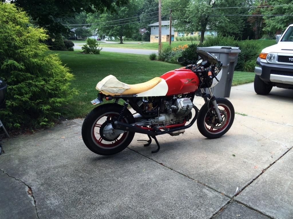

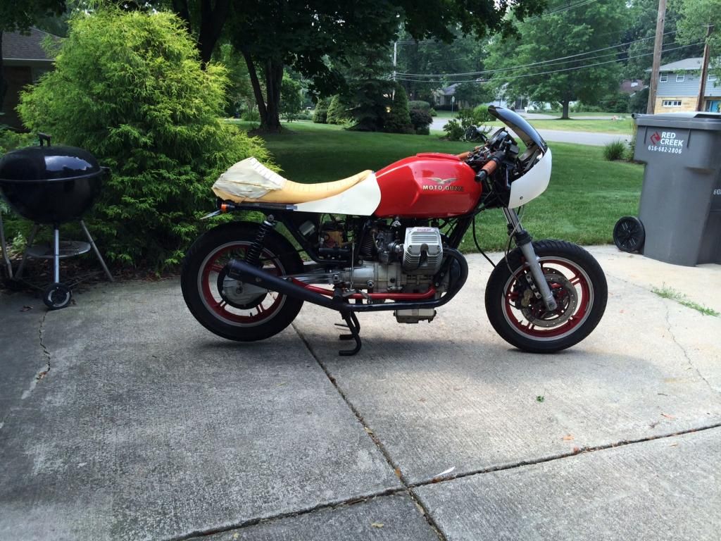

More seat work today to work on line.  I wasn't liking the straightness of the tank to seat transition, so upon suggestion of my friend I came up with this.  This will be upholstered over of course in either black or tan.  Or I may go with a black and tan seat.  Suggestions welcome.  Thinking seat area tan and the cowl back and sides and seat sides black.
« Last Edit: August 03, 2014, 02:24:36 PM by kevdog3019 »

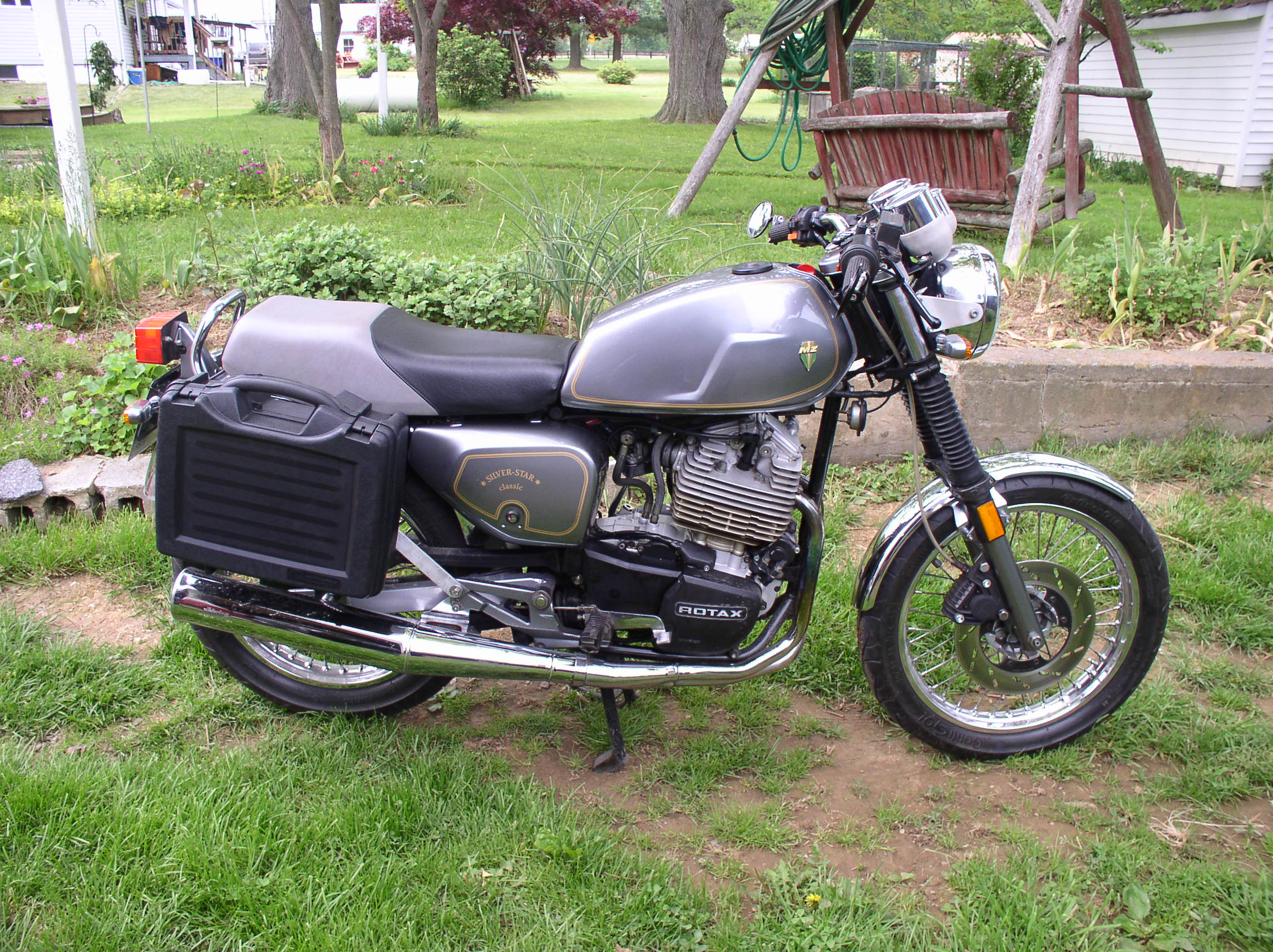

That second photo appears to show that it has a dustbin fairing! ;) ;D
Watching the thread with interest. ;-T

Good eye with that pic!  A little slow going here as I'm busy with work and having to ride this monster. I rode my V11 Lemans yesterday for the first time in quite awhile and thought I'd never say this, but this super Lario is WAY more of a hoot to ride. Stops better, handles better and the engine/carb set-up is more instantaneous in delivery. I feel much more connected to things. Little scary at first how disconnected/vague the Lemans felt overall. Never felt that way before.  The build will be slow to finish as I need to think before jumping into it. Riding it now is the main goal while the weather is ripe. This winter I can get a lot of the small detailed stuff done like hiding the bits in the battery compartment. Will try to get the front fender worked out sooner rather than later also.

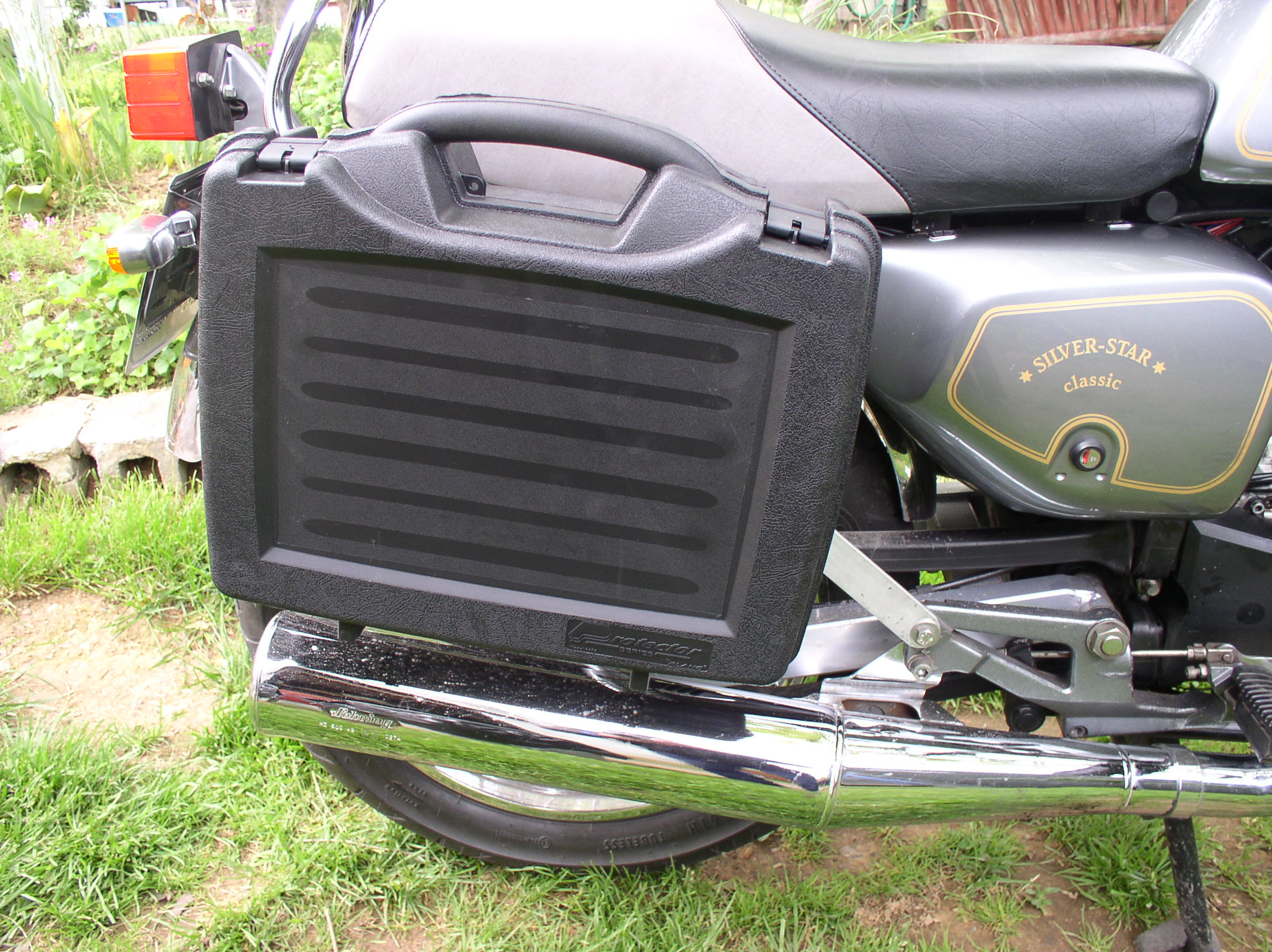

I've actually considered plastic ammo boxes for a set of hardbags. Plano makes one about 10 x 15 x 8...maybe just a little too small for round the world trip but good enough for the week. Next size up is maybe a little too big.
http://www.midwayusa.com/product/211622/plano-medium-field-box-15-x-8-x-10-polymer-camo?cm_vc=ProductFinding
The fact that these are top openers is very attractive to me as well as the price...less than $20. I figure esay enough to fabricate a lean and mean rack.
  • Posts: 15236
Re: "Super" Lario build started (long ride report 6/3)
« Reply #106 on: August 06, 2014, 12:57:27 PM »
Haha....very cute...
If you don't mind side-loaders, Plano also makes these nice hard cases, available on eBay for ~ $50 a pair.

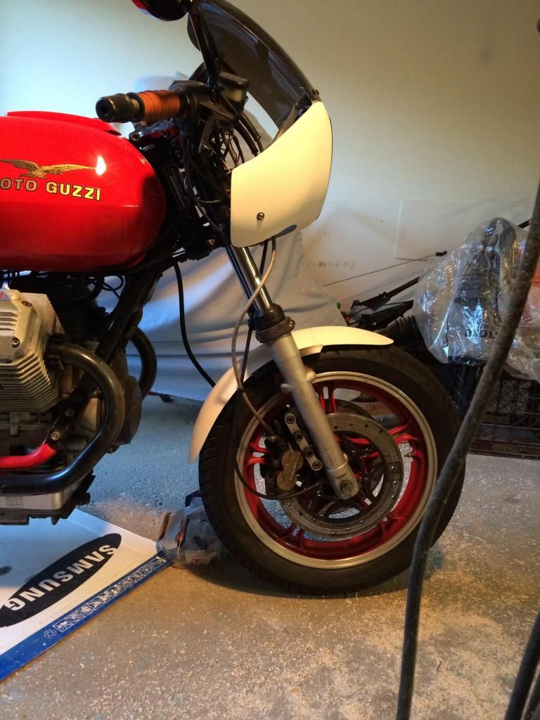

Getting around to the front fender now. Slimmed it down and cut it to length but need some feedback as to length front and back. Looking about like the stock LM 1 at the moment (length). At this length it is very practical and I'm a fan of the LM 1, so...
« Last Edit: October 07, 2014, 09:12:25 PM by kevdog3019 »

I like the fender length and style as pictured.  I'm also anxiously awaiting pictures of the finalized seat.  Have you made more progress on that?

Good question Raoul.  I am talking to Corrina in NY as an upholsterer.  I think the seat is most important now and have been trying to wrap my head around style, materials and colors.  I have to make up fix up the seat pan next then send it out.  I want it done sooner rather than later also so I'm with you in the anxious department.  Thanks for the comments on the fender.  It's taken some getting used to with a fender sitting on it at all.

This is why I like feedback. Just talked to my friend and he suggests a small fender since I'm going fender less or (possibly) small fender in rear (some day??).
Anyhow, I've come to the realization that the bigger picture looks better with the small as he suggests. You can see the line scribed about 6" rearward of the forks. This is where the cut would be made. Look ok to your eyes?  Smaller?

When I cut my front fender, I will leave the front as is and make the rear the same length as the front.

Re: "Super" Lario build started (final carburation 9/20)
« Reply #116 on: October 08, 2014, 02:32:23 PM »
This is equidistant both sides also.  It will be red like the bike and not stick out so much, but wondering if smaller yet might be nice?

Not sure if you've experienced a front fender that's short at the rear, but you'll get a lot of road dirt on the engine and up under the gas tank, especially after a rain.

That is pure personal taste.  I think stock front length and equal length rear are pretty much the minimum cut.
Also the easiest because you only have one cut  ;D
Once it's done and I have the seat and tank mounted I will look at it and see if I still like it.  It's easy to make shorter, harder to make longer.
Oh yeah, well aware of the negatives. My conundrum is aesthetics. Is it weird to have traditional at the front and nothing on the rear?  If I deviate, I have a splash of color at the front (red fender bobbed) and it becomes useless from a functional standpoint. Hmmm...
