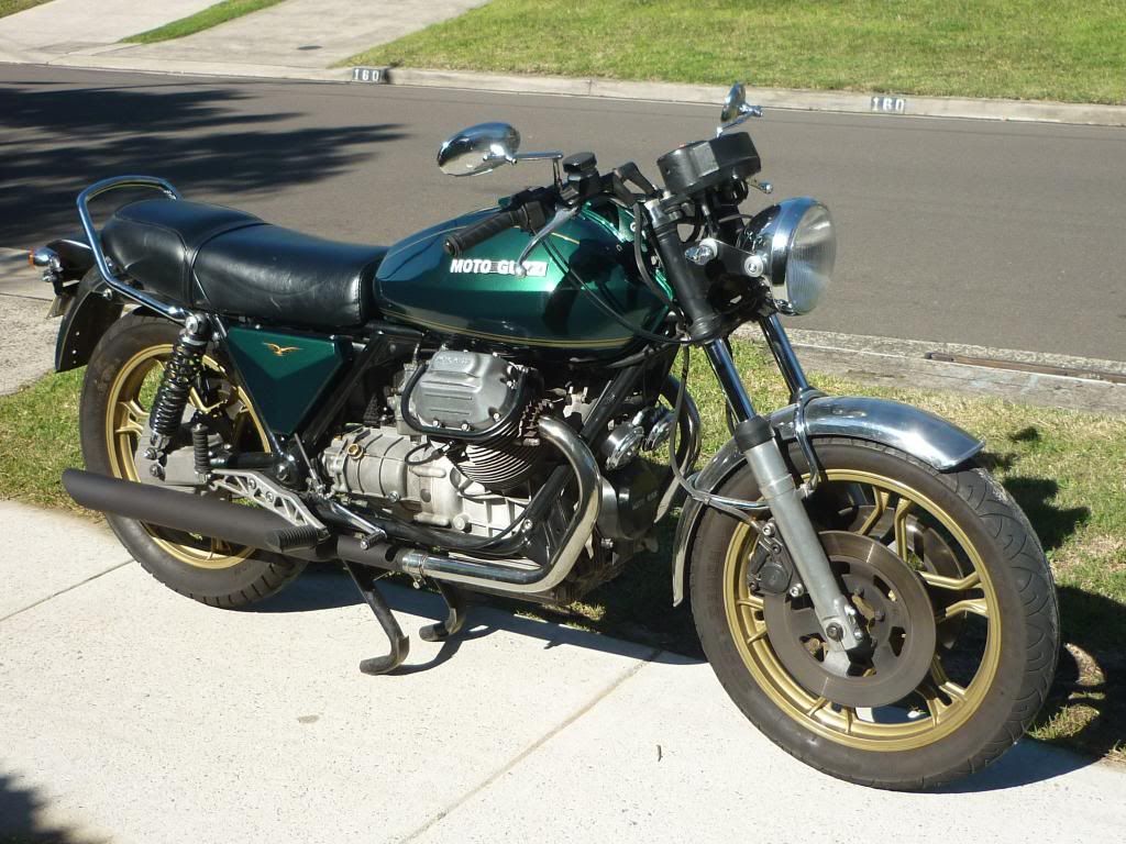

OK here is a picture of the cast wheels on the bike. A 1981 850-T4 - naked.

  • Posts: 20022
Re: Can I Fit Tubeless Tires to Factory Cast Wheels?
« Reply #3 on: January 20, 2014, 07:00:51 AM »
yes, you simply need to go to hardware store and get a tank valve, it comes with a thread tap. you tap threads into the existing hole in rim.. from inside out, don't run it completely through so it is slightly tapered (from the inside). you might need teflon tape to seal it, I didn't.
some will say the bead lip on your rims was not made for tubeless rims..
 Many have ridden thousands of miles anyway, I never heard of any problems with the tires staying locked on rim.
I used Pirelli Sport Demons.

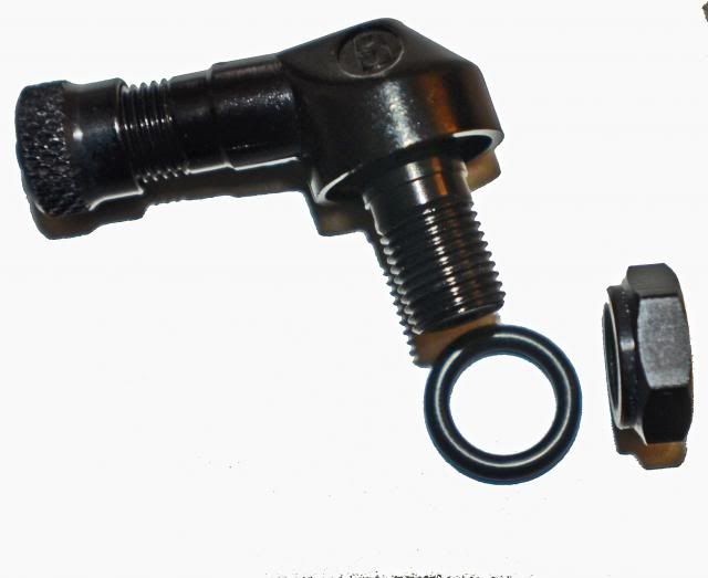

Looked at the valve from Harpers and I can source a similar one in the UK.
Take it this is the one mentioned:
 http://www.harpermoto.com/tubeless-valve-stem.html
Bearing in mind the concave shape of the internal surface of the Guzzi wheel,
does the rubber seal sit nicely in place without the nuts being done up excessively tight?
« Last Edit: January 21, 2014, 03:40:17 PM by Stevex »
I don't have a rim too look at (accept in my memory) but I don't think so..
As mentioned I have used these on my Converts in addition to my current Cali II Auto, all three had the OEM alloy wheels.
« Last Edit: January 21, 2014, 04:25:34 PM by gwb_mg »

Yes, but at speed, centrifugal force is keeping the tank valve in....   8^))    (while true, just kidding as a safety net)
Also, most of the tank valves I have seen are chrome plated brass. So you are talking galvanic action between a cupric alloy and aluminum, not steel. Plus, once oxidized, aluminum will form an oxide that does not continue to erode. I sincerely doubt this is as bad as a steel/copper union in your house plumbing which will corode until you have a leak. There you have a medium which is continually scouring the junction and removing any protective oxide coating... Here, the junction is protected...
I am going to say this as politely as I can but I just don't think you know what you are talking about. Sorry.
I agree.  And galvanic action with chrome/brass and Al will be very slow.
And, if the threads do give up you can always get one of the rubber washer types  :)

The stem is going to blow out do to the sudden increase in pressure when you hit a bump in the road a speed.  Tire pressure is going to decrease very quickly and you are going to be in for a ride.  With luck the tire bead will remain seated.  As stated in a previous post this is a very clean conversion, but now that I know what a tank valve is, I wouldn't trust it.  There is a reason this system is not used through out the industry.

The rims in question have a recess cast so there is a flat spot for the rubber washer to seat against.  And, no, it doesn't take a ton of torque on the nut to seal it.  The only issue is the size of that recess is not very big.  Like I said above, I had to turn down the dia of the valve 'flange' to fit that recess.
:BEER:
Matt
Nothing you have said or the manner in which you have said it conveys to me you have any expertise in this area. You learned about tank valves 2 days ago and now you are an expert? Do you know chemistry? I was in the top of my class as a chemistry major at U.Mass. Do you know physics? I went on to study Physics in grad school, and have worked in advanced research for over 35 years. Can you calculate the galvanic response between bronze and aluminum? (about .5 volts by the way, not that it matters here). Can you use boyles law to calculate the rise in pressure due to hitting a pothole? Did you check to see if that pressure was higher than the design pressure of the valve? Do you know how to calculate how strong a thread is? Have you stopped to consider that even if you could hit a bump capable of expelling the tank valve, you would have bigger issues than a flat tire?
And most importantly, do you have over 30 years experience using tank valves in Guzzi wheels? Without a body of experience or the intelligence to put them to rest, your fears might be justified, but seriously scores of these wheels have been converted, millions of miles covered, hitting bumps and potholes, raced, crashed, bent, straightened, welded up, raced again. Some of us without a body of knowledge to go on, risked our lives to create this body of knowledge. It is irrefutable. You can choose to ignore it or not believe it. Fine, go away and shut your mouth, but when you say "don't think you know what you are talking about. Sorry", you got that half right, you are a sorry excuse for an engineer.
