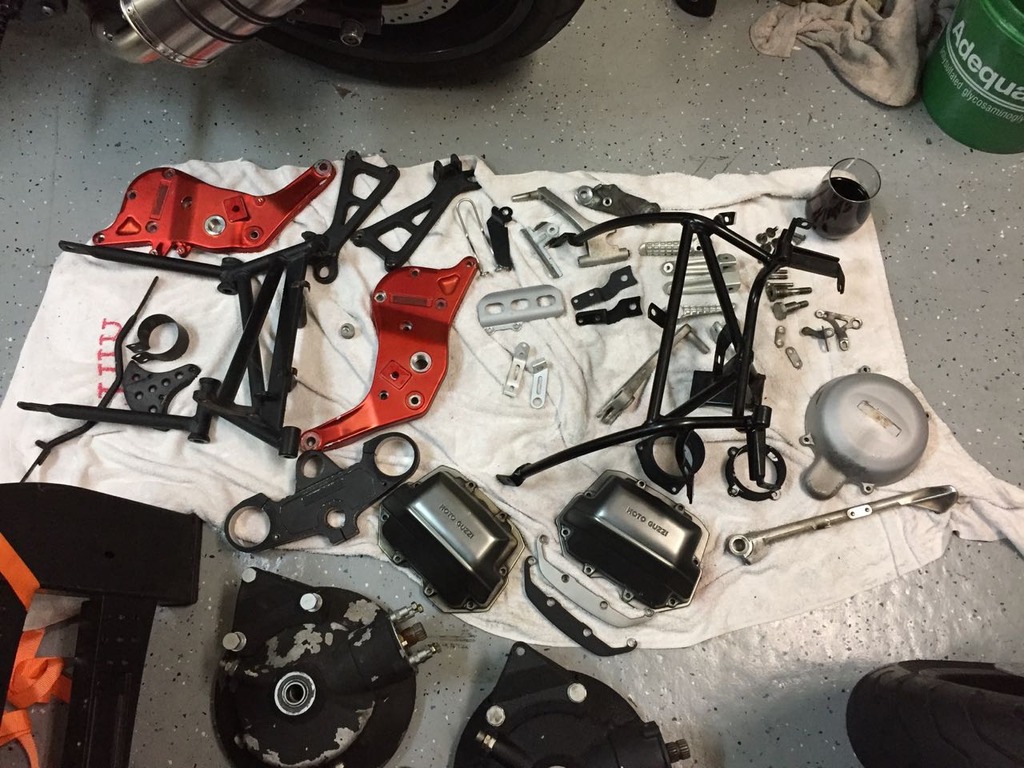

time for powdercoating...

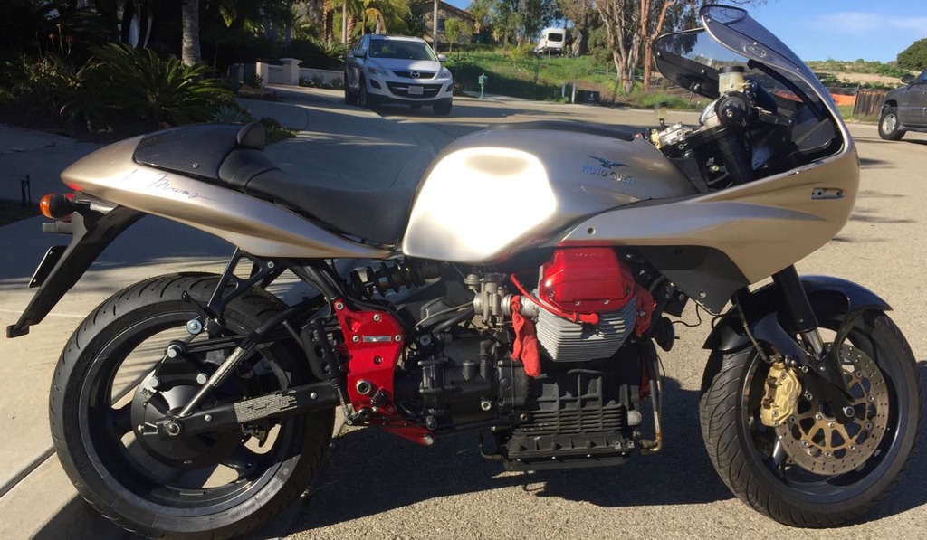

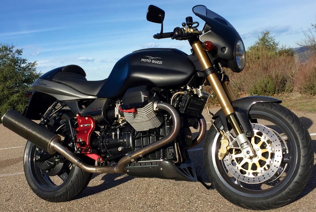

No, the Scura is all back together. This is a continuation of Joe's project - his champagne LeMans, which I purchased mid-project when he moved to Germany.
Here is a gratuitous Scura photo: with repainted driveline, lots of powdercoating and other extra darkness:
I'm not going to this extreme with the Champagne... (for example, I will not be splitting and repainting the transmission) but I want to freshen it up and enjoy it for a month or two while I try to sell it.

  • Posts: 29660
Re: Unkept's V11 LeMans Repair, Maybe Restoration, Thread
« Reply #246 on: January 13, 2017, 10:59:04 AM »
That's bad to the bone..  :smiley: :thumb:
« Reply #247 on: January 13, 2017, 01:00:04 PM »
Mmmmmm...I wouldn't kick THAT outta bed for leaking oil or eating crackers! Very nice... :bow:
Thanks. But I did kick her out for leaking oil - and for blowing bubbles in her engine paint. She was flowing oil out the timing cover, the cam sensor, and the transmission. Messy, messy... but she can eat crackers wherever she wants...

« Reply #250 on: January 13, 2017, 09:04:05 PM »
Tim,
That is a gorgeous picture; real V11 porn !

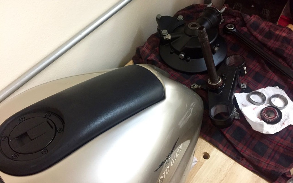

Progress report....

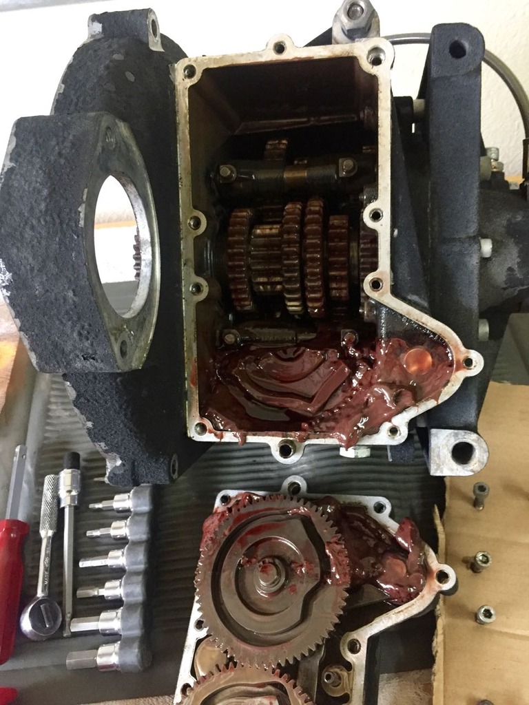

Powdercoated fuel door. Painted final drive and reaction rod. Steering bearings are shot and need replacing.
Transmission was filled with blood-pudding.

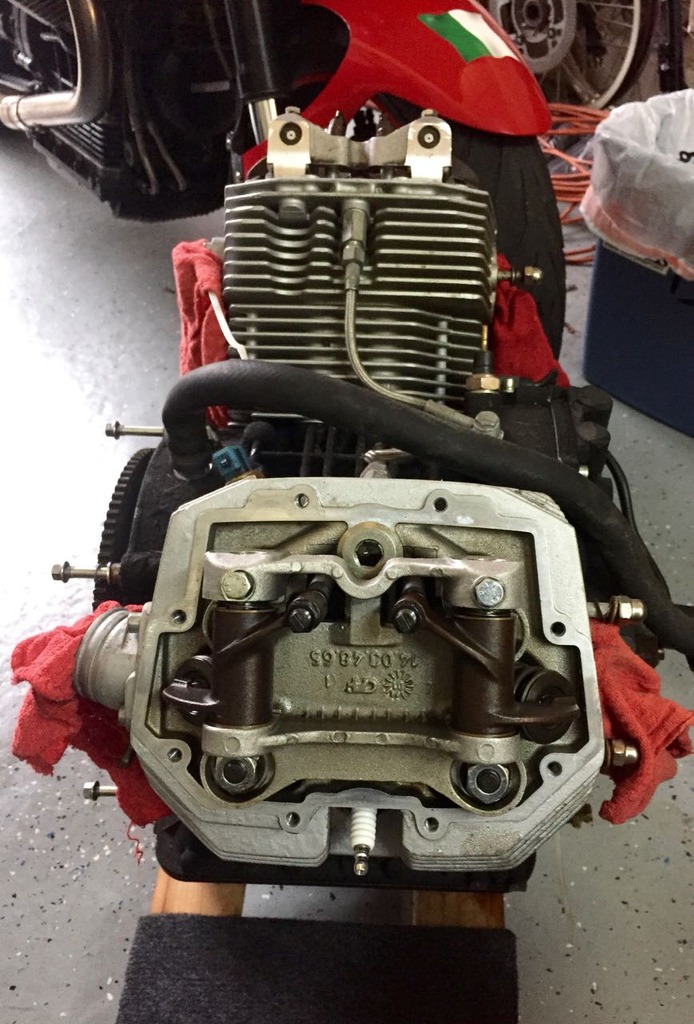

And I got the engine ready. This engine is from a crashed parts bike I bought a while back. It only had 12,000 miles on it.
« Last Edit: July 06, 2017, 12:00:23 AM by Scud »

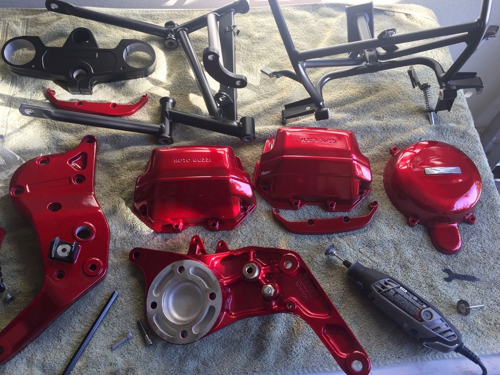

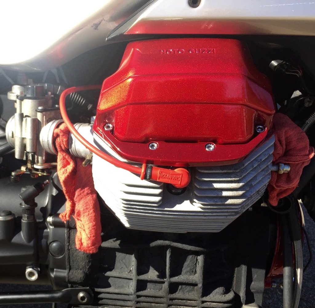

Got the powder coating back yesterday. Chasing threads and overspray today...
« Reply #256 on: January 28, 2017, 03:34:02 PM »
LOVE the red!  :thumb:

 :1:.   :thumb :thumb:.   What type of paint?

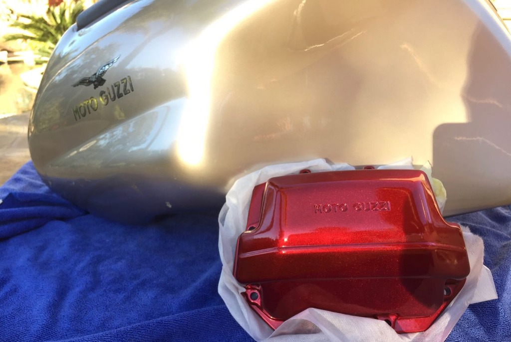

It's powercoated candy-apple red. First they bake on a coat of silver flake, then they do a second coat of translucent red. It's so cool in direct sunlight.
I also got a bunch of stuff done in flat black - in this picture you can see lower subframe, foot levers, pegs, rear brake master cover.

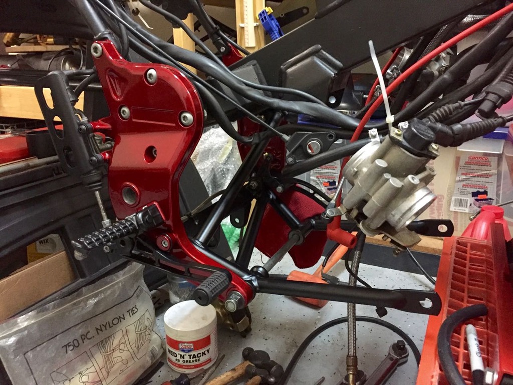

Here's the before and after of the controls. I'll probably end up prying those Veglias open so I can paint the needles...
upload pic
...and where the proverbial rubber meets the road...
Note to self... when installing a subframe, do the threaded connections first, then the pass-throughs. I buggered the threads on the brake lever pivot (which goes through the porkchop into the subframe.)  It's a $40 special part... but a quick trip to my neighborhood True Value hardware store and $5.00 die saved the day.

Here's how she looks in the California sun...
Engine stripping and painting are up next.  But now that I see the new covers on the cylinder head paint doesn't look so good - the RH front is flaking.  So I ordered some VHT Nu-Cast Aluminum paint.
A little advice please:
1 - On the cylinder head paint. Does it seem that some scotch-brite pads followed by the aluminum engine paint would be OK - or do these need to be stripped?
2 - From stripping and painting the engine case on my Scura, I know it would be much easier if the cylinders were off. I have not done this before. Can the cylinders be pulled with pistons still attached? And for reinstalling, what's your preferred method of compressing the piston rings?

  • Posts: 28813
« Reply #269 on: March 06, 2017, 07:41:33 PM »
Large hose clamps.
