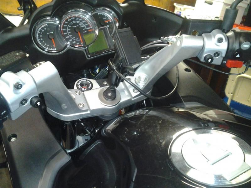

Fork tops look like the pic below, right? Small hex over bigger hex? Both the same? Small hex is the spring preload, large hex is the fork cap. Probably don't want to unscrew the big hex.

Thanks for the response. Yes, there is a small hex over the large, just like your picture.
I do notice a slight friction points along the way when rotating the adjusters, but it takes little effort to overcome. I'll try to do the wiggle when I get more resistance, but it really does feel like it's at the end of it's travel.
Just strange that the revolution gap between the legs are that significant. Also, the large hex on the right rotates along with the small, while the left does not. Is that something you're experiencing as well?

The big hex is the actual top of the fork and should remain snugly seated. The torque for the top cap is only 20Nm or ~15ft/lbs so you shouldn't over tighten it, but it should not be turning along with the small hex, which is your spring preload adjuster. If you ride with the large hex not all the way snug, it may not be holding by enough threads and may run the risk of stripping and allowing the fork to collapse.
On my bike, when new, the adjusters were all the way out. The only way they would turn is in or clockwise. Turning the counter-clockwise would unscrew the top cap on the fork. While my fork adjusters turned easy enough using a socket on a long extension to clear the handlebars, it would not surprise me if they weren't lubed properly from the factory and were hard to turn. Pushing down on the adjuster while turning may help fight the springs tendency to add friction to the adjuster threads.
According to the owner's manual, the adjuster should have about 5 total turns from max to min.

Warning, if the big nut is turning whist you are trying to adjust the front preload, you could have a big problem if the bike front end is on the ground and the big nut , fork top cap, is almost unscrewed.  The loaded spring could strip out a few threads and shoot the nut out.  Then the bike will drop down, only supported by one fork, and much pain getting it all back together.
If the fork top cap is to be removed, the fork must be unloaded, the preload adjuster backed off all the way.  Even then as you unscrew the fork cap , you must keep pressure on the cap until it is fully unscrewed.

Just back from the initial service. And both adjusters will have to be replaced.
- The right one, which has the large hex rotating with the small, is jammed. Not sure if it came that way from the factory, or if it was something I did. I think the former.
- The left one, apparently I broke the "stop", so the small hex keeps turning out.
At this point, once these get replaced, I'm not going to touch it. I followed the owners manual exactly on the adjustment procedure, and didn't feel that I've overcranked the bolts in any way (I'm generally carefull about that). I'll just deal with it. No idea why the simple instructions from the manual jazzed up the adjusters.

The fork caps are held captive by the handlebar castings. You do need to break them loose while the forks are in the clamps but they will not come out unless/until you either remove the bars or remove the forks from the clamps. Once the caps are off, it is a very good idea to lube the adjuster threads and o-rings and work them through their adjustment range a few times before re-installing them.
