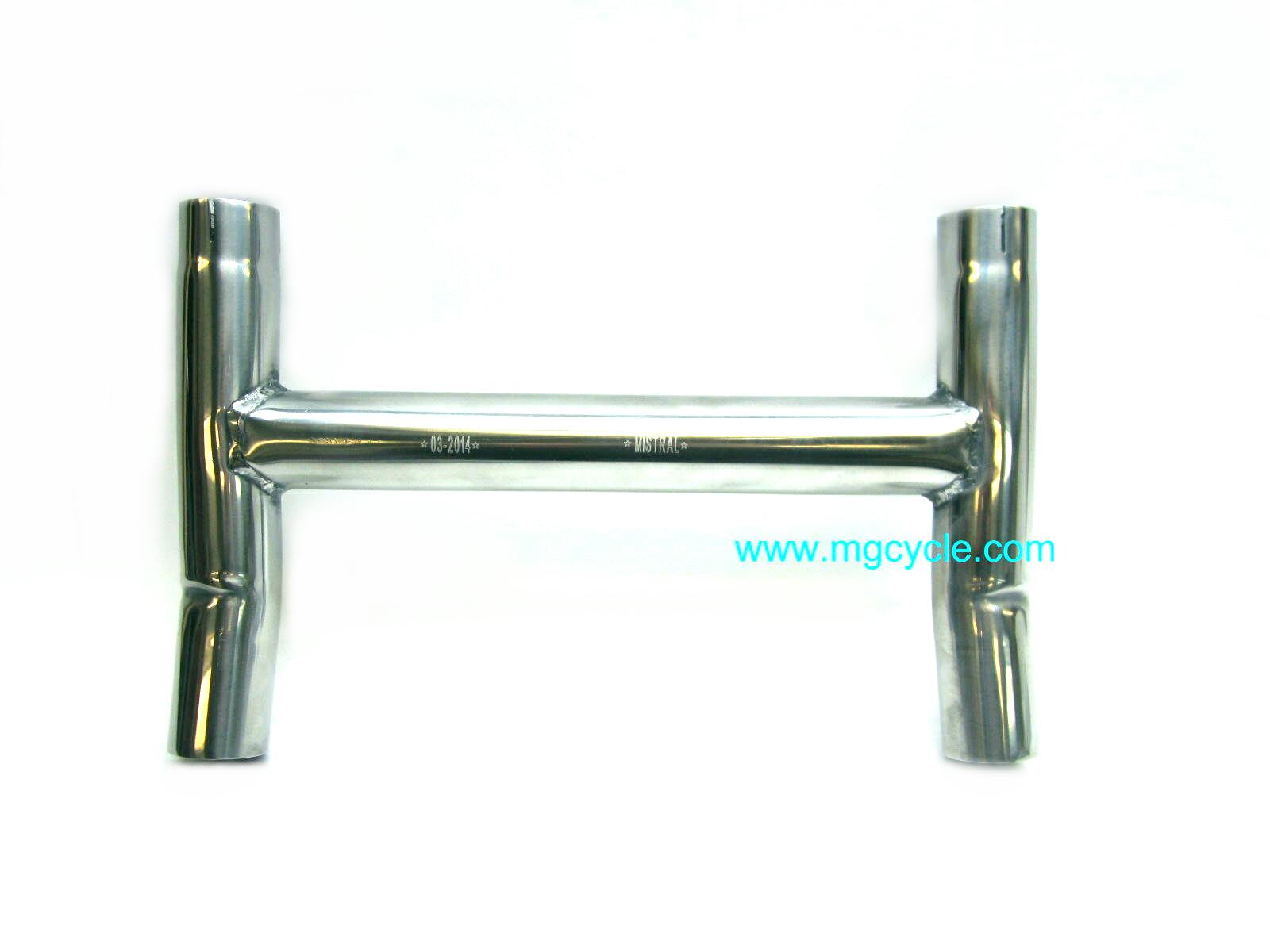

start by getting rid of the center muffler and use an H pipe crossover.  mgcycle.com
True story... I just installed a Mistral Crossover on the V11, great sound even with stock cans.
If that doesn't do it for you...
Lafranconi Competizione - the sound is wonderful.
They are a bit loud but I love the noise they make. I have also heard Mistrals on a V11 and they sound sweet too, more mellow than the LaFranconis.

Fotoguzzi offered a good suggestion.  But H-pipes are not all built the same (H-pipe, crossover, balance pipe, they're called different things in different locales).  When I bought my '98 EV (used) it had a crossover on it that was about 20mm too short and 5mm too narrow.  It made attachment and alignment very difficult.  A crossover has to have enough space between the two longitudinal pipes to keep the headers from "buzzing" against frame members.  And the length has to be adequate to allow enough "overlap" of exhaust components to prevent leaks (which can lead to popping on deceleration).
I bought a new stainless steel crossover from Keihan Systems in the U.K. (http://www.keihan.co.uk/).  I later bought a pair of "stock" mufflers from them, too.  Excellent craftsmanship and excellent sound.  Not much louder than stock.
Good luck!
Bill
Good luck!
Bill
Bill,
They seem to have good prices as well, not sure how that converts to USD.  Is there a US presence or does one pay shipping from the UK..?
I just installed the Mistral mid pipe on the V11, I have used many of these, excellent fit, stainless.

It looks to me like you already have an H-pipe.  (I do not see the stock collector.)
My EV has the Mistral H-pipe and Mistral silencers.  The sound is glorious.
