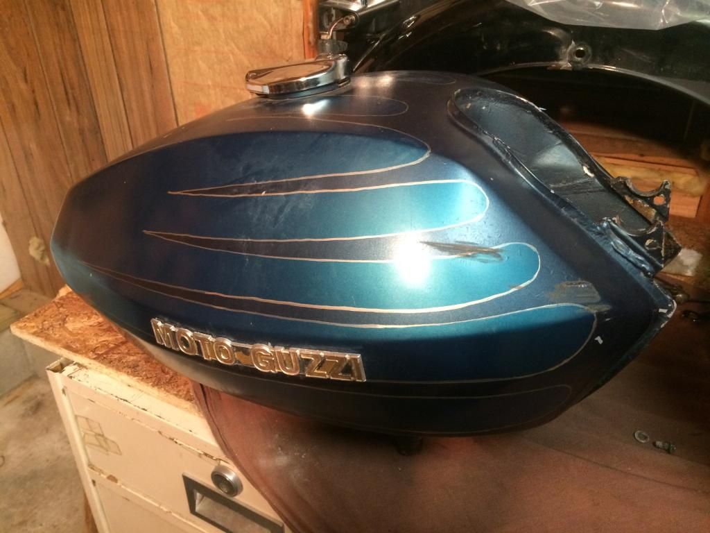

My first post...looking for some help with my 2001 Jackal conversion.

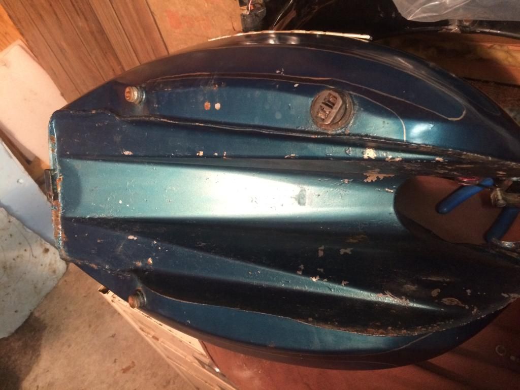

I have followed and few great Jackal/La Mans conversion threads and my learning curve is steep. First Guzzi (I've had old flat heads for years) and first project. Please have a look at this T Tank I plan on using and first tell me what it was from? also I was hoping since this tank has 3 access ports I'd like ideas about which would work best for fuel input return and sensor locations.

He is having difficulty posting pics but I believe he is trying to use a Convert gas tank and is trying to identify the plug forward of the petcock on the left.The Lemans tank I mounted on my Jackal I used the left side for the petcock and the right side for the return line.
that's for the low fuel sender.. plug it or use the wires for a low fuel light.

Still having trouble posting the photo. If it wasn't for MMNorth taking my calls  :) I'd be a little lost.
I understand the forward port in my convert tank is the low fuel sensor location....the tank still has the sensor in it....not sure if it works. I'd rather leave it in place and use it if possible...not really thinking about adapting the newer Jackal tank sensor.

The fuel sensor isn't needed.  Those two bungs in the back will work perfectly with the external pump Jackals.  I have no experience with the in-tank models.  Your convert tank should provide miles of smiles.  DW

sure, just leave it (fuel sender)  in there as a plug.. use your trip meter to not run out of gas.

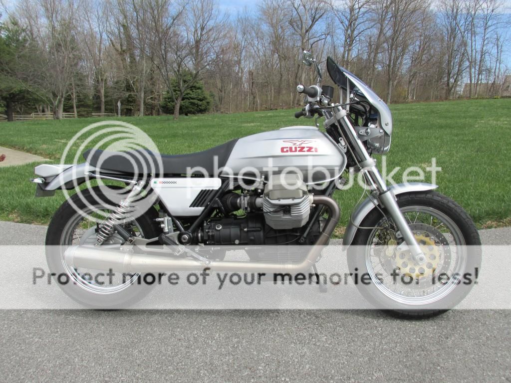

Here's mine with a SP1000 tank
Orange Guzzi
