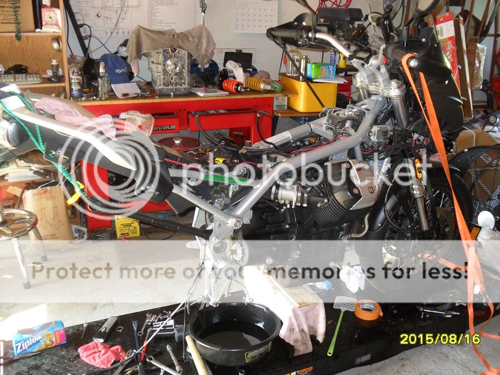

« Reply #64 on: August 16, 2015, 06:04:23 PM »
Hey Shaun, are bugs an issue? Note the fly swat. :laugh:

« Reply #66 on: August 16, 2015, 07:10:22 PM »
Yeah, like I always say, you've got to have the right tool for the job!  :laugh:  Heat warning today, and the flies have gotten a little bothersome.  Now come the mosquitoes!!
Back out to slave a little more.

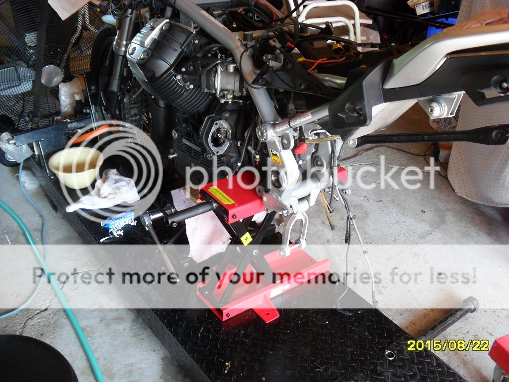

« Reply #80 on: August 22, 2015, 07:08:07 PM »
Well, back at it today, and I have everything connected to remove the engine/gearbox.  Using two scissor jacks (flat top, made for motorcycles), I am able to lower or raise the engine and gearbox to play with angles, and such.  However, I really can't see how I am going to work around the frame piece on the right side that contacts the gearbox right at the gearbox output shaft.  I know if must be possible, as others have done it, but I just can't see where I am going to get enough movement in to get around that.  Really  not a considerate design by Guzzi!
Anyone who has been here before, any tricks you can share?  I can't see how you could possibly have forgotten this piece!  :angry:
Thanks,
Shaun
'61 Galletto
'74 Eldorado Civilian
'22 V85TT Guardia D'Onore
'24 Stelvio
Vasco DG
Re: Horrors in My Bellhousing!!
« Reply #81 on: August 22, 2015, 07:36:12 PM »
So is the motive unit now 'Loose' in the frame Shaun? I found I had to lift the frame as well as lower the engine. Be aware that the plastic cover over what used to be the breather port on the timing chest is a pain in the arse to work around when putting the frame back on.
Has that bag of tools arrived yet? It was 'Gauranteed' to get to you in two days. If it still isn't there I'll have to do some shouting!

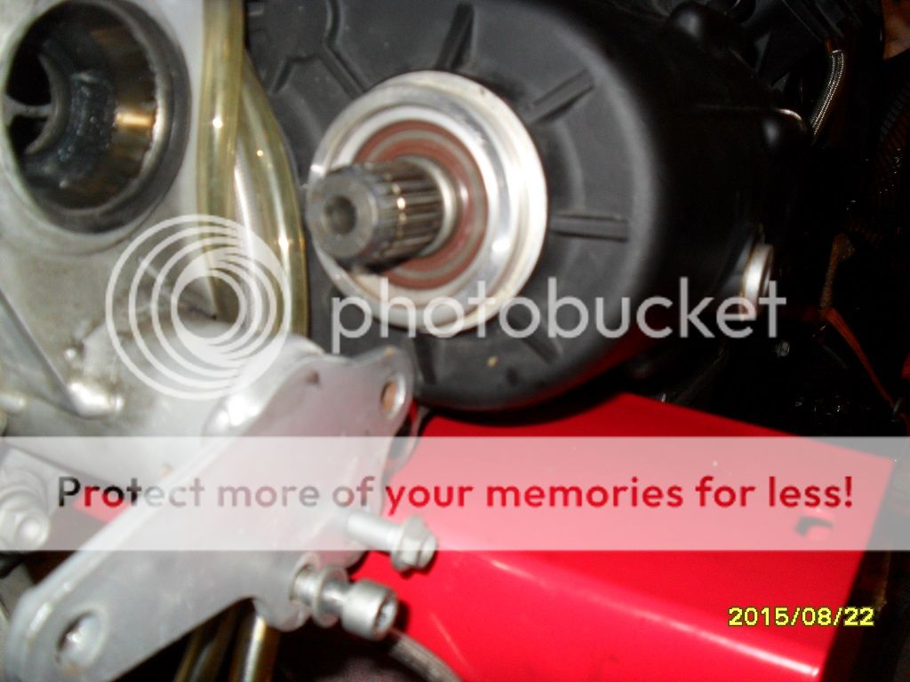

« Reply #82 on: August 22, 2015, 07:47:40 PM »
Hi, Pete.
Yes, it's now loose, with both engine and gearbox moving easily up and down.  Looks like this, at the moment:
Here is the problem area:
Unfortunately the engine and gearbox mounts constrain side-to-side movement, and fore/aft movement is limited, too:
Any thoughts on how to get around this?
No, unfortunately, the tools have not yet arrived.  Being inspected by Customs, no doubt.  Will likely arrive Monday.  I'll probably be waiting another 10 days for the clutch from Piaggio, regardless.
Thanks again for all your help.
Shaun
« Reply #83 on: August 22, 2015, 07:52:07 PM »
Jeez, it's hard to remember details like this. I'll have a look at my pics. I seem to remember I had to sort of twist it out.  Make sure all the cables for stuff like the oil pressure switch and all the alternator crap are out of the way. Neutral light switch wire needs disconnecting too and is easy to miss. Clutch slave is a right royal PITA too.
« Reply #84 on: August 22, 2015, 08:02:25 PM »
Oooo, thanks for the reminder on the neutral switch!  I couldn't locate it from the crappy little picture in the manual, and made a mental note (in invisible ink, apparently) to watch for it as soon as I started lowering the power pack.  I do have the clutch slave out of the way using a bungee cord, though.
Headed back out to see if I can find that switch!
Cheers,
Shaun

Offline smdl
  • Posts: 1345
  • Location: Courtenay, BC
« Reply #85 on: August 22, 2015, 08:25:15 PM »
Okay, found the neutral switch.  Not easy to get to, either!  Is this just a spade connector, or something I'm going to need to get a wrench on?  There is a boot covering it, and I don't want to start prying on it until I know what it is.
Oh, and I can't see how I can twist the engine or gearbox as it is constrained by the mounts until it can drop below them, and the input shaft flange seems to contact the frame before then.  The only thing that I can see working is to move it forward as much as possible.  Will keep fiddling with it.
Thanks!

Online Wayne Orwig
  • Posts: 14128
« Reply #86 on: August 22, 2015, 08:26:05 PM »
The switch is near/above the transmission output.
I believe..... the front of the motor needs to drop, then the motor goes forward.
BUT, as Pete points out, the vent cover on the left hangs on the frame keeping the front of the motor from dropping.
And the frame will hit the cylinders when you try to go forward.
It's a real pain.
I made an adjustable engine stand just for it, and it was still a pain.
Online Wayne Orwig
  • Posts: 14128
« Reply #87 on: August 22, 2015, 08:27:32 PM »
Thanks!
Shaun
Spade terminal on a post. Get the rubber boot off and it pulls right off.

Offline smdl
  • Posts: 1345
« Reply #89 on: August 22, 2015, 08:36:24 PM »
It looks like I am getting somewhere by dropping the front of the engine and moving it forward,  but it seems that what looks like a sensor on the left side of the front timing cover is fowling the frame and limiting movement.  Is that something that I should have removed?  Doesn't ring a bell from the steps in the manual.
Edit:  Looked it up in the parts manual.  It isn't a sensor -- it's a "cover".  It's item 5 in this image:
This must be the vent cover that you were referring to?
Anyone have a can opener?   :evil:
