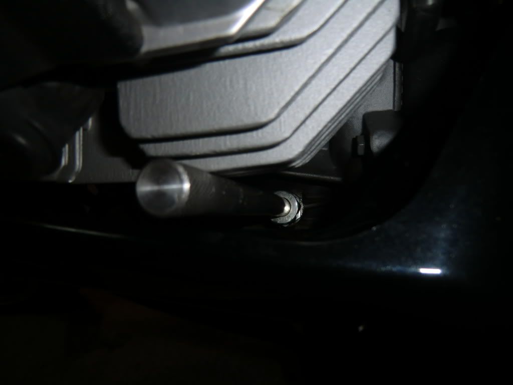

i must preface this by saying almost all of my problems are self induced.
To begin with I have very recently moved and most of my stuff is in a storage unit randomly stacked so it is a chore to find something specific.  Usually I don't try.
Getting ready for a 600 mile round trip tomorrow on the 2V Norge.  Not being able to remember when I last changed the oil (log book must be in storage) i decide it's time.  A simple job, right?
First step is searching for an oil filter I stand a chance of finding locally.  I gather a list of acceptable filters from various threads here and head to the local auto parts store.  the only one on the list they have is a WIX..  It will work, I guess.
While I am there I grab four bottles of full synth AMSoil at $17.95 a quart, and an oil collection jug..  ack..  as I walk out I recall that I don't recall seeing a filter wrench in the toolbox at the house (remember a bunch of stuff is in storage) so i head back in to the store with the WIX filter in hand and get a wrench that fits it.
Back at the ranch I drag the Norge out of the garage and muscle it up on the center stand, put the collection jug underneath as far back against the centerstand as I possibly can get it.  Then I take out the oil drain plug and watch as the oil streams right past the collection jug through the centerstand and puddles on the driveway.  Stick my hand in the stream to deflect the oil in to the jug until is slows enough to go where I want it to..  go wash hands and come back to deal with the filter.
I grab the plastic filter wrench and am only a little surprised to find that it won't fit in the filter recess on the Norge.  Looking at it and the WIX filter I notice the wrench has two sizes and the WIX filter fits the deepest flats, so I dig around and find a handy hacksaw and cut the outside half of the wrench off.  I put the remaining half of the wrench in and am happy to find that it now fits up in to the filter recess.  This is only a short relief as I also find that it doesn't fit the UFI filter that is currently on the engine.
As it is now about 7;30 PM I leave everything scattered in the driveway and dash back to a different auto parts store and get one of those three fingered adjustable filter wrenches.
Back at the bike and with much finangling and a few choice words of encouragement I am finally able to break the filter loose and turn it out by hand.  Oh yeah. oil comes off every one of the fins just to make sure I have more spots on the driveway to clean up.
Great joy as the WIX filter spins right on and the first tool I bought lets me snug it right up.
Time to add the oil.  I go grab the special funnel I got for this task and grab the dipstick to pull it out.  The dipstick is stuck so I pull harder.  No joy.  I wiggle it and pull even harder.  The dipstick handle breaks off leaving the dipstick in the big plastic adapter screwed in the engine.
A few choice words of exasperation may have offended my neighbors.
Inside the house to wash my hands and enjoy a beer then back out to the bike.
With much digging around in boxes I am able to find a handful of metric sockets and handles and my set of metric t-handle allen wrenches.  Ther eis nothing to do but strip the tupperware off the Norge to get to the stub of the dipstick.  As anyone who has wrenched on the Norge is aware, the only kind way to do this without breaking many plastic tabs is to start at the right hand panels and remove them, working around to the left until the Norge is completely nakde from the waist down.  For some reason Guido decided the left hand tuperware should be put on first and overlapped by the piece next toward the right, so that the #1 most often done job requires taking out 12 screws and six plastic panels.  Remind me to punch Guido right in the snoot if I ever see him.
I get the dipstick adapter unscrewed and yea and verily the dipstick is stuck fast in it.  With much pounding and a few more choice words I get the dipstick out.  It turns out the o-rings on the dipstick have swelled and gotten hard.
I take the orings off, remembering which was top and which was bottom, and proceed to clean the stub of the dipstick and the dipstick handle.  The dipstick was kind enough to break leaving a half inch of plastic on the dipstick with a quarter inch of metal protruding from it so I decide that with a ride tomorrow this is a good opportunity to see if superglue really works.  I hose down the plastic bits with carb cleaner to get all the oil off and glue the handle back on the dipstick.  i'll let you know how that worked after the ride.
As long as I have the body parts off and the adapter out of the engine leaving a nice big hole this sounds like a great time to put the oil in.  Oh wait..  without a dipstick I better measure.  With some internet searching and a little calculator work I determine the Norge needs 3600 cubic centimeters of oil for a filter change, which works out to 3.8 quarts.
i put the oil in, but I don't want to put the dipstick back in until the superglue has fully cured.  Visions of permanently inserted dipsticks dance in my head.  i go ahead and start the engine to check for leaks and while there are no leaks there is significant blowby coming out the dipstick hole spraying a perfect fan of oil droplets over everything.  Shut off the engine and wipe everything down.
I get the repaired dipstick and it is a little tacky still, but seems well stuck and the handle doesn't pull off.  The dipstick slides in to the adapter nicely without the orings, so I cover the broken bits liberally with axle grease to seal the superglue.
guessing I am not going to have a lot of luck finding itty bitty orings (the hardware store is closed by now) I put the orings back on the dipstick in reverse order, and coat them with grease, and the dipstick slides in to the adapter fine until it hits the hardest oring.  Good enough.
I grab the dipstick adapter and a 1" socket and go to put it back in the engine only to find that the plastic threads are all munged up.  Guido must have put it in crooked the first time.  Remind me to sock him in the eye after I punch him in the nose for the tupperware layout.
Get out my hand pocket knife and chase the plastic threads on the adapter and get it threaded back in to the engine and fire it up.
No leaks!!  Hurrah!  Quick 25 mile test ride and everything is dry and no drips on the driveway.  I think I am good to go for tomorrow.
Next on my list of things to do is to order a new dipstick and adapter.
Is there a new and improved dipstick for the 2V Norge?

As far as I know, the dipstick is still the same - and my current one has some 80,000 miles on it (after the first broke at 20,000). I take care to re-lubricate it each time I check the oil or remove it for any other reason, and I also take care to pull it out in a straight, true line using a hooked tool (or the end of a mangled coat-hanger), unless I'm on the road.
I use a metal rather than plastic oil cap-wrench, and I use the Mobil1 M1-102 filter, which is readily available from many different auto stores. I like it better than the WIX, which is one of two others often available without access to motorcycle stores. The final readily available one (Pep Boys nationwide) is a PureOne - they show two possible equivalents to the M1-102, but use the bigger one - the smaller one's ring seal is not big enough for the seat on the spin-on on the Guzzi.
When you order a new dipstick, the order is usually for an assembly (one common part number) that includes a new screw-in mount for the dipstick - so everything will be fresh. Check with the dealer when you order.
BTW, if you can't get one quickly, let me know and I'll see if I can dig my spare out - you can replace it for me when you get yours. August is, after all, the EU vacation month...
