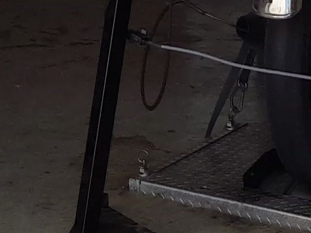

Ok, here's mixture at 4500 on the left cylinder
Rats.. Photobucket is screwing up again.. it will only show one of 4 printouts for what ever reason.  :rolleyes:

Interesting Chuck.  Still trying to bring up that video for viewing; won't load up for me.  Anyhow, yep, we're pretty close in numbers and you see how differently your ass dyno feels it.  What is the torque you're pulling?  Interesting to compare that.  Amazing you were close to perfect on the jetting out of the gate.
No torque reading.  It has some.  :smiley: I was looking for mixture.

Can't see your video (or mine). Must be because I have flash disabled. Yeah, it *was* fun stuff to do. I must have looked harmless enough because the dyno operator bent the rules and let me be in the dyno room.  :smiley: Both guys really seemed to like the Lario, and the story behind it.
I wouldn't have done it except I was wondering whether I should go to the 268 AB instead of the AR atomizer to fatten up the mid range, and was wondering about whether the 130 mains might be a little small. Apparently no changes necessary.  :thumb: Got my $37.50 worth.  :smiley: (Guzzi content)  Max hp was never on the radar when I built this, I was looking for reliability in my touring bike after the problems with the 4 valve. When it turned out that it is every bit as much fun as the stock engine..and more powerful.. it was just icing on the cake.  :smiley:
