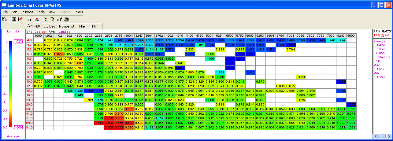

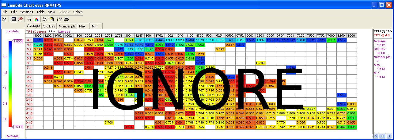

Post roller logging run. It was running a bit rich.  :rolleyes:
Right. Ignore this log. Found a error in the conversion during logging. Proper data log in new post.
« Last Edit: September 11, 2015, 01:48:12 AM by beetle »
Wow! Assuming it was running well before the conversion, the rollers have made a huge difference! Some of those numbers even look border line combustible!

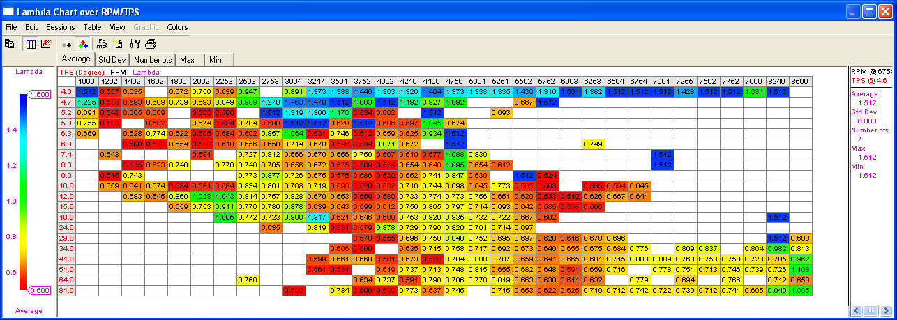

After I found a conversion error in my logging setup, I did another run today. Note the difference! This is with the same map I ran post roller conversion. Pete, I'm sorry to say your brickwall doesn't exist. No idea what you experienced, but I  experienced no such phenomena, and the (proper) log shows no funnies. It needs a bee's dick more fuel in certain areas, but you could run this map without issue.
That looks much more plausible. I think petrol/air won't even ignite at some of the Lambda numbers in the earlier log you showed.
As Paul also asked, did you feel absolutely no difference pre/post conversion?
With my Stelvio there was, just a bit, and it needed some adjustments.
This is basically what I ended up with, Left and Right - although I did make a couple of small adjustments subsequent to this log. (I find it takes a minute to get your head around looking at a map with columns and lines reversed  :grin:. And my numbers are in AFR, not Lambda)
