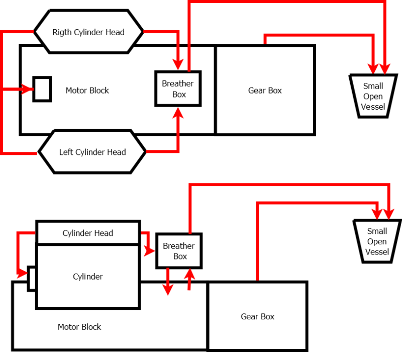

Option 1
I have also seen systems routed like this:
Option 2
I have made small test print to show the layout of the unit. However before I deside where to but the connections should be placed - it would be nice to have clear picture of how the flow is in the system.
https://www.dropbox.com/s/6lmgr2yavm1edq3/20160121_205328.jpg?dl=0&preview=20160121_205328.jpg
The unit will be filled with demister pads to help condense/separate the oil mist.
So I need you help ?
 - How does the gas/oil mist flow through the breather box and how should it flow?
 - Where is the highest pressure in the system
       A) Cylinder head ?
       B) Front of engine ?
       C) Breather outlet from crank ?
       D) Drain return to engine
       E) Gearbox breather (not so relevant)
BR StubkierDK

Thinly disguised bump because I don't know. I *do* know that because of the split crankcase in the small block there is a lot of oil pumped through the heads and breather system. You'll need a return to the crankcase from the breather.
Offline jacksonracingcomau
  • Posts: 2393
Re: 3D printed breather box
« Reply #2 on: January 21, 2016, 08:04:01 PM »
Not sure about any of drawings but system works as is, best way to remove "clutter" is blank off rocker breathers, crimp / weld ends on breather or fit small hose connecting them.
Then it's like originally intended in 1967, rocker breathers were an answer to problem that never existed.
Do use (clear) catch tank, it is instant way of seeing any accumulated oil, if open a few ounces of oil on engine/exhaust or ground looks like a major problem.
A full catch tank is.
But be sure to have gearbox breather at top of tank otherwise any engine oil in tank will syphon into gearbox, leak will show at rear drive box (ask me how I know)
So in short, replicate exactly what you have but without rocker breathers, simple , big hose with PCV breaths, small hose returns the condensate under the oil level

And I am currently trying to figure out if the rocker breathers allows oil to flow in or out of the rocker cover ?
The idea at time was more venting for cases
square engines got weirder, was drain(under head) for frame breather but u bend was mayo trap, system failure when this happens
On roundies & early square the drain behind clutch is all you need, without this an external drain a la 1100Sp will work well
Don't reinvent the wheel, just copy what you have without rocker breather (or leave it alone - it works)
 I've seen more breather systems  ruined by "tuners" than ever seen any improvement, what exactly are you trying to gain ?
Work on wiring instead, tons of crap to clean up there + you'll make it better not worse.
Or suspension or brakes, plenty or room to improve without changing bits that work.
Ago made a "hidden" under tank big breather box, I used to run one, works as well as the OE one but with longer hoses to perish.
Copy that if you like long rubber hoses with formed bends in them but buy spares, you'll need them.

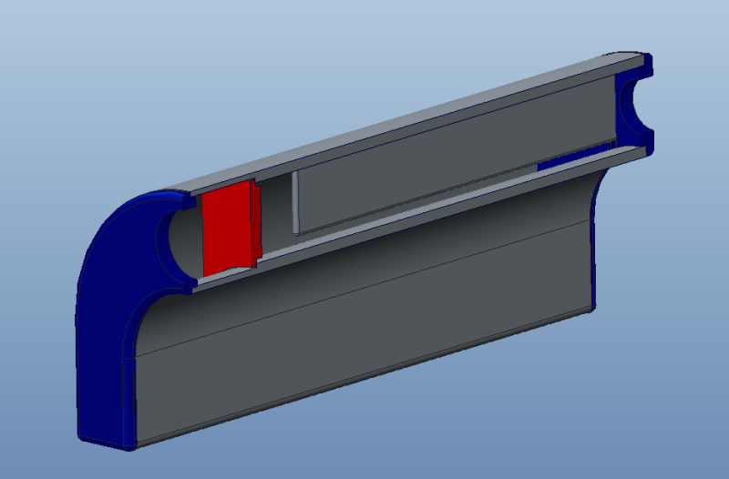

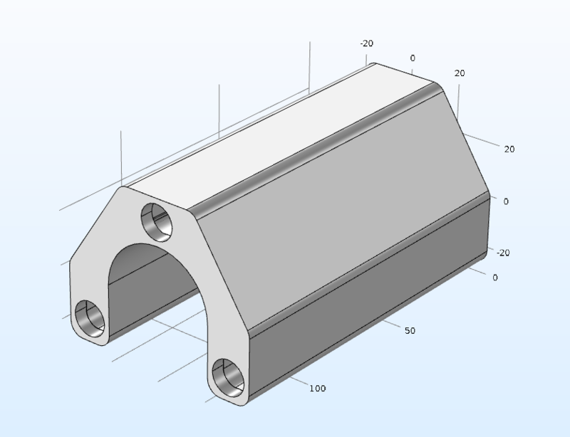

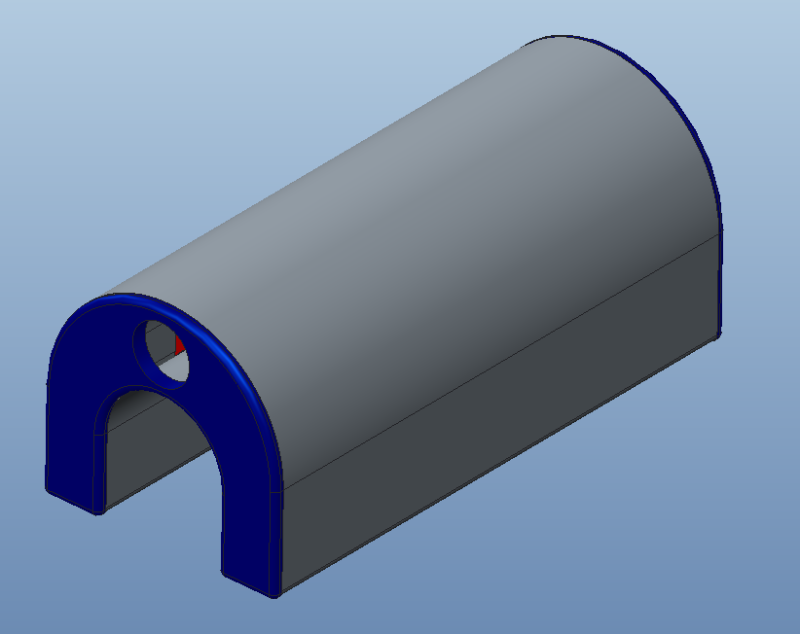

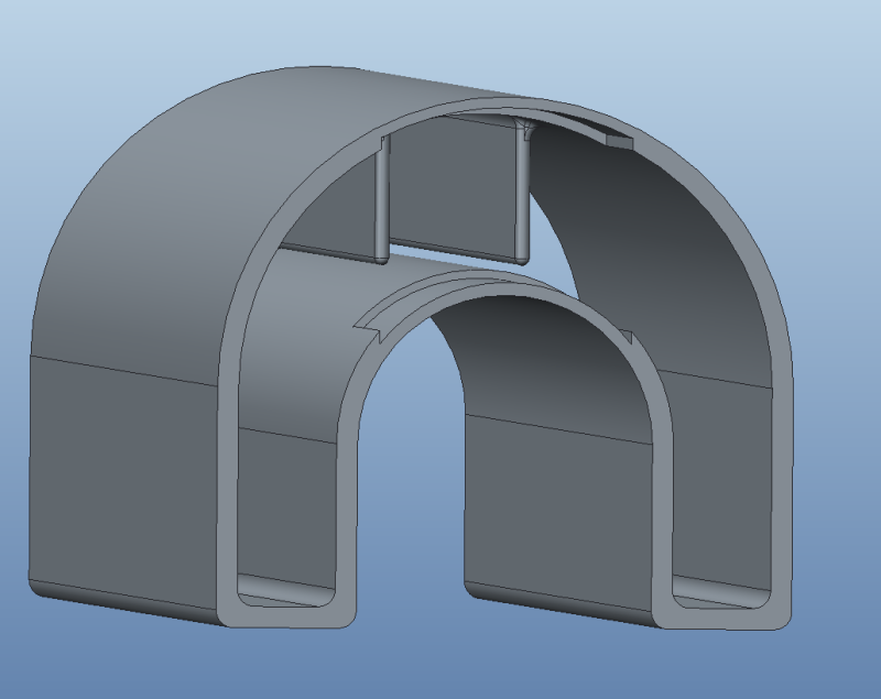

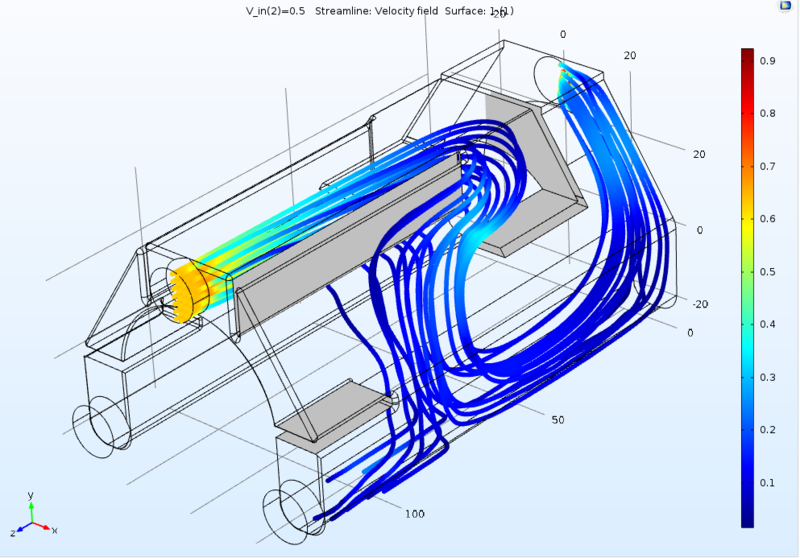

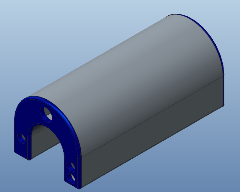

Made som preliminary design suggestions. The main focus have been the outlet to the atmosphere and the inlet for the main breather hose.
The vessel is intetned to be mounted under the tank on the frame. The port seen here is the outlet to the atmosphere. A pipe connection or mount for a small filter will be added.
This is the other end of the tank. The large port is for the breather inlet. This end of the tank is placed at the lowest end - so condensed oil will collect at the bottom. I am still in doubt if where the rocker cover breather should be connected. However the small drain at the lowest point will return the oil to the crank.
More pictures:
The workstation is currently running af CFD simulation, just for fun, to se how the air flows through the unit. And the 3D printer is working on the first prototype. Hope that it will done by Monday.
BR StubkierDK

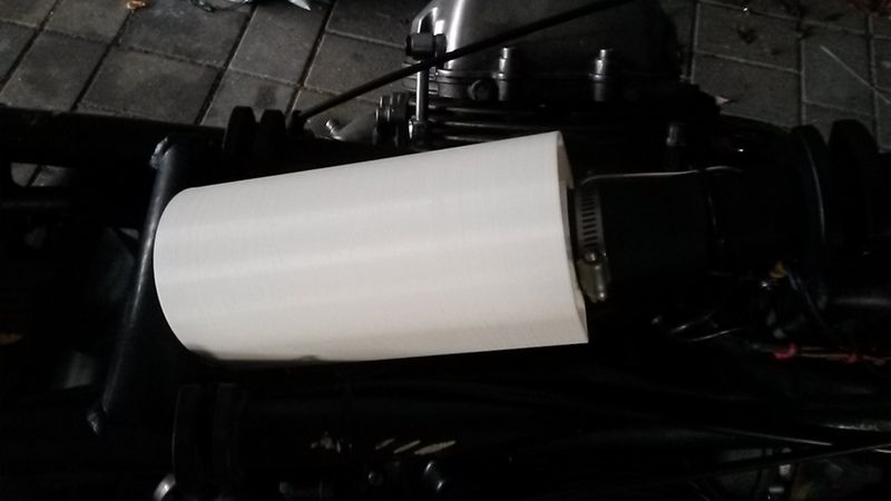

First prototype printed and test fitted:
It is still missing the end covers. However I need to make a new tank as it is just 1-2 mm to wide and tall to fit between the tank and frame.
Moto Guzzi 850 T3 @ 1978

Are on the 3rd version of the tank. Now it fits snugly under the tank. In addition I have done a small (and basic) cfd simulation of the tank. It is just to ensure that the flow and drain zones are in the right places.
I have the first version of the tank submerged in old gear oil - and after 3 days there is no changes and the oil can be wiped completely off. Plan to leave it there for a total of 14 days to be 100% sure that the oil does not change over time.
The printet surface is treated with the "acetone method"
