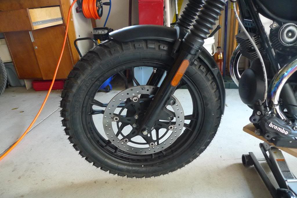

I put K60's on my V7.
Front tire was too big and I had to raise the front fender to get it to fit.  Didn't like the handling changes to the bike, it made the front end feel heavy and slow to respond, the rear tire was fine if a bit noisy.  I also ran Kenda K761's that were a better fit if not as dirt worthy.

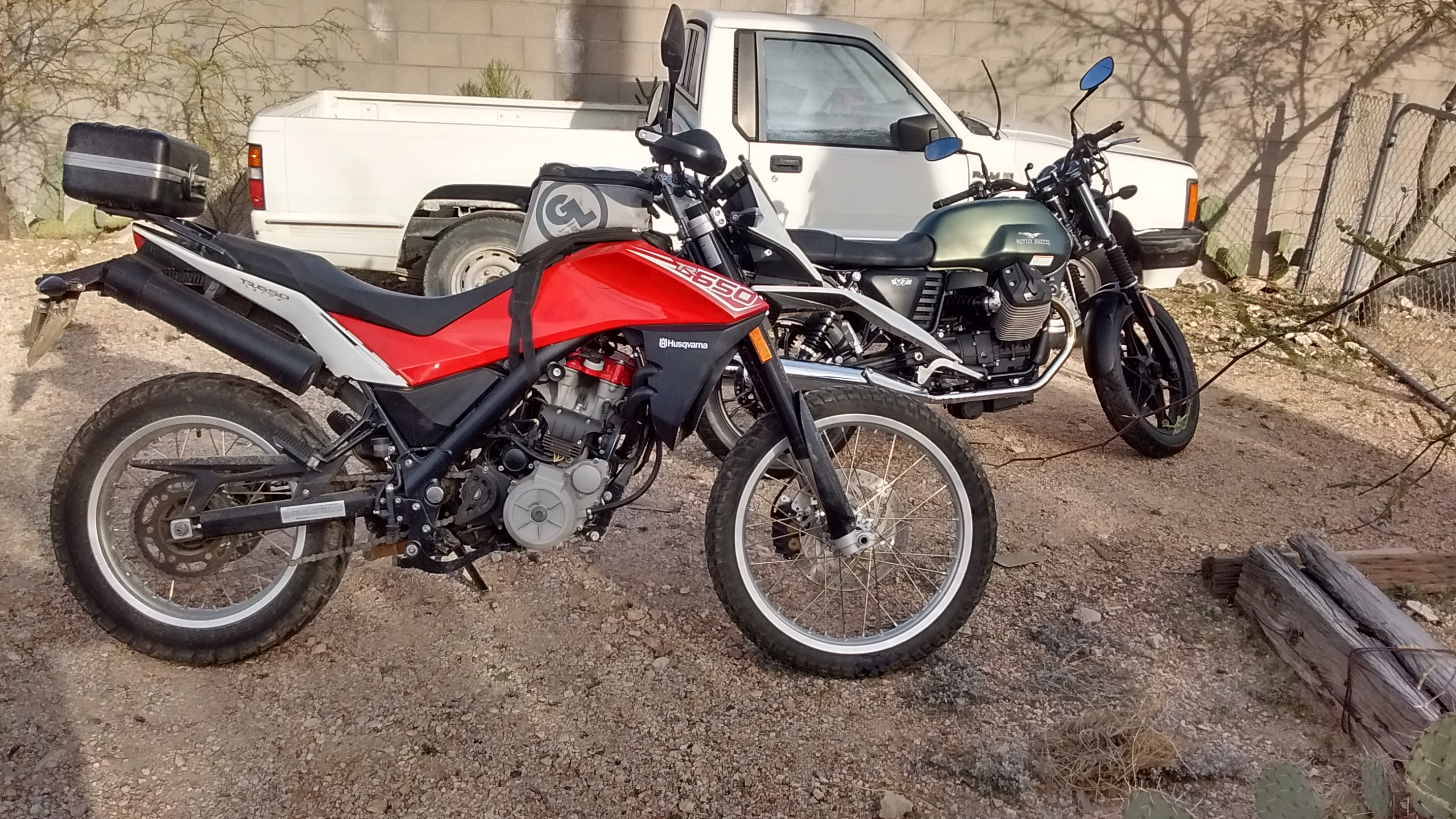

The 244 gets lots of great reviews. I bought one for the front of my TR650, just haven't installed it yet. Want to wear the Metzlers down a bit, although I do not like the metzlers all that much.
I do have a bike that is supposed to be for what I am trying to do, explore, but the thing is too tall, and I have lowered it already. I cannot plant my feet and that sucks. This V7 feels good, even with the slicks on it. That and it's shaft drive. I am so sick and tired of dirty nasty chains and maintenance.
Here are the two bikes.
That's bad to the bone, is that the 110/80 18?

« Reply #16 on: January 30, 2016, 10:43:30 PM »
And how did you raise the fender?

« Reply #28 on: February 02, 2016, 02:59:55 PM »
Don't see that tire size listed under the tubeless style, this is a 120/90-18 so a big tire as I said.  Fender was raised by putting black spacers between the fender and its mounting plate and using longer screws.  Take a close look at the back of the fender, raising it up does not give much clearance back there, I figure you'd have to tile the fender in addition to raising it.
