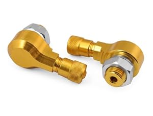

30+ years of riding and fighting straight valve stems.  Recently I thought about upgrading to angled valve stems.  But, I just found some of these on fleabay.  They were $10 a piece and well worth it to me.  There are some cheaper Chinese counterparts on there, but I didn't want to wait too long for them and I've had bad luck returning junk from China (no international war declaration intended here, so don't).
I hope they work good.  Supposed to be no modification, straight forward installation.

Peter, These aren't stems.  They're adapters for the existing straight stems.  I hope they work as good  :laugh:

Browsing thru a BMW dealership last weekend, noticed that the valve stems stick straight out from a wheel spoke. No longer on the rim itself.  Very clever, simplifies things greatly.

Those have been around for years. I've never used them because they look like a lot of hardware on the stem to me. Also, you must have them on tight or they will rotate on you.
Hope it works for you, though.

Make 100% certain that they seal. It could be a leak source and a flat tire. I had that happen to me with those screw on little tire gauges that are supposed to help identify a low tire pressure. Well duh, they CAUSED the low tire pressure.

I use them.  They will change your wheel balance.  My method is to balance with the stem turned in-line with the wheel rotation.  I loosen the extension and turn it 90ยบ to use it and then return it to it's inline position.  fwiw I bought mine at a truck stop.  They look identical and cost $10/pr back when continental K112's were the hot ticket.

I always assumed that they weren't meant to be left on all of the time, but installed only when needed. In any case, that's how I use mine.
Hmmmm.  Then there's that way.   :cheesy:
I got mine because the straight valves were too difficult to access without gloves and impossible with gloves.  On my 16" lester rear wheel it was the only way to get most air chucks connected.  Rather than dealing with glove removal and extender installation every time I wanted to check tire pressure it made sense to me to install them permanently and compensate for balance.  My tubeless rims get kurvygirl's right angle valves.

Does the rotation of the stem in line or otherwise make a difference to the wheel balance ?
  • Posts: 21219
Re: Angled valve stem adapters..
« Reply #14 on: March 25, 2016, 12:52:18 AM »
Dunno.  But in the absence of knowing I decided to balance the wheels with the valve extenders in their intended travelling positions.  That way it didn't matter.   :boozing:

These and many similar are fitted to modern bikes especially on the front wheels where the discs are so large that a straight valve just wouldn't work
They can be retro installed to older bikes but be careful some older wheels have an insufficient flat area on the wheel to allow them to seat properly and they can leak............... ......Don't ask how I know. The tire also needs to be removed to install.
With the adapter types I only install them when I need to check pressures and remove when I'm finished as Antietam does.
On the bike, on the move, they could rotate affecting balance and introduce another point for leakages

Sudden tire deflation can occur when the centrifugal forces of the spinning tire cause the stem to deflect slightly. The cap end will be forced towards the rim. Honda "discovered" this after several "incidents" on the wing/barge. This led to the addition of that little stem support plastic thingy. Of course, I wonder about the forces acting on the stem valve for the straight type. At what point does the force overcome the spring? From there, only the stem cap keeps the air in. Soooo, make sure your caps have the seal in them. I have first hand experience on THAT one.

If you look at the Kurveygirl site you'll see that there really are only 2 sizes of these things, 11.3mm and 8.3mm.
Most of the European bikes appear to take the smaller size while most of the Japanese bikes take the larger.

I have a pair of lesters where the front is the 8mm/2.15x18 and the rear is 13mm/3.25"x16.  The books and wags all tell me it never happened, but they're holding the bike up right now.

As above, I like the 45s best when available and short.
I have learned the failings of too much leverage from these adaptors when trying to make the seal and limit pressure on the stem at the same time.
I bought a set from Stop n' Go a while back and that's exactly what the instructions say. They're not for road use. You put them on only when you air up the tires. My experience was that they easily lose 4 - 5 lbs when you try to take them off so they're kind of useless. Wait until it's time to replace tires then put a permanent set of 90 deg. stems on.

If it's that easy to install and remove the extenders (quickly -- without losing any air) they're probably not needed.
In my opinion it's completely counterproductive to remove and install extenders every time you check air -- which should be before every ride.  We use them because accessing the valves is a royal pain.  You're doing  3x the fiddling + gloves if you remove them every time.  That = a greater reluctance to do your diligence.  Leaving them installed = convenience and encourages proper tire care.  If you balance the wheel with the extender attached it's weight should have no effect.
And the instructions say to not leave them installed?   These extenders are designed for the inner wheels of dualies where it's physically impossible to access the valve without the extender.  Maybe one of our truckers will tell us how these work in the real world.

I installed them a few days ago.  Preliminarily as a permanent option.  Centrifugal force will have them resting against a spoke anyways so I don't see how they can back off. I may be wrong though, I've been wrong before. I'll be sure and check on them after an extended ride of course, but so far after 3 days they have lost no air at all.  They look and feel very nicely made.
I will probably definitely go to the permanent 90 when I get new tires mounted though. Never understood this straight stem setup that is impossible to reach.

I bought and use mine only for when I have to air up on the road and am faced with a air chuck like this:
Can't squeeze that in past the big ol' drums or even the discs on some of my bikes. At home I have this type and it's no problem:
