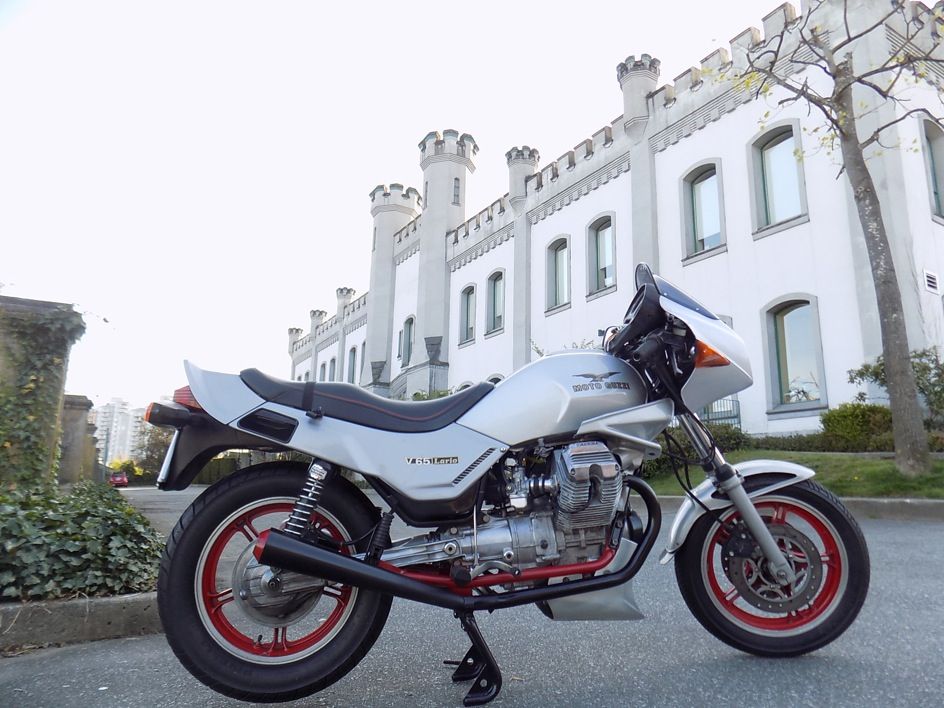

« Reply #27 on: April 11, 2016, 02:37:06 AM »
Look what followed me home, an 86 Lario with only 40,000 km on the clock and well kept IMHO, what do you think?
Mostly original paint, I'm sure the mufflers aren't original they sure sound good though.
Came with fairly decent tires, a new battery and brake overhaul.
I discussed the rear drive mods with the owner, he didn't know if they had been done, to be fair I think old English iron is more his thing,
would this have been done in the factory by 86?
BTW that's the BC Pen gatehouse in the background, I live just behind LOL
Better than residing here at least.
I had to fix one of the funky front indicators, the contacts make cheap Chinese look good, may be Lucas like the starter.
I will graft in some decent lamp holders, soldered the bulb in place for now.
Will add a decent pair of Italian Fiamm Freeway Blaster Horns to replace the little squeaker it has now.
As soon as I can I will measure the valve lash, at what mileage do they start coming apart?
First impression, it feels like a fun bike.
Please tell me all about my new girlfriend, I know nothing about these creatures.
« Last Edit: April 11, 2016, 03:33:13 AM by Kiwi_Roy »

Welcome to the world of smallblocks Roy! :thumb:

Roy, *that* is a great looking Lario. I love the silver ones.
 You have the euro front turn signals, which are like Pete says, "rocking horse shit." I'll gladly trade your POS turn signals for mine.  :evil: :smiley: No need to thank me.
The bike certainly appears to be original and in wonderful condition.
No. It was first done in 87.
Around 6000 miles. (10 K) Some have made it over 20000, with strict observation of a 7K rpm rev limit. The problem is, power is still going up at that point, and past the 7800 red line. That's where the fun is.  :smiley: Compared to the 2V small block, they are lacking in bottom end torque, but really come alive above 5K rpm. They are just a hoot to operate.
Kev dawg will be along shortly to tell you the problem can be cured by throwing thousands of dollars (!!) at the heads. I, personally, don't believe it. Megacycle used to make cams with extra lubrication holes for them, but quit because their cam lobes got wiped off, too.
Mine had 19000 miles on it when I got it, and when I tore it down, it showed signs of having dropped valves at least twice at that point.
It's a shame about the valve problem, because it is one of the most fun bikes Guzzi has ever built.
