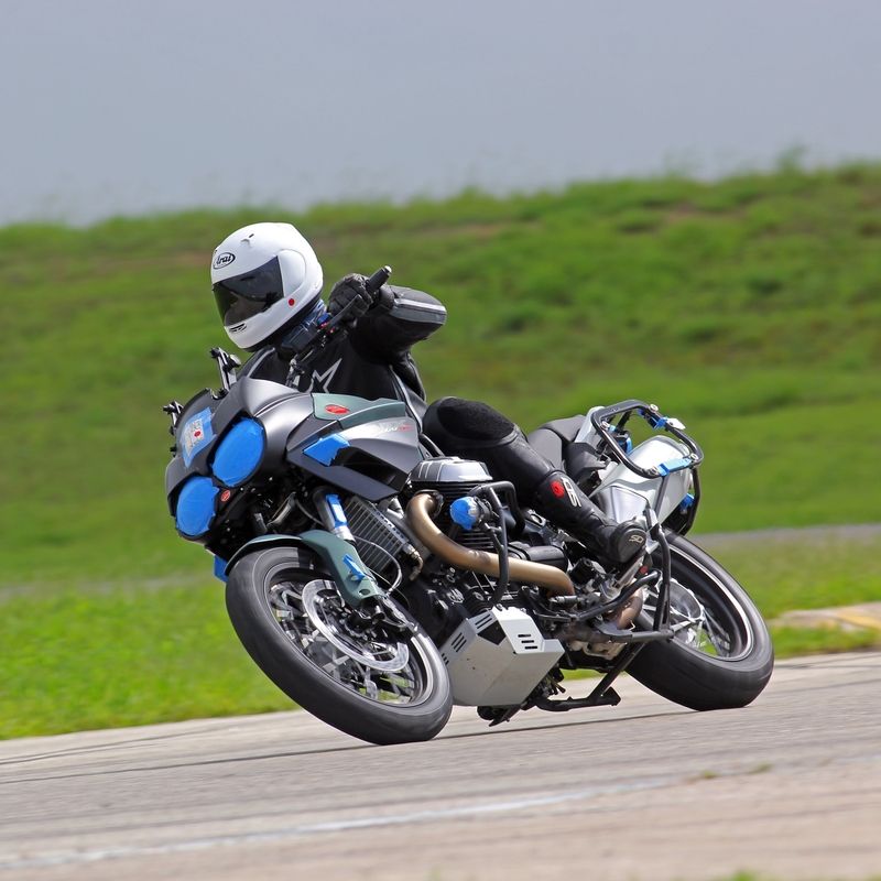

Offline toma nova
  • Posts: 323
  • Location: Houston, USA
Re: Breva Sport handlebar and peg mods.
« Reply #11 on: August 17, 2016, 07:42:32 PM »
Not sure I'd want anything as chunky as Goldwing pegs, but I'll have to take a look next time I'm near a Honda shop. I assume you're referring to the GL1800?
Here they are, not at all chunky.
Also in track use, plenty of clearance.
2014 Stelvio NTX
2008 1200 Sport - sold
